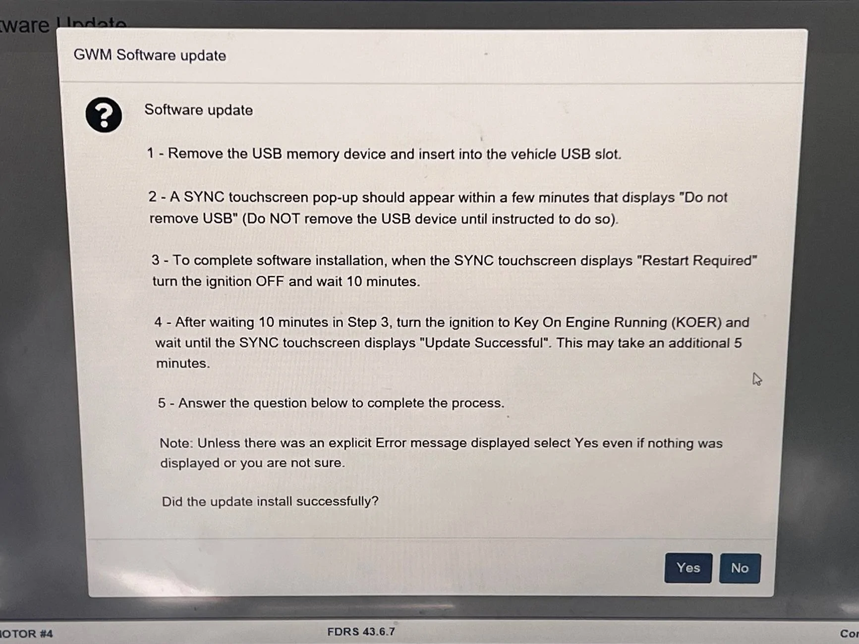

I’m sitting in my truck with the USB inserted waiting for a pop-up or some indication that the GWM update is happening. I formatted to exFat and think I’ve followed the process exactly. It’s been about 15 minutes with no indication that it’s recognized the USB. The truck is on and I have 15v. So now I have questions:
- Is there something I can do to determine if it’s working?
- How long do I wait?
- What’s my next step?
Thanks for any guidance you can give.
When you inserted the USB, did you see "USB indexing" on the top left and then a message on your touchscreen saying "Do not remove USB blah blah blah"?
