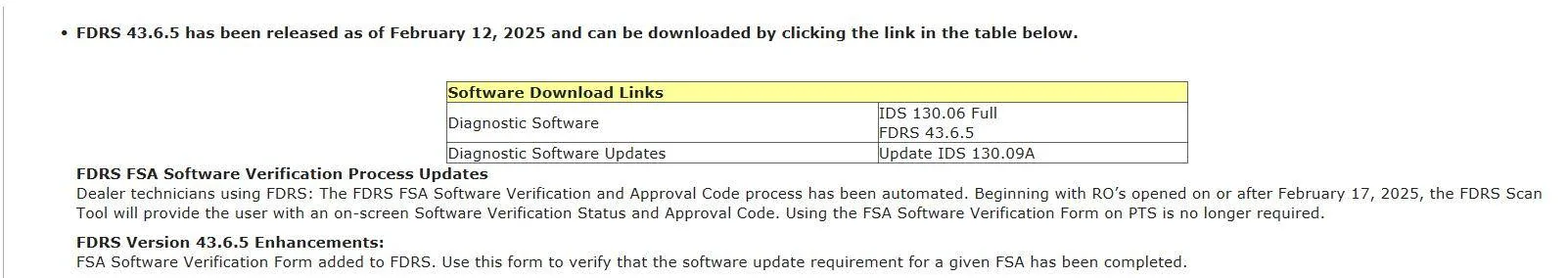

FDRS got a minor update yesterday from 43.6.3 to 43.6.5.
Here's the link to download the update. It's a minor update so no need to "Remove User Data" during the setup.
This update added a form that dealer techs need to fill out to prove that they did the software updates that whatever FSA they were working on said they needed to do. An anti-shenanigan verification procedure.
Ford F-150 Lightning Lightning Software Updates using FDRS FDRS_43-6-5_Release_Note_13_Feb-25

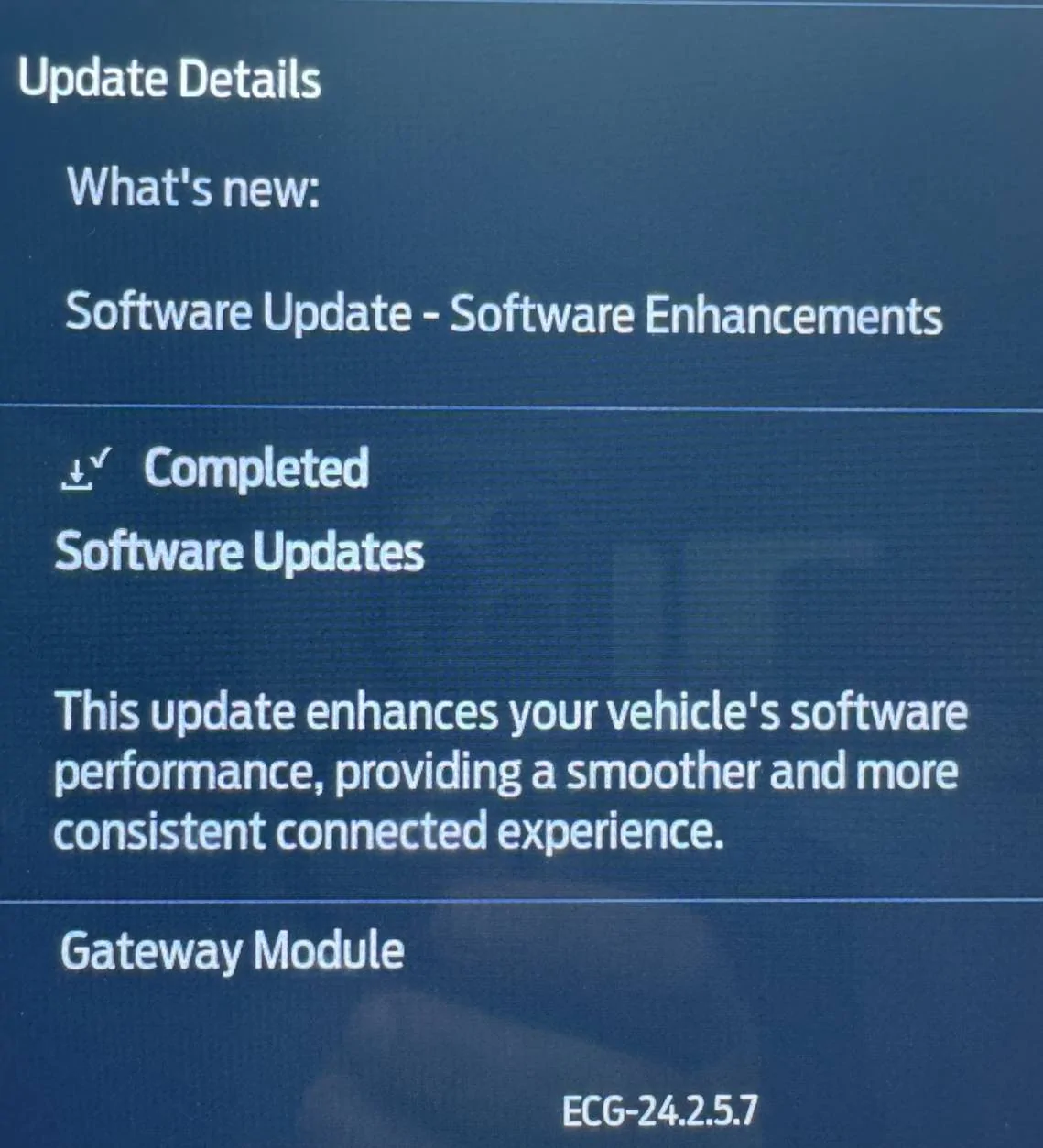

I just got the GWM update as ECG-24.2.5.7 OTA.
These are the OTA notes for that update on your '23 model.
This update enhances your vehicle's software performance, providing a smoother and more consistent connected experience.
ECG-24.2.5.7
My '22 model has a different revision of the gateway software than what you got via OTA.
I'd like to compare what I did in FDRS with a '22 model that gets this as an OTA to see if it matches.
ECG-24.2.5.7
That's it, except it also explicitly calls out the Gateway Module, so that's how I know what it is, lol! I haven't seen 24.2.5.7 anywhere else so might be EAP.

Just received OTA ECG-24.2.5.7 few mins ago.
Ford F-150 Lightning Lightning Software Updates using FDRS IMG_7291
It is EAP.
