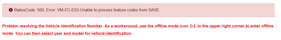

It appears that the Ford servers are having issues this morning, cannot recognize my VIN. Anyone else try today and can report back?
here is the error code upon checking
That's what I had. Reboot your laptop and see if it works then... it may have been coincidental but I'm up and running now.

Didn't let me in initially, waited 10 minutes and it looks like it is working again.
You'd think Ford would have displayed a message when first starting FDRS... SMDH. I hope it's stable since I'm helping another member add a keypad to his Ranger this morning...
