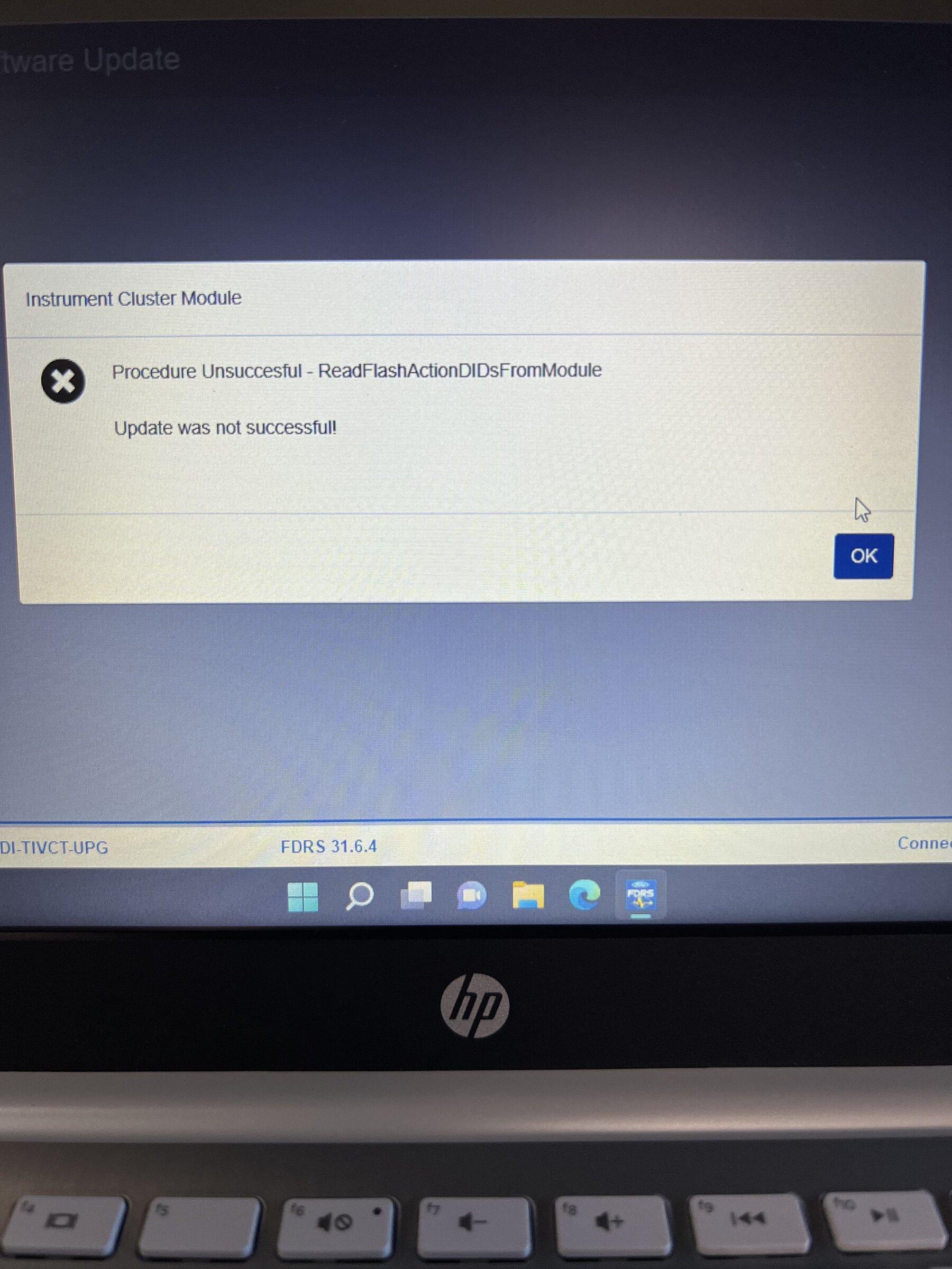

This is what I got with attempted IPC update. Tried twice.
What happens when you hit OK? Does it give you the option to update via CAN bus? How’s your vehicle voltage? Are you maintaining around 12.5V or better?
When I click ok it goes back to the FDRS screen showing the update is still available. The update via USB part 1 is successful, this second part is the not successful part.
Watching voltage on battery maintainer and all seems fine above 12.5 consistently.
Didn't see an option to update via CAN.
jmm3807
Mar 3, 2022
Phoenix AZ
www.seasavvyaquarium.com
2021 F-150 Platinum 4x4
Business Owner
Got past that. Appears it updated correctly now and has APIM available after that.
JEB
Aug 15, 2021
576
393
Northern Illinois
2021 F-150 Lariat Powerboost
Good. But you might not be quite done yet. After you finish up with the APIM and you’re good there, start the truck up, maybe drive it around the block. Then check to see if the IPC is throwing a DTC. I suspect it will because of the error message. If it does, run the PMI for the IPC. You’ll find it in the toolbox if you select the IPC. That will complete the configuration and the DTC should clear.
