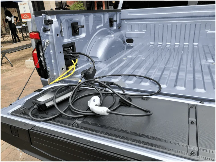

Ford displays using the Lightning NEMA L14-30, 30 amp 240 volt outlet to charge a MME with the Ford Mobile Power Cord. Is this irresponsible on Ford's part?
It would be nice if Ford would offer the ability to control the maximum current draw with the Mobile Power Charger. I scoured the owners manual and checked the MME forums and did not find any ability to control the amperage draw.

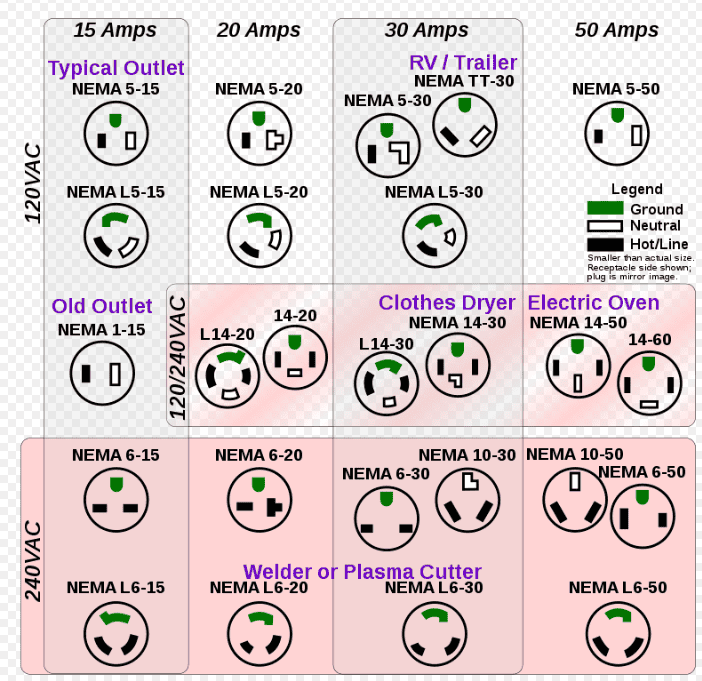

I have been trying to figure out what other electric outlet adaptors I should acquire. If 30 amps is really a problem then apparently the NEMA 6-50 would be the only 240 V alternative.
Ford F-150 Lightning Extension Cord “Charge Kit” 1652123298893
That's a good point. I saw that picture but it didn't occur to me that they'd plugged a 14-50 into an L14-30. It's a good demo, but technically the MME should attempt to negotiate a 32A charge when using the mobile connector. That not only exceeds the 80% rating of the circuit, it should trip the breaker on the truck.
Controls for limiting max amps should also be on all vehicles if you asked me. Maximum amps would be regulated by the EVSE, but you should always be able to step down. The Tesla UMC adapters have resistors of various values to indicate to the connector what kind of plug is installed. The UMC then relays to the vehicle what the maximum is. This is like when you pull into a public L2 station - you don't risk drawing too many amps as the EVSE sets the limit. Sometimes that limit is 80A, but I've seen as low as 24A.
There is no ability to control the Ford Mobile Charger’s amperage, no. Its plug is 14-50.
I used it at a campground, they had 14-50 outlets at the site. I believe these are widespread at campgrounds.
If dryer outlets are 14-50, they should have a 50 amp breaker and the proper sized wire.
