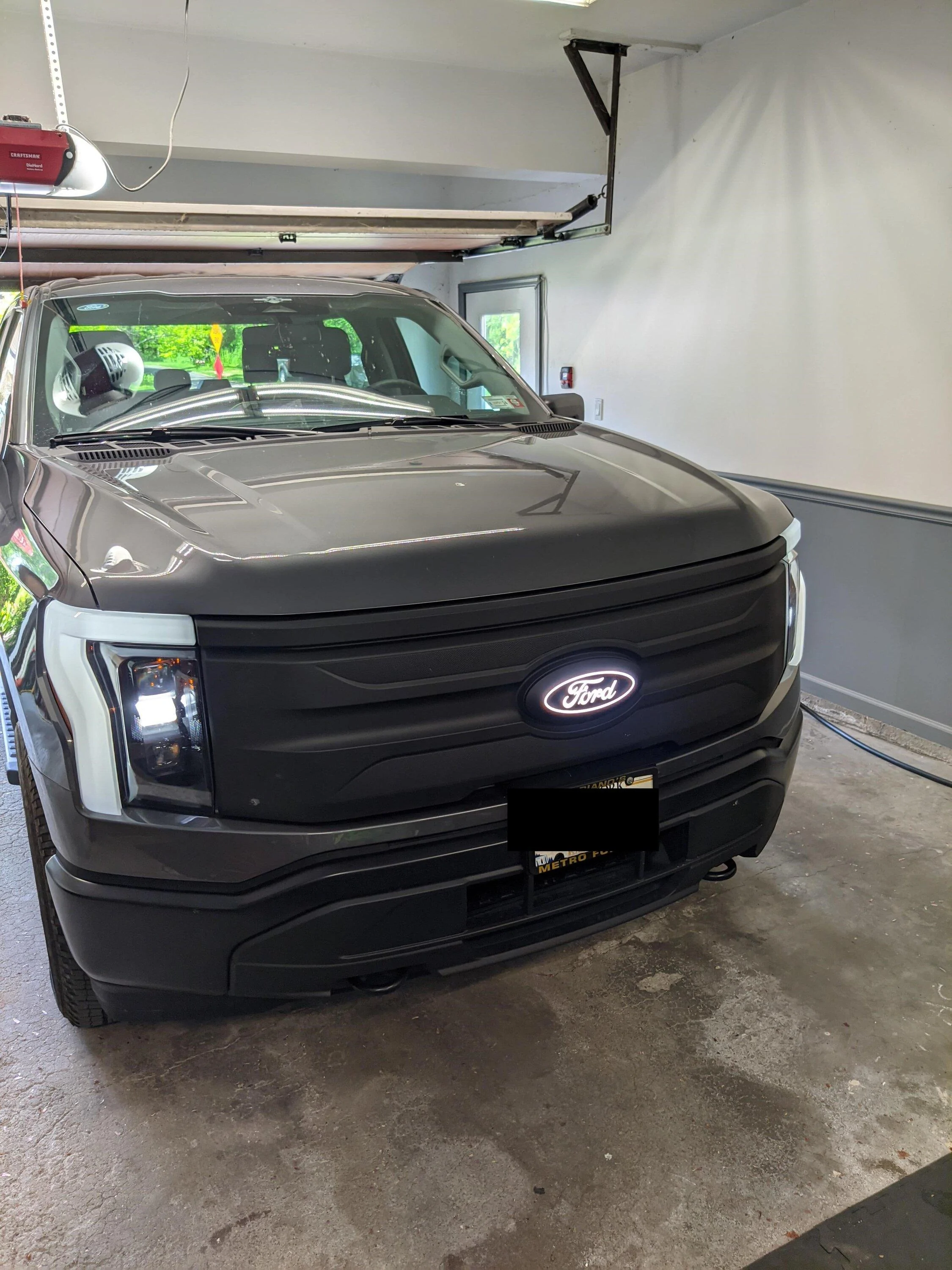

Just did this install today. Went pretty well. I purchased the emblem from Ford and wired the Green wire back together. I doubt the one from Putco is any brighter. This thing is extremely bright. Any brighter and it would be a headlight. Looks great with the Pro grill. The matte finish plastic on the Pro grill and this emblem is a near perfect match.
I just had trouble with the fuse. the fuse they gave me was very tight to the other fuse below it and I ended u0p breaking it trying to force it in. Ended up having to run to AutoZone to purchase another 5A fuse for $7 :(:mad:.
I used Fuse 22 because I like the emblem to stay lit for a bit when the car it parked. When I went out to get another use, I put the fuse in the top spot so that the emblem was lit and left the bottom port open and strangely enough the emblem stayed lit when the headlights were on and turned off when the headlights turned off... Which was, IMO, perfect behavior. With both fuse ports filled, the emblem stays on much longer than the headlights. No idea why and no idea what this fuse does. My headlights worked regardless if there was a fuse or not, but my directionals were clicking fast which normally indicates that your blinker light is out.

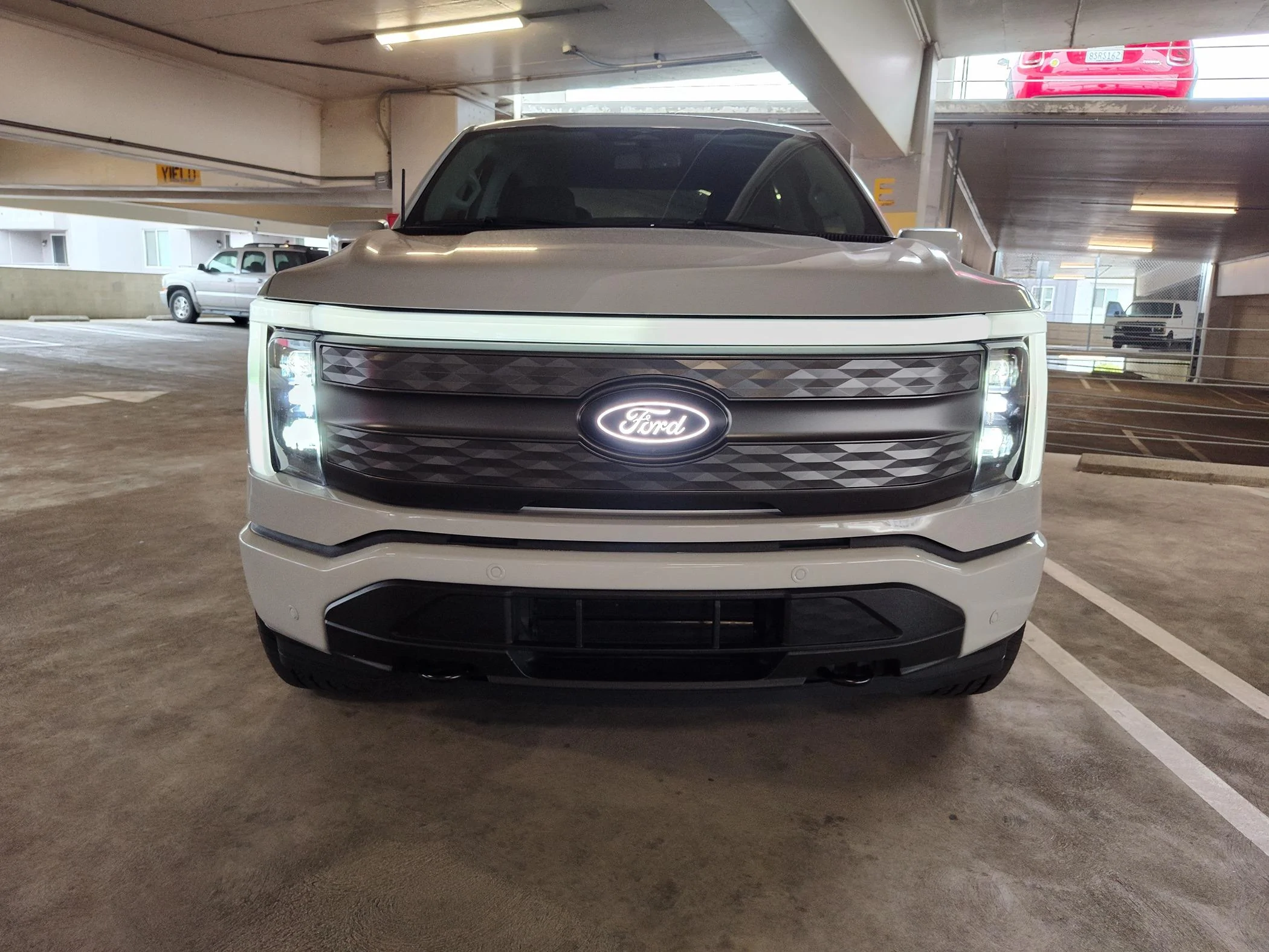

I installed mine yesterday, 23 pro SR. I first tried 48, badge would not illuminate, no error codes. Next I tried 22, also did not work and the truck thru error codes. Next I tried 137, again did not work and error codes. Last I tried 181, this worked, but like others the lights stay on a long time after you turn off the truck. Also the turn signals flash fast. I've done a lot of upgrades and forscan changes previously, not sure if that's why the other spots don't work or maybe because it's a pro. 🤷

Update, after reading thru again I found @Jsfrye post and moved it to spot 22 and used the removed fuse and the fuse included in the kit. Works perfectly, lights turn off normally and the turn signals flash normal speed. I noticed using 181 the front turn signals didn't work and the headlights turned on while charging.

This is the Putco badge. It's brighter than the Ford one and it does a start up animation. I wish it would turn on with the lightbar when you walk up. Right now it turns on when you turn on the truck, and off as soon as you power down.
