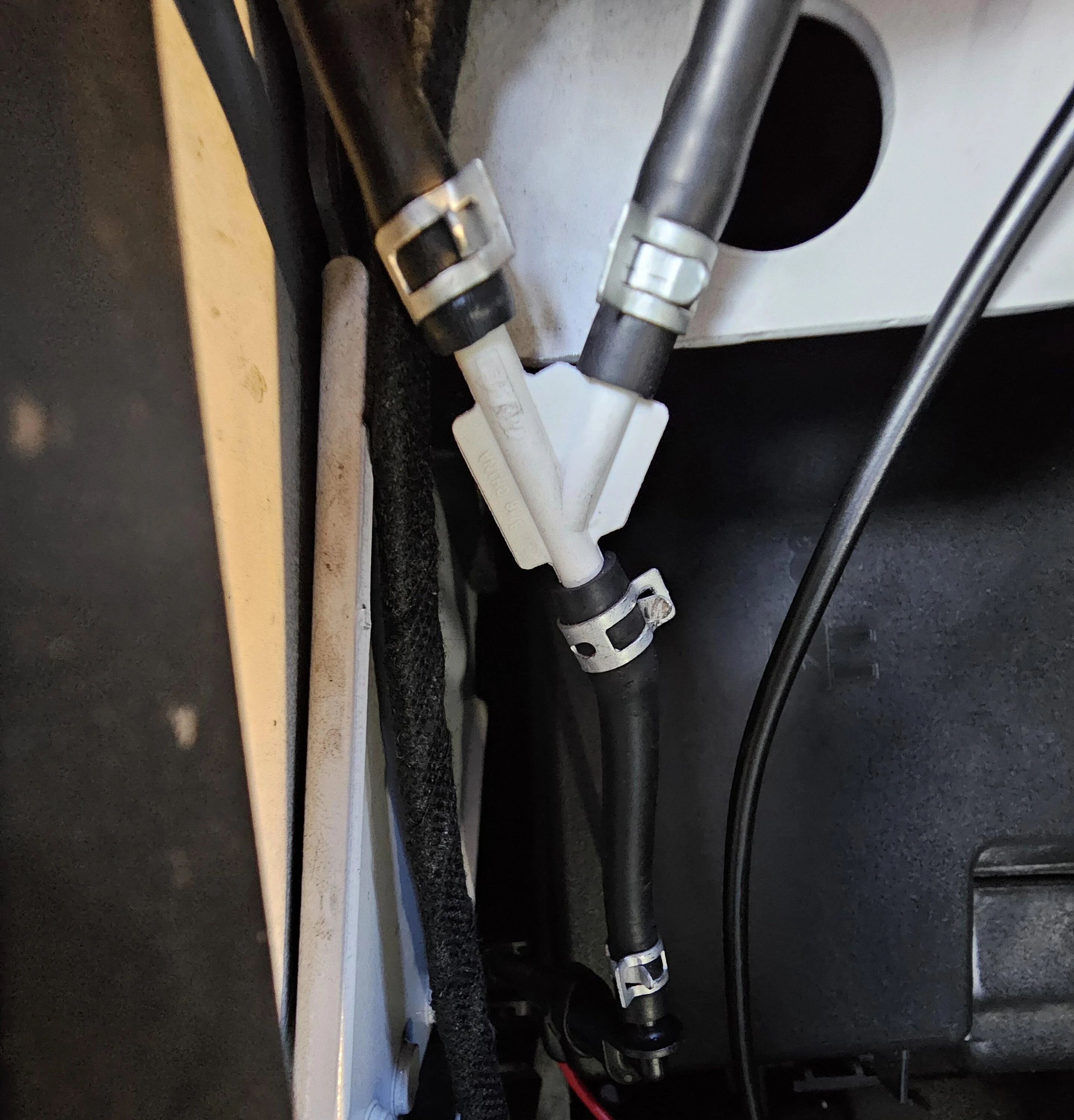

Just (finally) finished my install. Thought I'd post a quick upgrade I added for my 2023 Pro.
I decided since it was so cheap to add the front camera washer. My Pro had the washer housing already attached.
This is the part I bought from Tasca:
HC3Z-17603-B
https://www.tascaparts.com/oem-parts/ford-spray-jet-hc3z17603b
Also, I picked up some black vacuum hose (5/32") from Autozone, small pinch clamps (1/4" pinch style Hose Clamps), and the below "Y" adapter pack.
https://www.autozone.com/fittings-a...e-assorted-vacuum-tubing-connector/426014_0_0
The install is fairly self explanatory and straight forward. Run the tubing loosely connected to the power cable for the LED emblem with cable ties. Verify enough slack for frunk fully open, my install easily lay neatly when the frunk closed.
FYI, I would use more rigid washer hose line. I originally had issues with hose line slipping off and ballooning with cheap Amazon adapters and cheap hose. The below picture shows the junction I spliced into (near fuse box, unfortunately).
