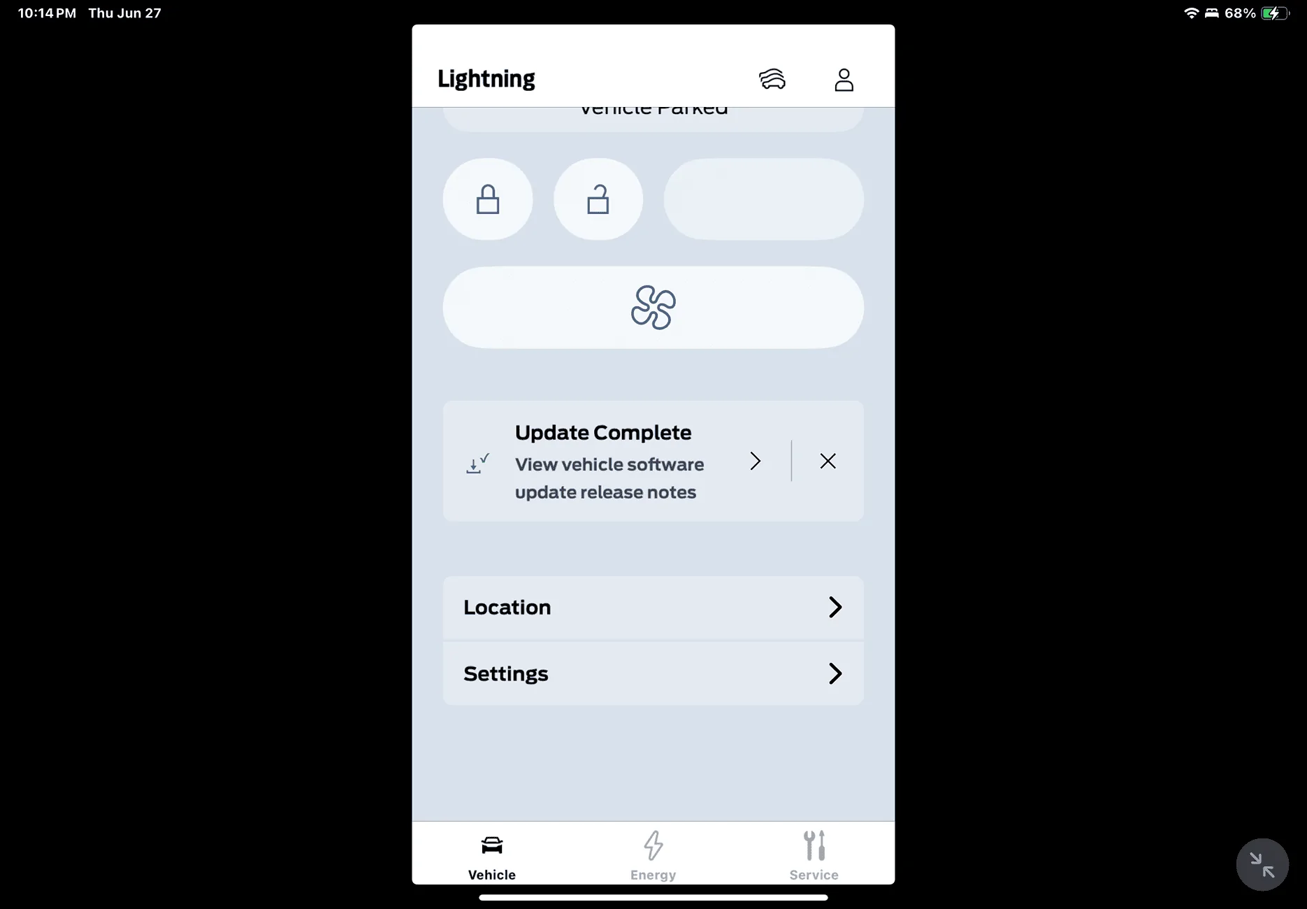

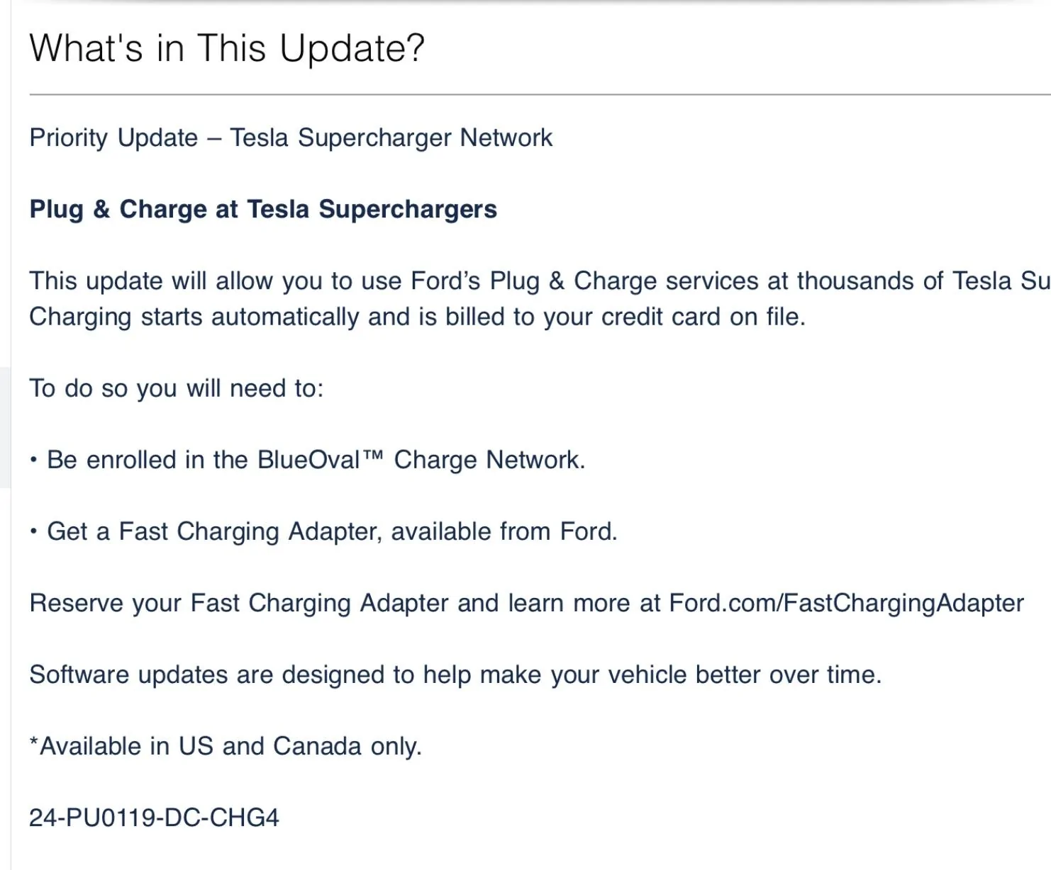

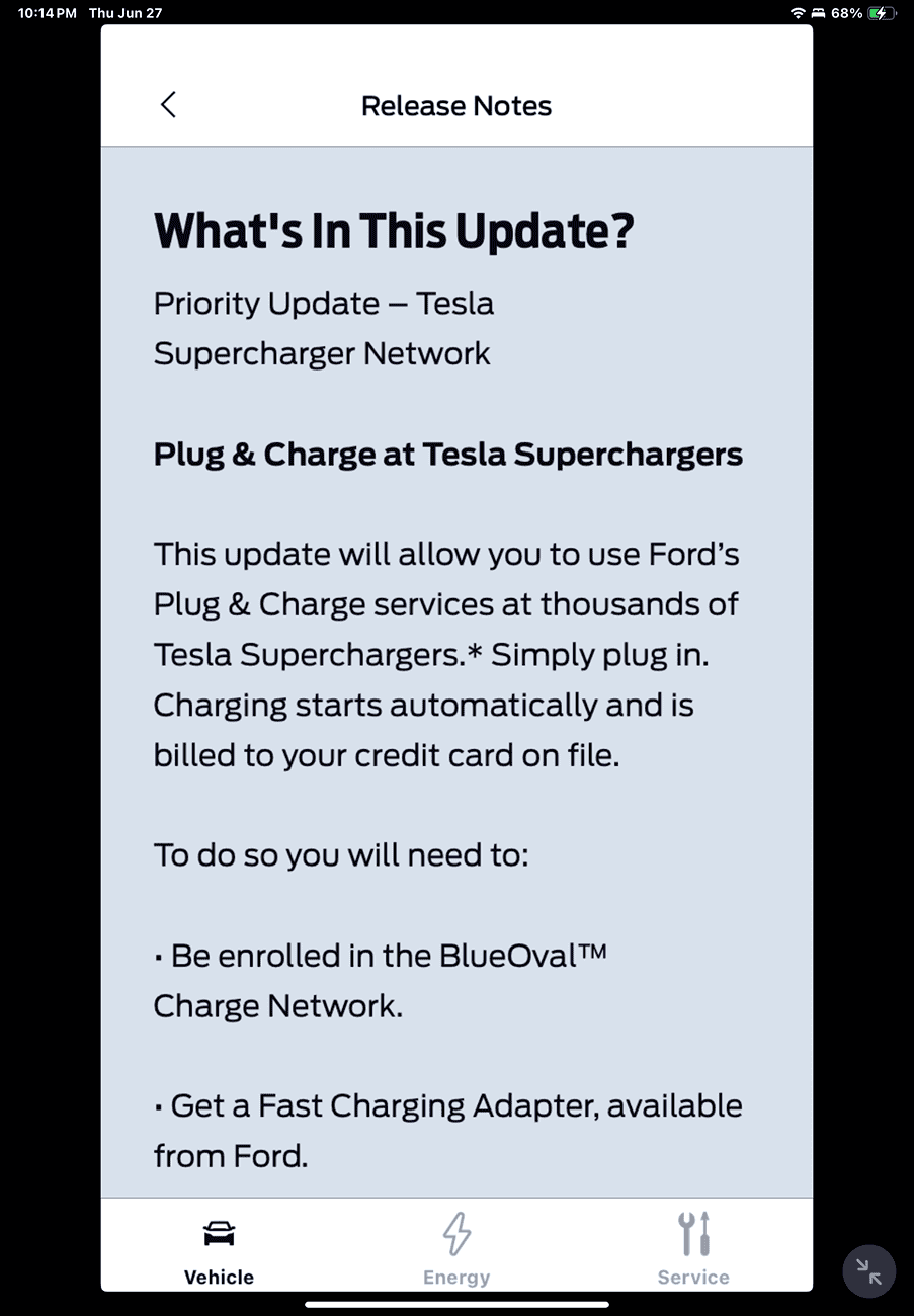

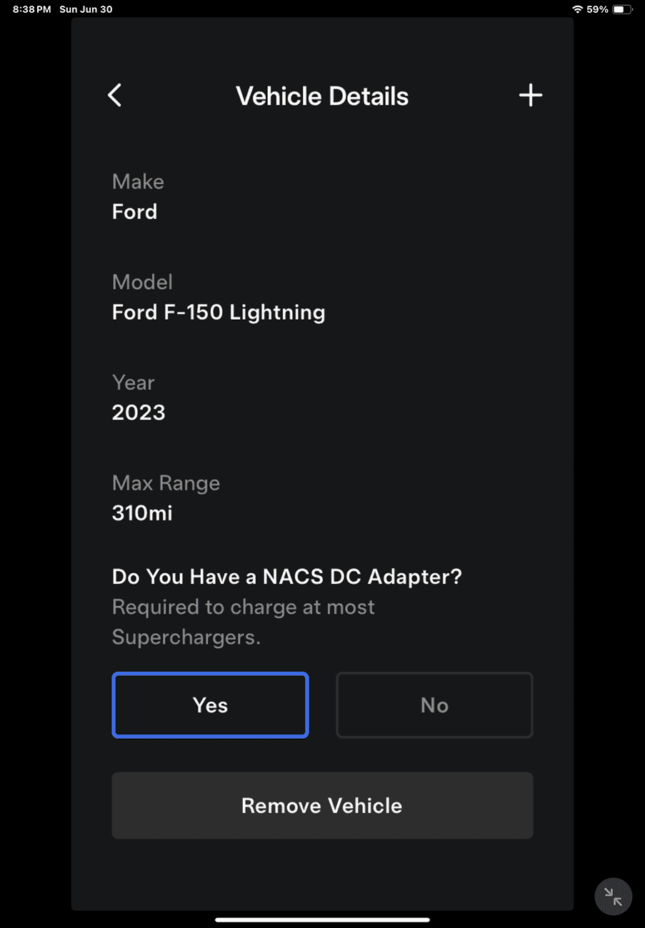

I haven’t read through all the replies. My Lightning failed initially at a compatible Tesla site. I found that when using the Tesla APP I hadn’t set up the app letting it know I had an adapter. Once I clicked YES it charged fine.
I also couldn’t use Plug and Charge with the Ford app. I didn't have the Ford update installed. It was pushed to me a few days ago.
I had done that and I also updated the app but will double check just in case something got "outta whack". Thanks for the info!
