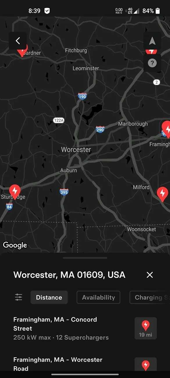

Thanks all, I'm going to try again at a different lacation. BTW, the 5 closest are all just about 20 miles away, hmmm
STOP! All Tesla Superchargers ARE NOT COMPATIBLE!!!!! Based on your picture, you went to a non-compatible location.
Pic below is Worcester showing all Superchargers. I crossed off some that are not compatible. NOTE THE DIFFERENT SYMBOLS!!! You have to UNCHECK Superchargers and pick the other options, OR use the app and put in your vehicle first.
The screen shot is from the Tesla app and the app is setup for a Lighting so is Elon lying?? :)
Also, I was trying to use the Tesla charger in Sheffield, MA which showed as being compatable as well
106
6,544
8,889
In the app, they don't have different symbols. The website does. So, as long as you put in your vehicle, you're fine.
Both the North Canaan and Great Barrington sites are compatible. There is nothing in Sheffield, so I suspect you meant one of these.
You're right, it was Great Barrington, we stayed in Sheffield and I drove to GB and the Tesla app showed just those 2 in the area
Try Sturbridge. I was successful there with the A2Z adapter just yesterday.
