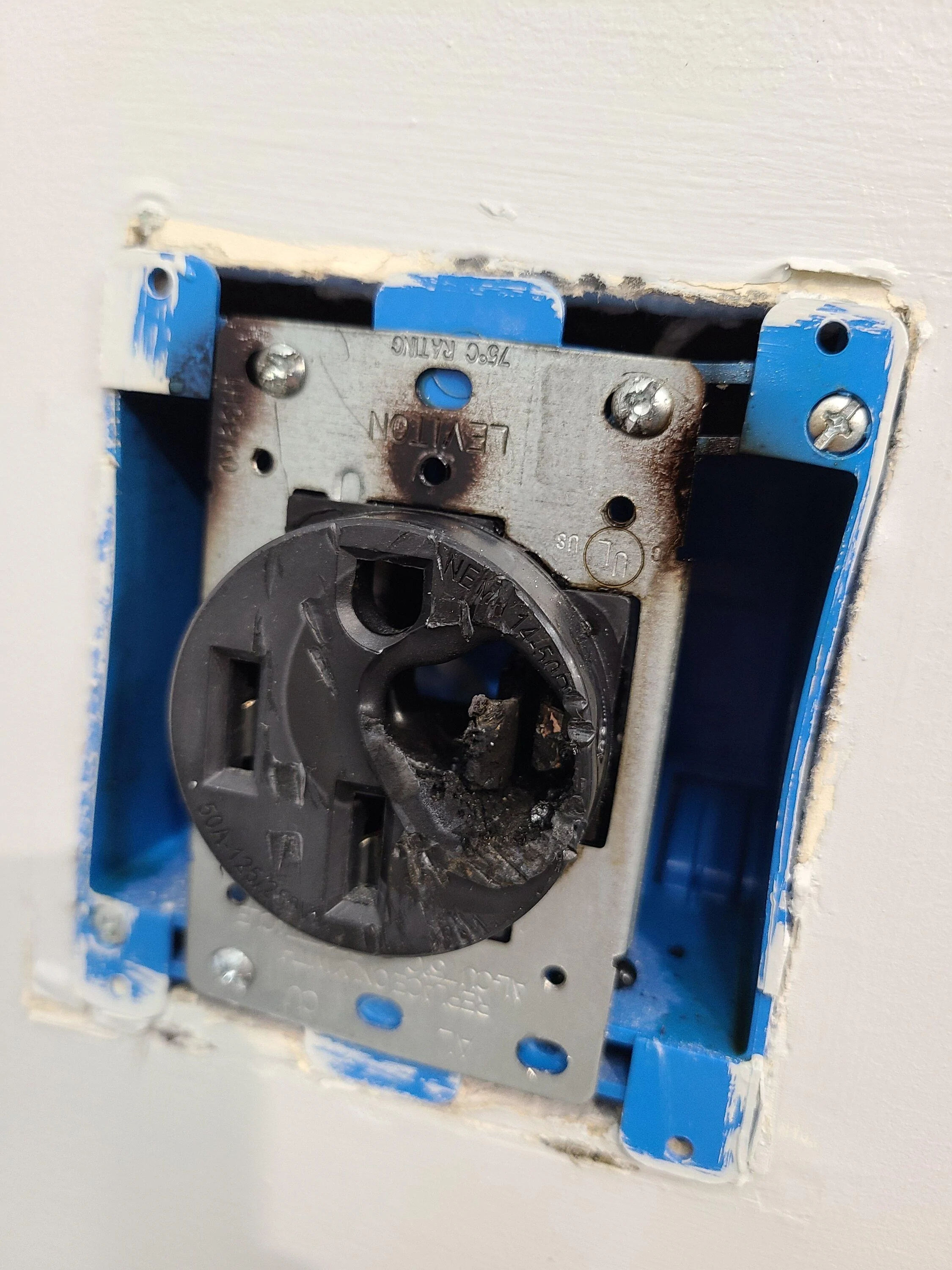

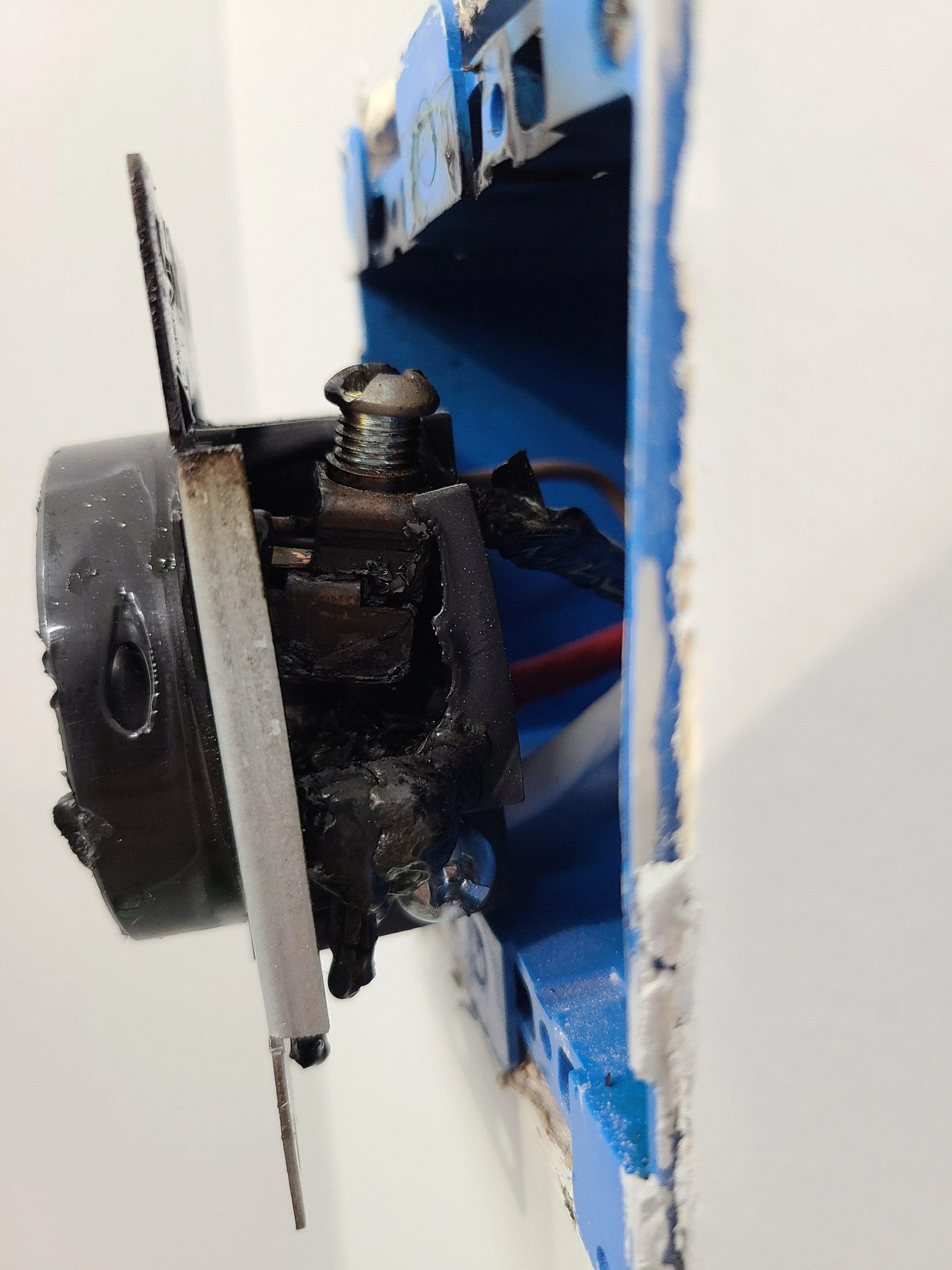

In addition, beatle's receptacle is another example of something to watch, above. Over time, connections can become loose and loose connections generate heat. New installs for EV charging should be torqued well, and after a few months, retorqued to ensure that nothing has worked loose with expansion and contraction. I re-torque all the terminals for my EV charging equipment and runs at least every other year.
It's worth noting that I didn't re-torque any of the receptacle's screws after installation. I did reef on the screw pretty good during the initial install though. I then ran it as-is for a little over 2 years @ 40A before it started to melt. It's definitely possible that the terminal worked itself loose from heat cycling, but I also saw that the Leviton receptacle I used was known to fail on others in the same way. Here's a side shot:
Ford F-150 Lightning Faulty Mobile Charger? 20220302_212035
Not to distract from the OP's question, but I posted the electrical gore it as a note to say that the breaker won't save you from every failure point, and running a circuit/receptacle at its maximum rating for extended periods is a good way to reproduce my problem.
