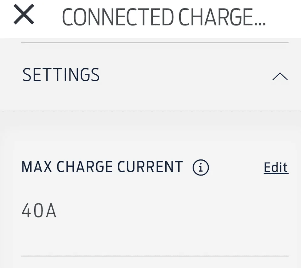

I lowered my setting from 80 to 40 for tomorrow's testing, when I exit and return to the app, it's still showing the 40 amp setting.

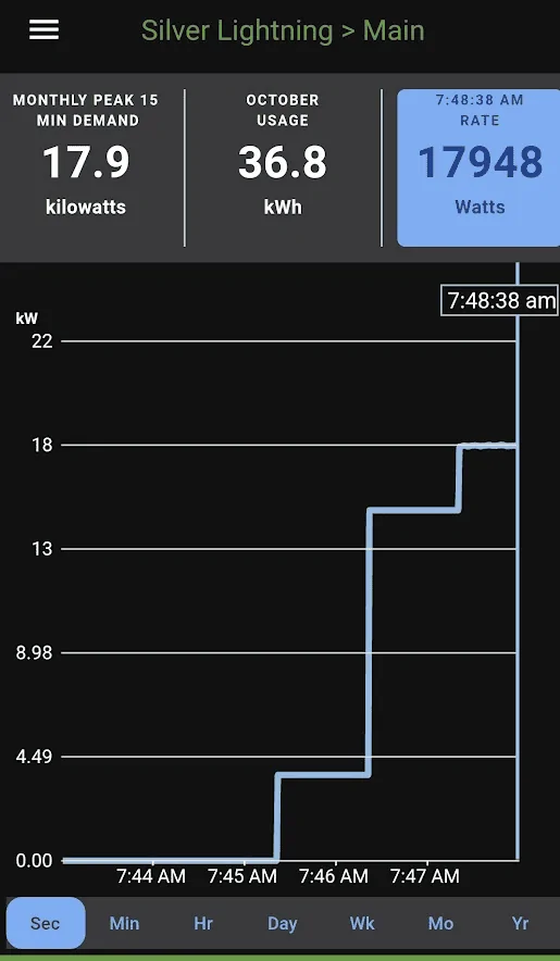

My tests confirm your observations, I plugged in the truck this morning to get a head start on testing, I was only at 86% my max is set for 90%.
When I plugged in she ramped right up the 18KW (80 amp) setting rate, though the FCSP was still dialed for 40 amp in the Fordpass Connected charge station settings.

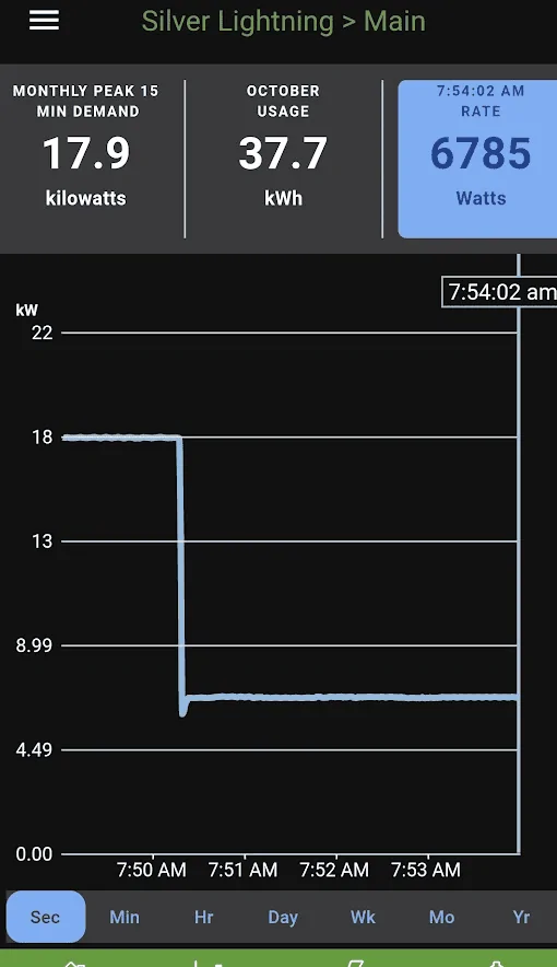

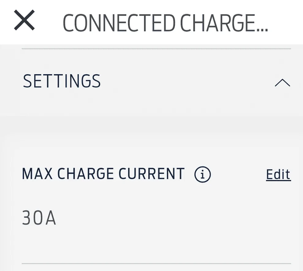

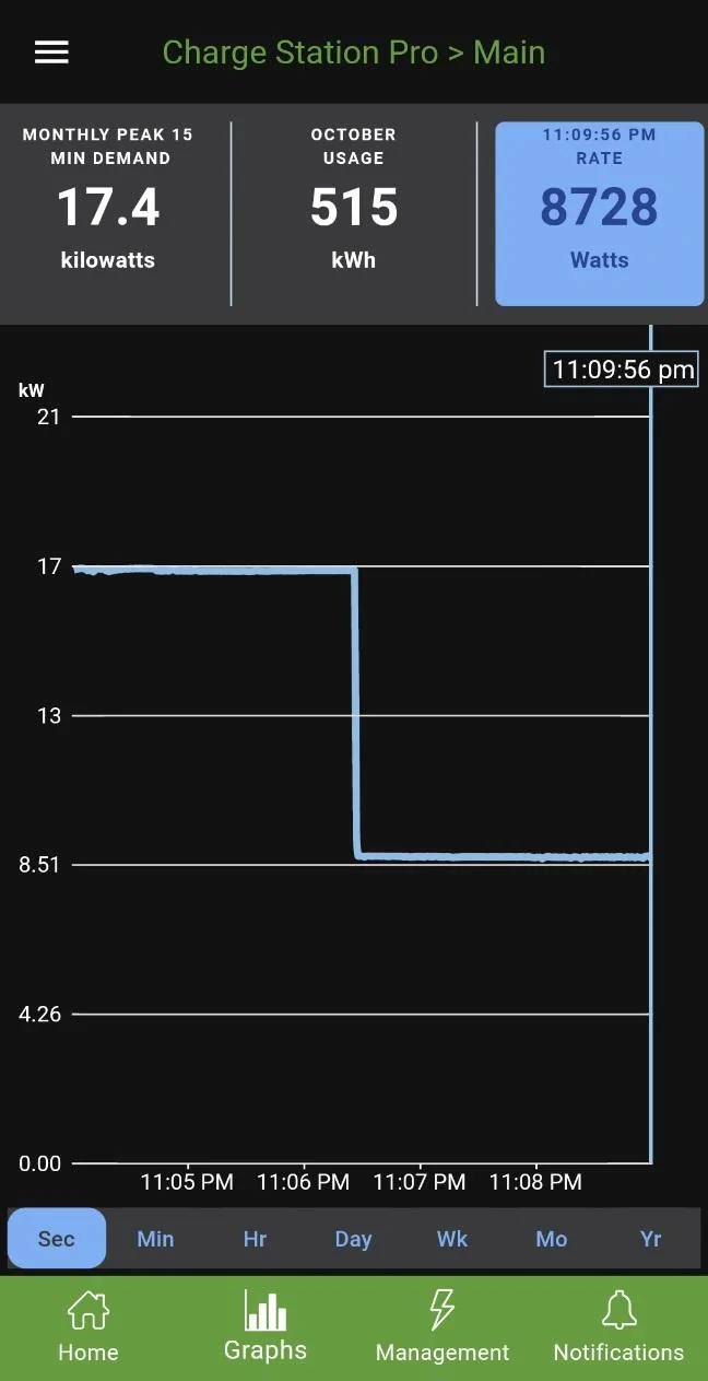

Then I tried dialing it down further to 30 amps while actively charging, that worked!
Note emporia adds the two 120v legs for the sum of 57.2 amps, actual 28.6 for my 30 a request.

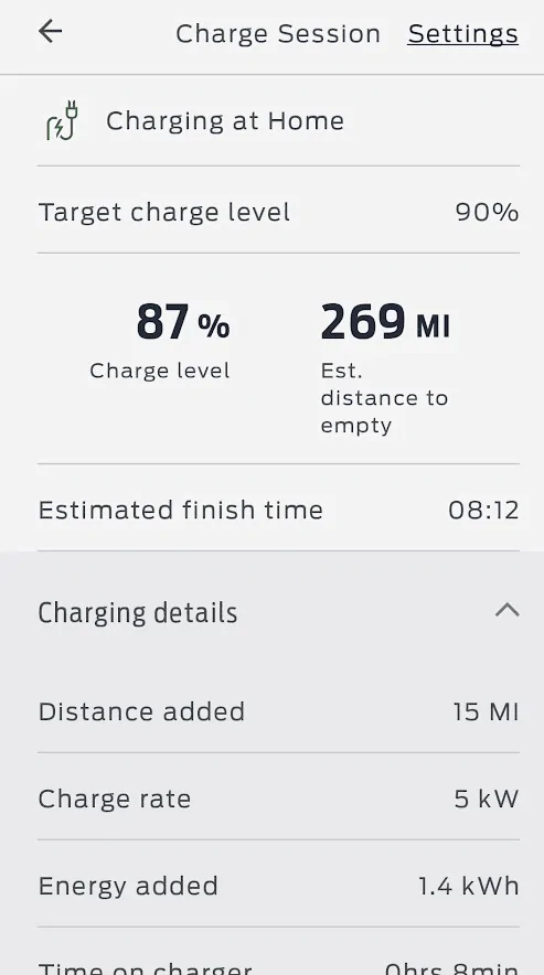

FP Charging detail screen when lowered to 30a

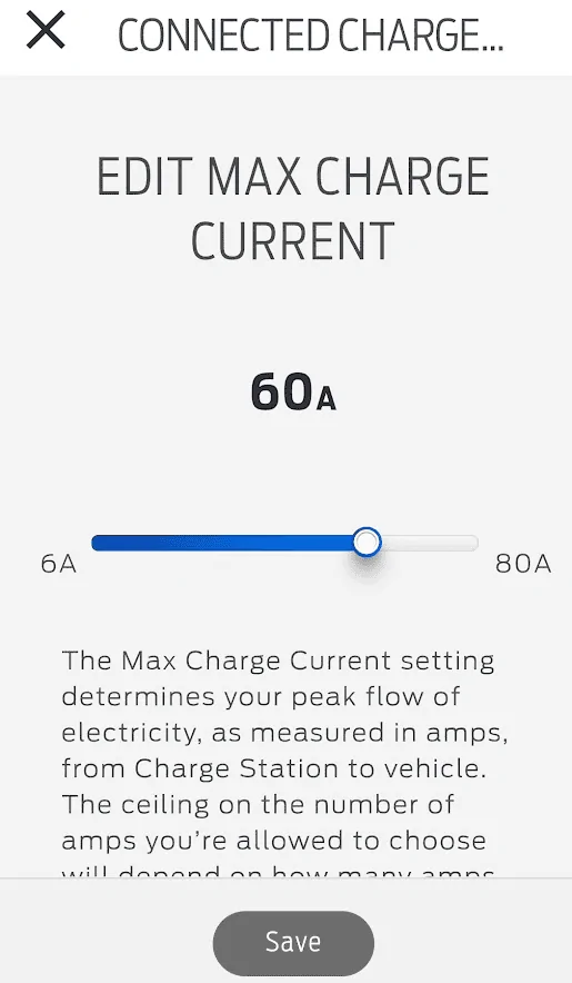

Then I tried bumping it up to 60A, but the FCSP jumped to 80A again

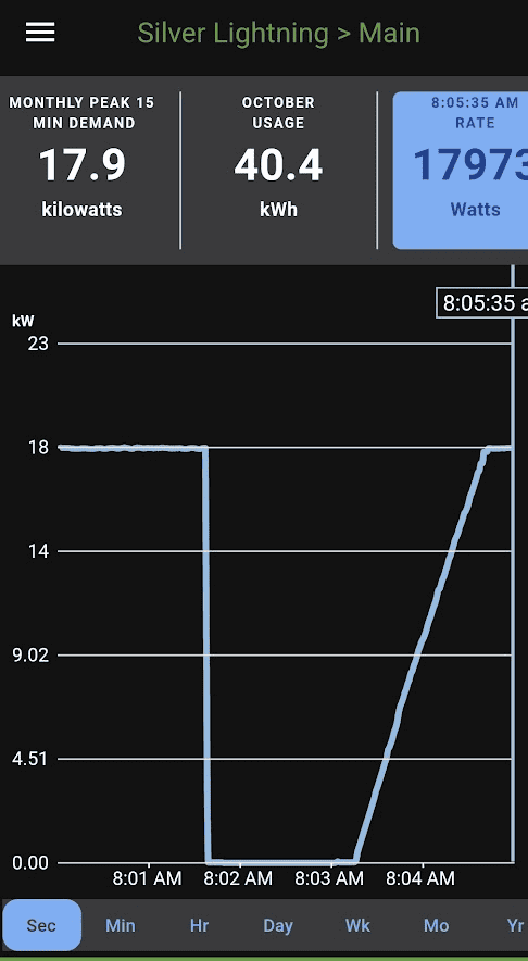

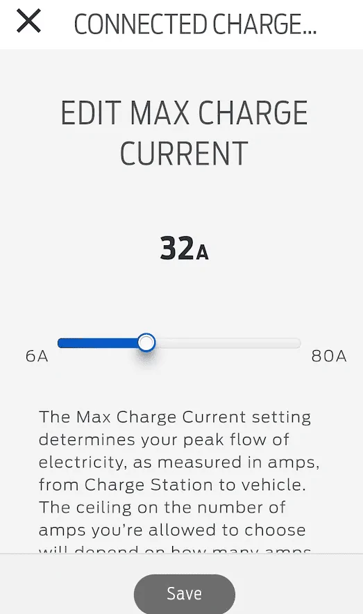

I shut it down briefly with a STOP request, that worked, as you see in the chart below, then resumed my schedule but lowered it to 32 amps, with no impact, it stayed full throttle at 80A

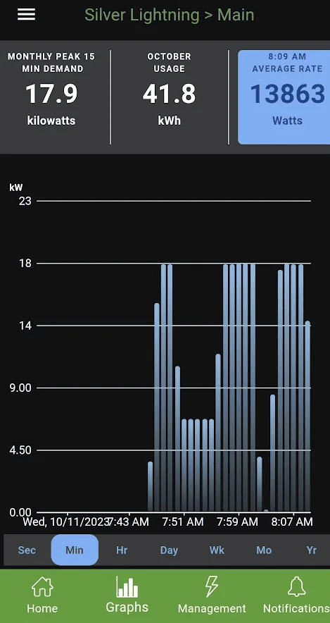

Overall view of the session by the minute

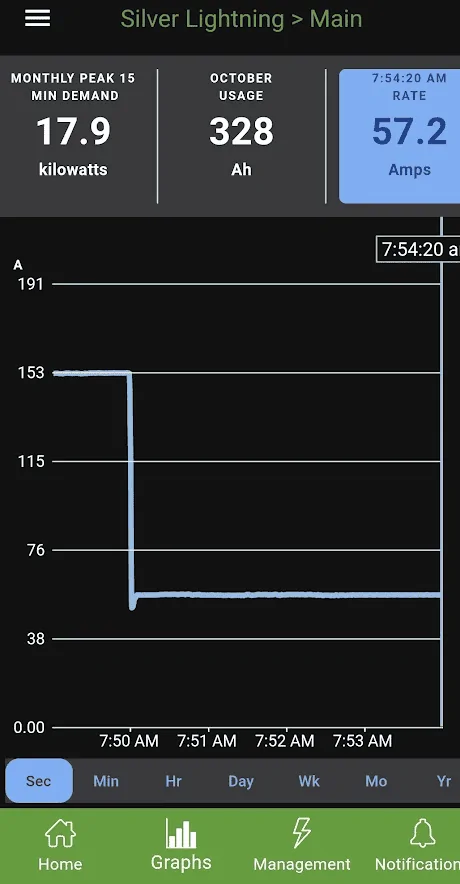

Couldn't leave it alone. I had to stay up late anyway to make sure it charged. I feel Ford owes me babysitting money.
Anywhoo, after couple of reboots, clearing the cache in the app, and numerous attempts to change the charge rate, I got it down to 40 amps. Here is a graph of the charge rate changing, while charging, to show those who think it can't be done that it can be.

Which app is the "Charge Station Pro > Main" screen from? Thanks!
