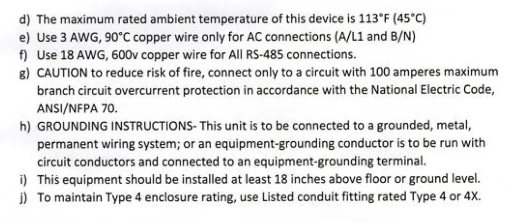

It would probably be a good idea to get input about a ceiling mount from Ford and Siemens the manufacturer. There are warranty issues if not mounted per the instructions (wall at least 18 inches from floor etc.) and may be safety concerns, too.
Ford: 1-800-392-3673 is the number listed in my install guide.
Siemens: 1-800-333-7421 is the number listed in my install guide.
I know there are some EVSE makers who say it is fine to ceiling mount, but the FCSP can deliver 80A so likely will generate more heat than those.
The install guide says the max rated ambient temp is 113F. Ceilings under an uninsulated attic can get pretty hot.
Ford F-150 Lightning FCSP on Ceiling? safety instions part
Note items (d) and (i).
