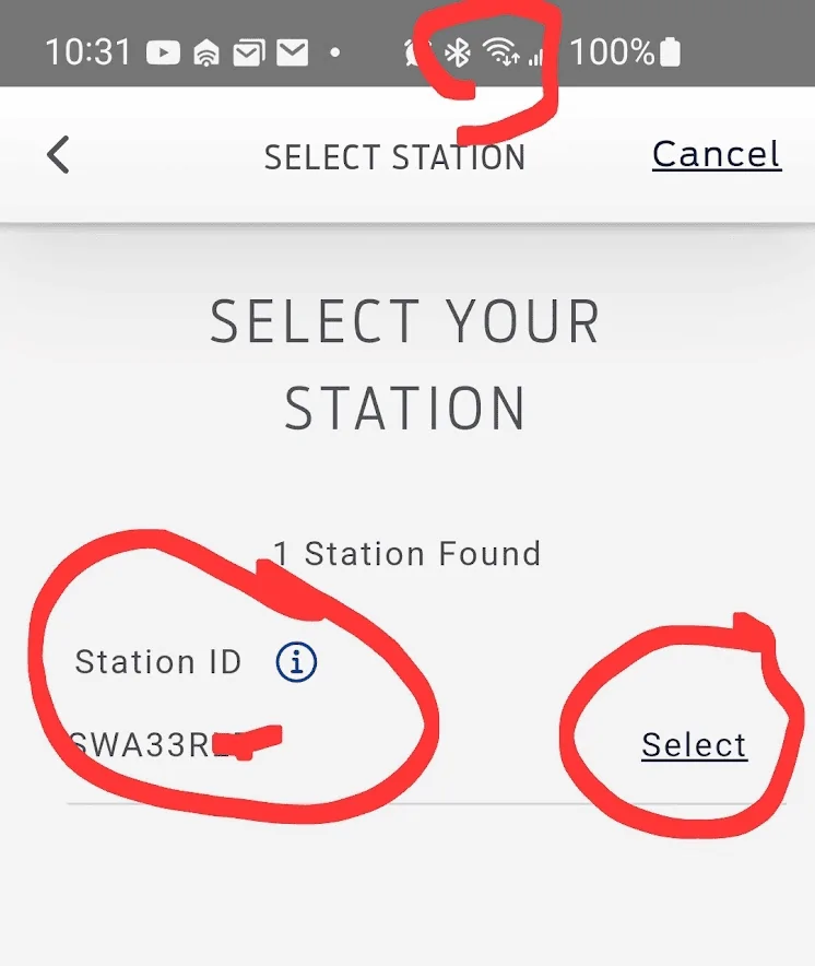

I tells me no stations found. One is here in Pennsylvania and the other is installed in Ocean City MD.
I should be able to access them remotely I would think? I am not sure but I installed and have on many an occasion turned off the breaker waited 10 minutes or so and yet still never reconnnected.
I have not had a problem charging although noticed connecting and disconnection while charging. Regardless the overnight charge worked as expected with the parameters set through the truck. Am I just confused? I also have entered the SSID manually to no avail.
212
15,690
17,582
No, the setup APP will only see the FCSP when your mobile device is actively connected to the SAME WiFi network the FCSP is pinging on, you can not make the connection via mobile-/4g/5g communications PA---->MD

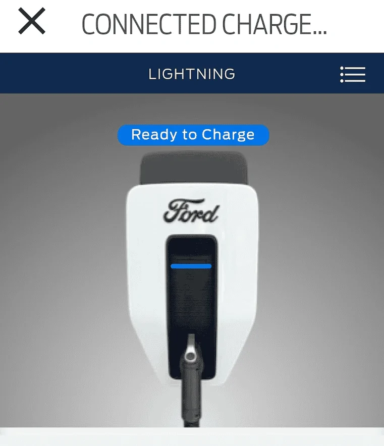

If you're seeing the not connected warning in the Connected Charge Station pane on the Fordpass app, it could be the FCSP is not talking to the network or the Ford Cloud is acting up, 50/50 as to which is the culprit, I've solved that issue with a power cycle and waiting 15 to 30 minutes for the cloud to recognize the FCSP, the times it didn't resolve, waiting several hours to a day and the cloud data center issue clears up.

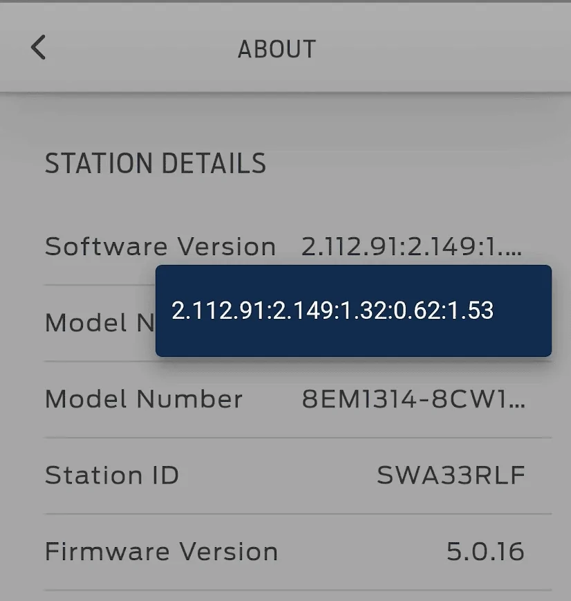

Thank you! I also noticed the version on my FordPass app is different then whatโ€™s in about on the ChargeStationPro app.
212
15,690
17,582
The last pairs of values are reversed in the SETUP app, after logging in, tap on the software version to see the full details, eventually they will match once the updates have posted with exception to the flipped values at the end.
