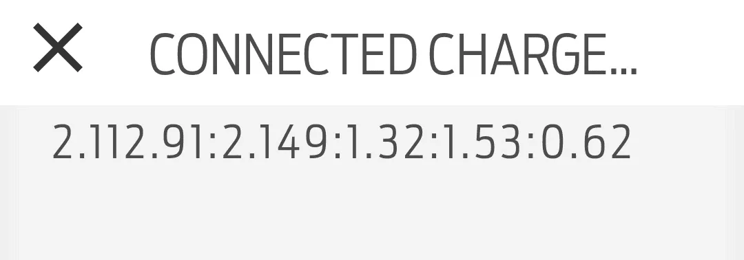

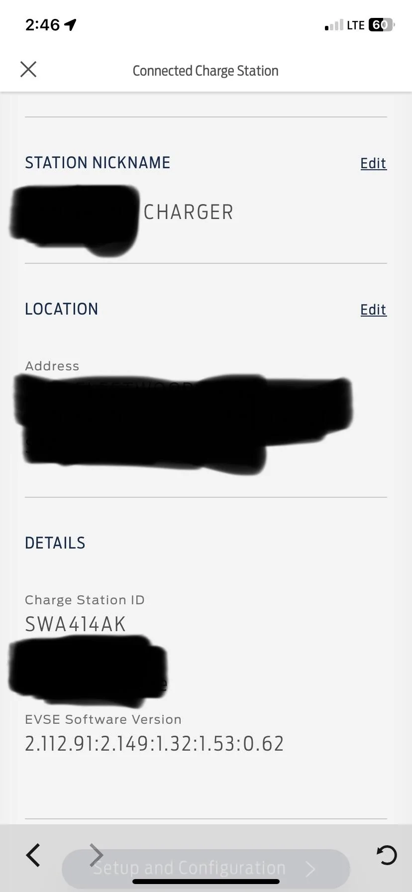

I just got a replacement charger because my original charger was causing the truck to give a flashing amber light when attempting to charge. I got nowhere with Ford in that it was just a coincident the same day as a firm where update so they sent me a new unit that I stalled this week.
everything is working great again but my firmware says update pending. I understand I need to leave it unplugged which is crazy everynight. Does anyone know what has been the pattern if I leave it unplugged at night for the upgrade to happen? What is the latest release? Mine is
2.112.64:0.0.0.0.0.0.0.0
Mike..I also got a fcsp replacement and just installed it a few days ago. The reason I got a replacement was because I got a solid amber color and it would not charge. I got the same 2.112.64.0.0.0.0.0.0.0.0., after installing it. I just left the fcsp on and it updated by itself, 2 days later. I noticed that the replacement unit ford sent is staying connected to my phone pass app on a constant level. I checked the connection on phone ford pass app (connect charging station), twice a day at different times, and it is staying connected every time I check.

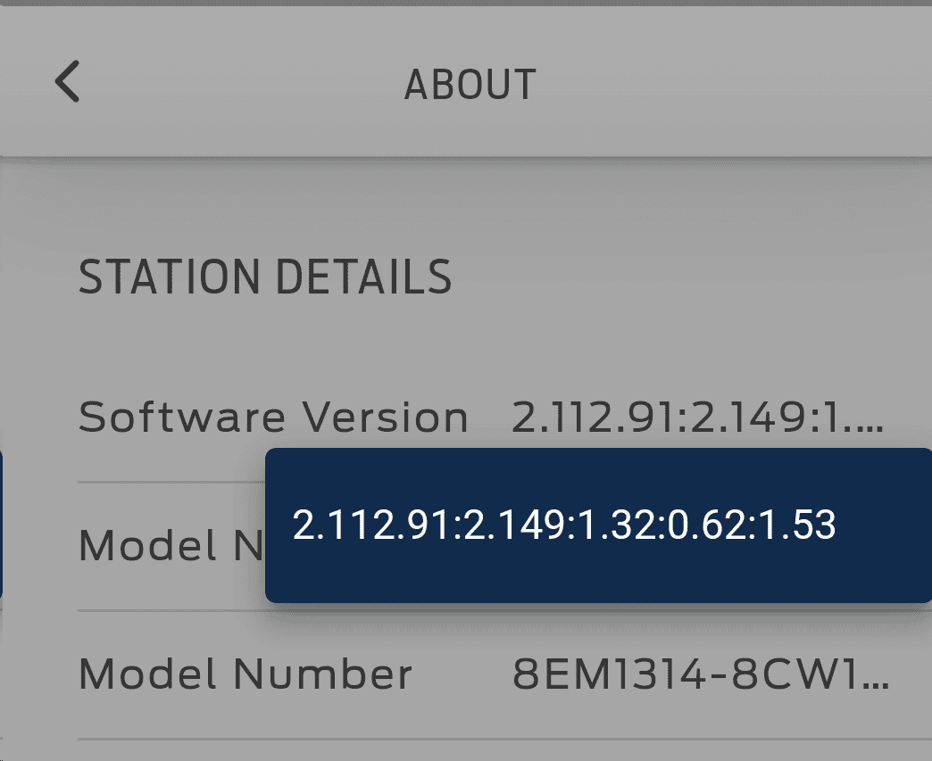

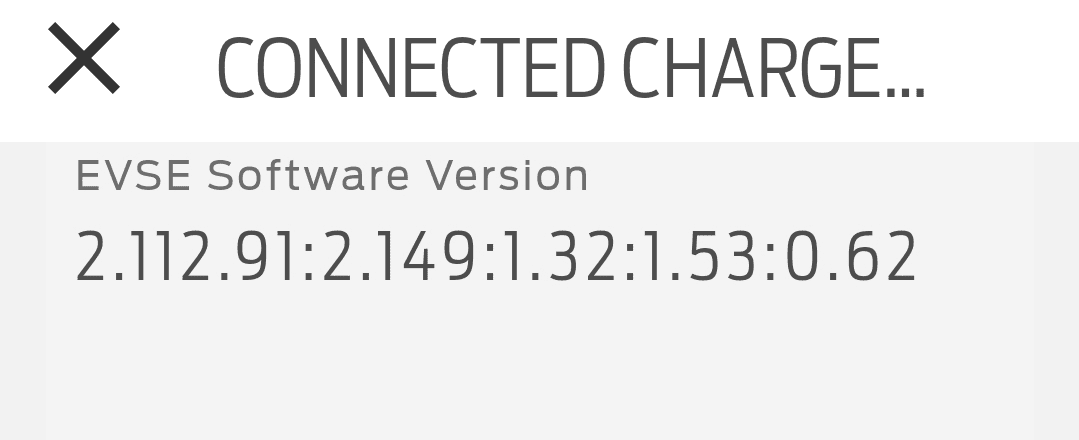

My charger is on software version 2.112.91:2.149:1.32:0.62:1.53 and has showed that in the Fordpass app. until I checked it tonight. Checking my FordPass app tonight I noticed it shows I have an update pending and Software Version 2.112.91:0.0:0.0:0.0:0.0 I've checked the Ford Charge station app & it still shows 2.112.91:2.149:1.32:0.62:1.53.
I unplugged from the charger for tonight & will see if I receive an update.

INTERESTING ...... running out to reboot my OFFLINE FCSP!
187
14,076
15,170
Welp, got the reboot done and she is talking to the mothership again, but no flags for new software yet.
I'm on second string when it comes to updates for the truck, probably also for the FCSP, LOL.

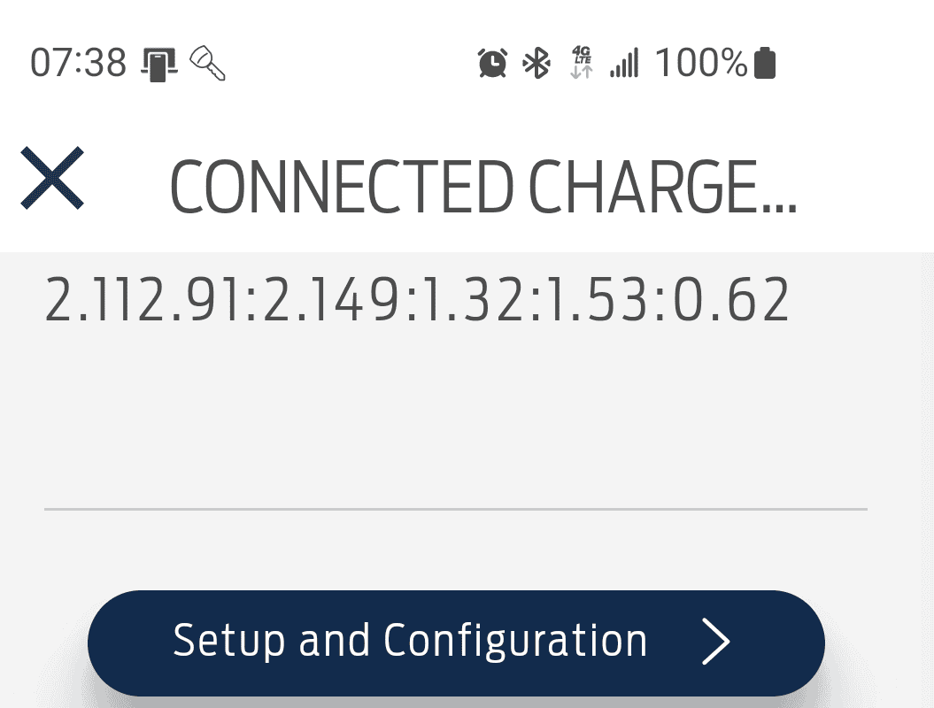

So this morning I still had the triangle in Fordpass, I shut off the breaker & restarted FCSP & now no triangle waiting for an update. I now show version 2.112.91:2.149:1.32:1.53:0.62 in Fordpass. In the FCSP app it still shows I'm on version 2.112.91:2.149:1.32:0.62:1.53.
187
14,076
15,170
So this morning I still had the triangle in Fordpass, I shut off the breaker & restarted FCSP & now no triangle waiting for an update. I now show version 2.112.91:2.149:1.32:1.53:0.62 in Fordpass. What is strange is in the FCSP app it still shows I'm on version 2.112.91:2.149:1.32:0.62:1.53.
I've had this scenario happen in the past, one thinks a change is coming, but it 's still showing the same version, BTW mine has not changed since last evening as well.

I don't understand how their versioning works.
Mine Fordpass shows 0.0:2.149:1.32:1.53:0.62 and FCSP app shows 0.0:2.149:1.32:0.62:1.53
I'm not sure what the difference is between 0.0: and 2.112.91: and best I can remember it's always been that way with an orange triangle. I also don't know why the two different apps have inverted or switched or whatever we should call that version numbers.
I think you're missing the [2.112.91] portion in your readout!
As for the last two pairs, 1.53 and 0.62, they are consistently reverse ordered between the FCSP readout and the Fordpass readout, it would be nice to see them displayed the same.
Earlier versions showed the same discrepancy between the two app's.
