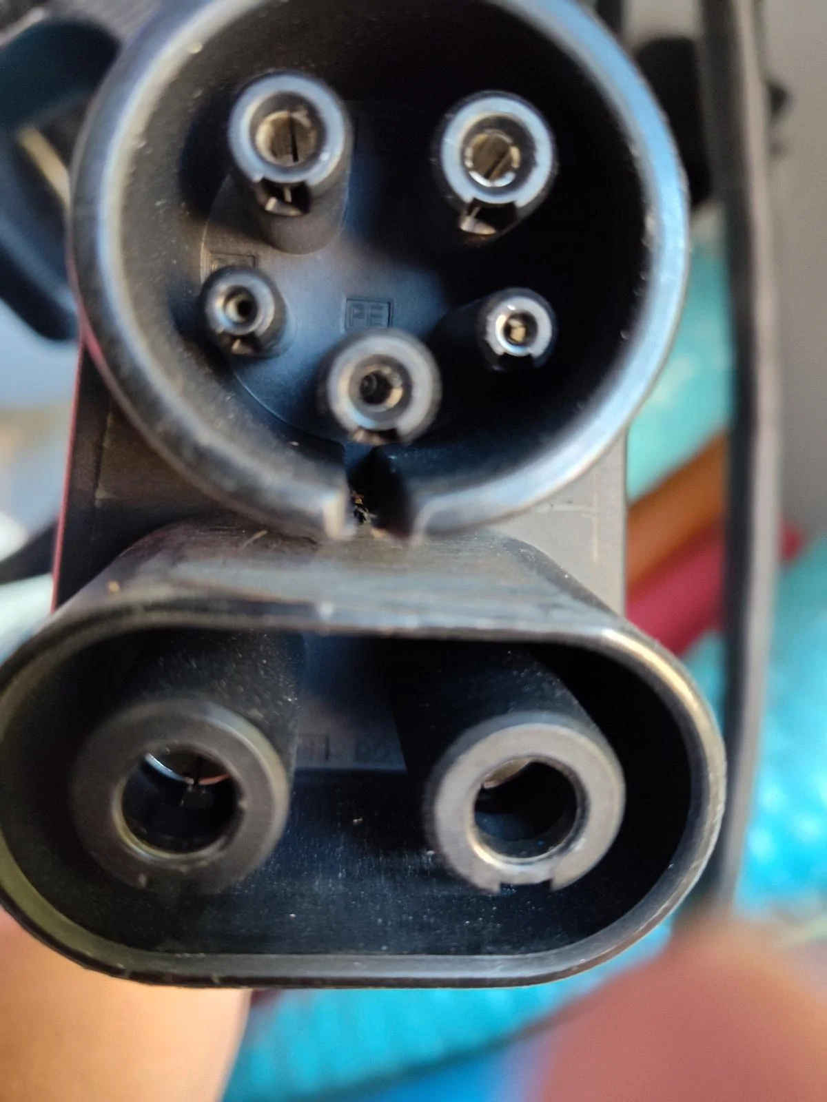

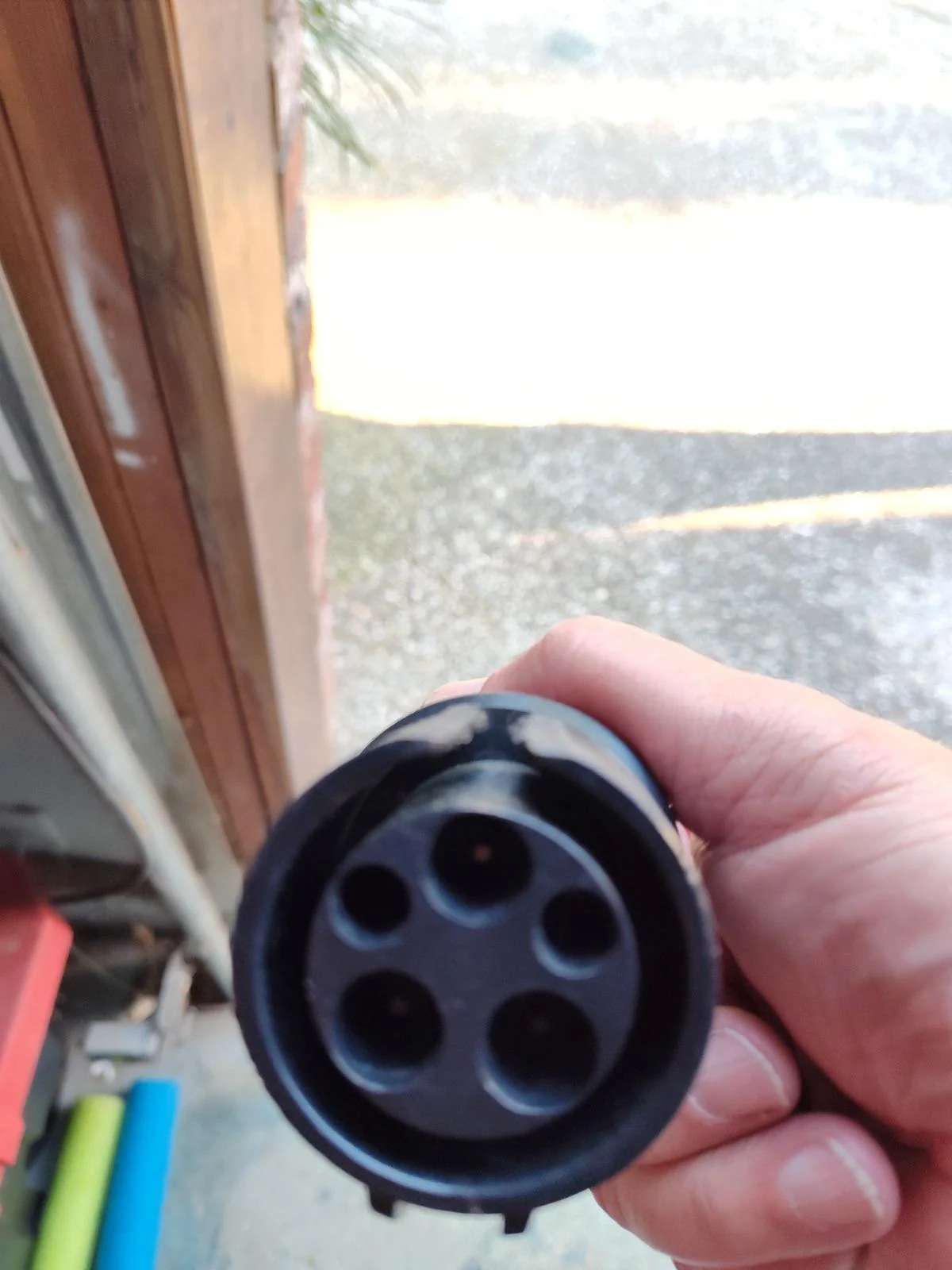

I don’t think that’s the case. Some folks have successfully modified a Tesla adapter to charge their Tesla. There would be nothing to the DC pins in that scenario.
Yes, Exactly I have modified adapter and used it quite a bit
So to be sure I’m understanding clearly, your modification method entailed what exactly and used what to do it?
Dremel tool or hacksaw blade. You have to cut off the joining plastic on the Charge Station Pro between the round AC section and the DC Pin section, and on the Tesla adapter, it requires cutting off the bump-out that hits that area on the J1772 plug. I'll upload photos later unless someone beats me to it.
Much appreciate for this , thank you!!
Any pics are just icing on the cake.
I’m hoping everything else functions as intended after doing this.
I’m trying to make use of two of these “free lol” chargers I already own, but also have ability to use with tesla in the coming year. I have no desire to use with the home integration part of adapter.
Ford F-150 Lightning Ford Charge Station Pro (2024 Review) IMG_20240409_185326824_HDR
Ford F-150 Lightning Ford Charge Station Pro (2024 Review) IMG_20240409_185341413
