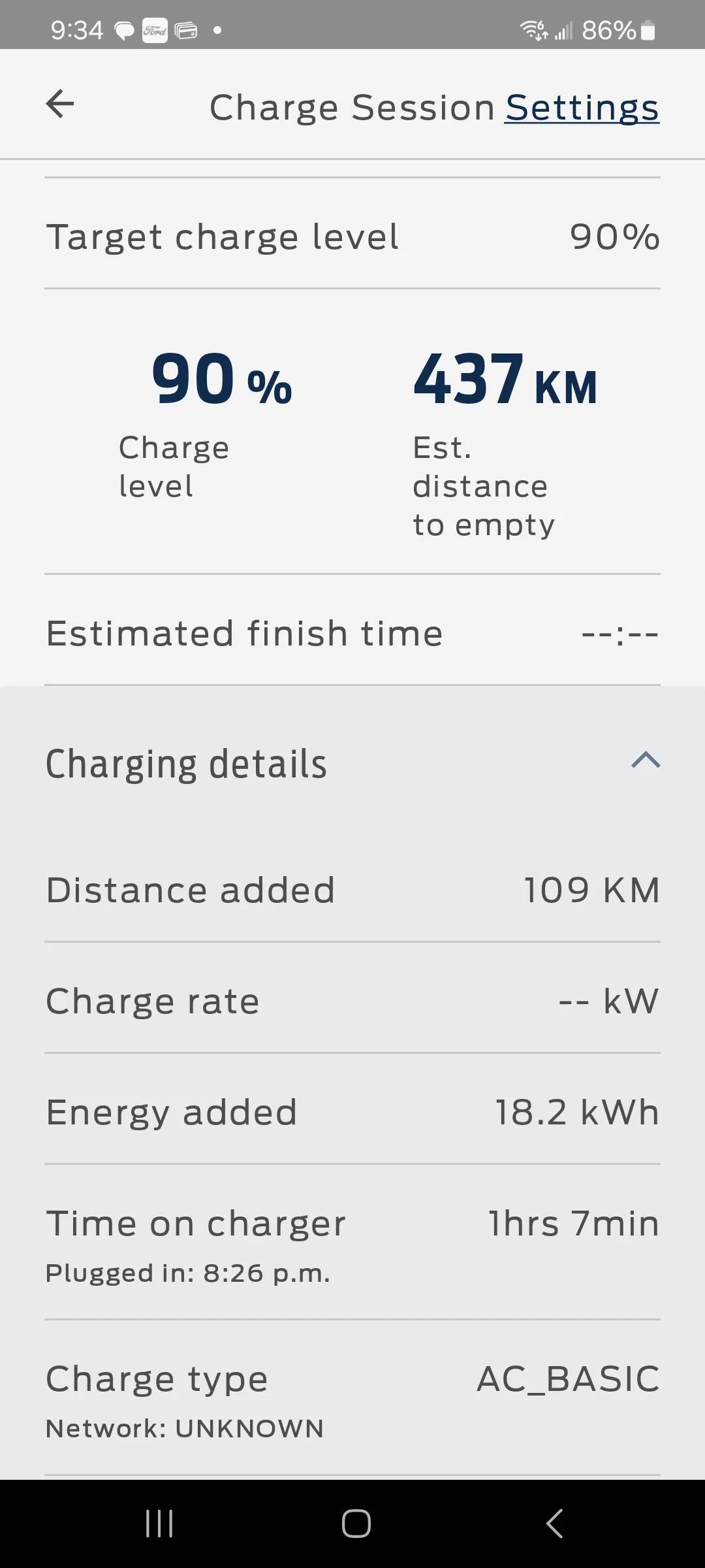

It sure is insane for home charging! It's sure nice though... Especially coming home from a long trip and you know your home charger will perform for you. 131kw battery pack, you need the juice!
Ford F-150 Lightning Ford Charge Station Pro - Newb Question Screenshot_20240124_213432_FordPass

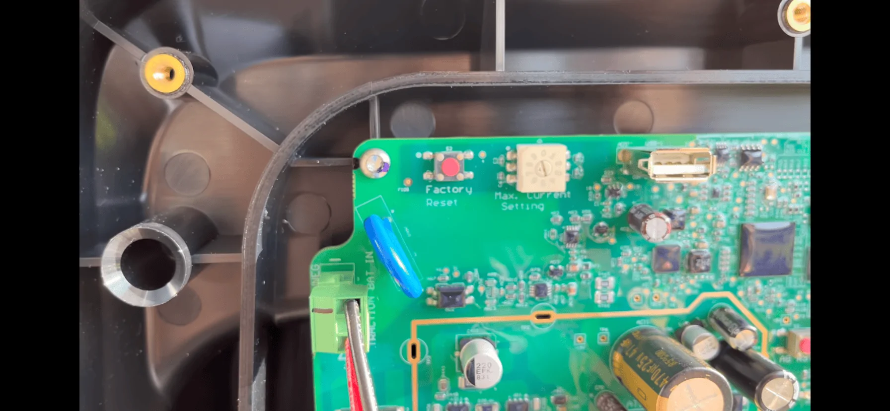

It is derated via a dial selector buried inside the case. No one will accidentally change that setting without being knowledgeable enough to trust themselves with opening the case and messing with the internals. Not likely. Label is of course not a bad idea.
Faster charging is nice.
I read earlier about someone turning charging up to 80 amps, but I'm assuming, what is above is true. When I self installed for our Solar charger, I derated to 12amps with the dial, as it's on a 6kW Hybrid charge/verter. I know there is a setting in the app to change amperage, but, I'm assuming it can't override the dial setting.

You can set the charge rate in the app lower, but not higher than the hardware setting.

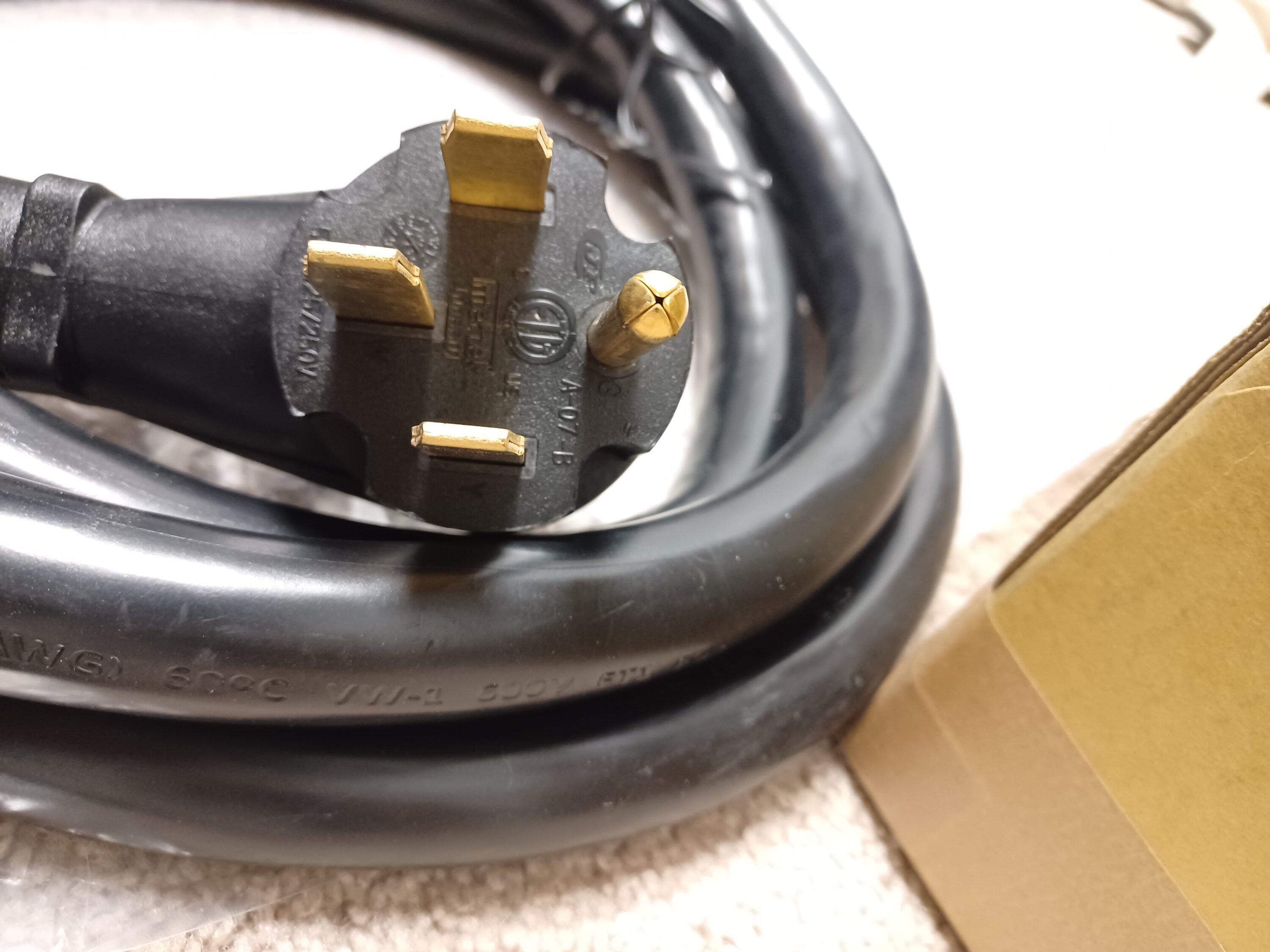

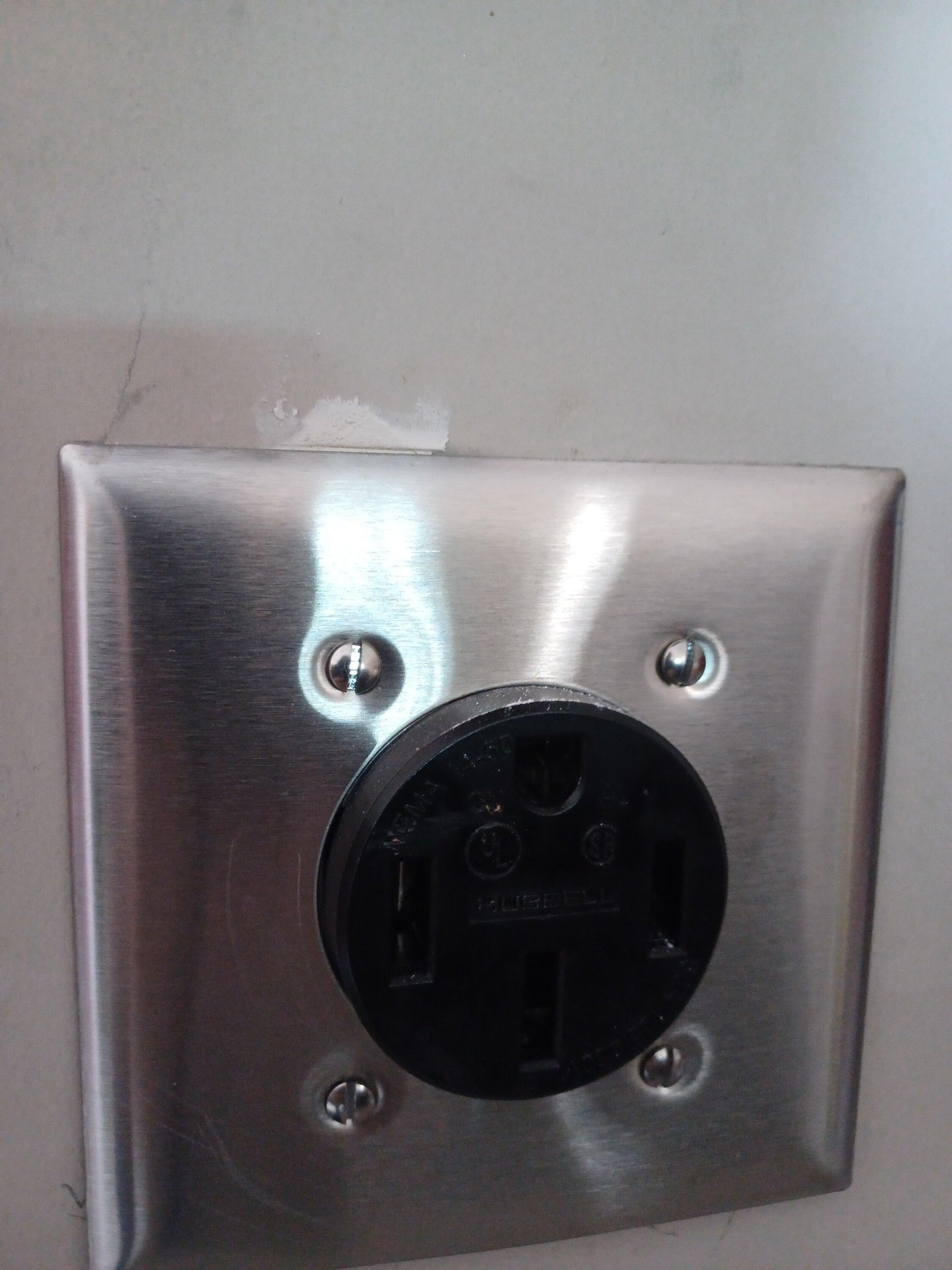

I did this by adding an RV 50amp extension and used my outlet. This gives me flexibility to use a portable of needed and cost $30 to do.
Ford F-150 Lightning Ford Charge Station Pro - Newb Question 20231127_133256

Turn your attention to Page 15 of the installation manual. In the said manual, you will learn the default setting for the charger is 7, which implies 80amps or 80% of your 100 amp breaker.
Setting 4 is for 40amps, which implies the use of a 50amp breaker.

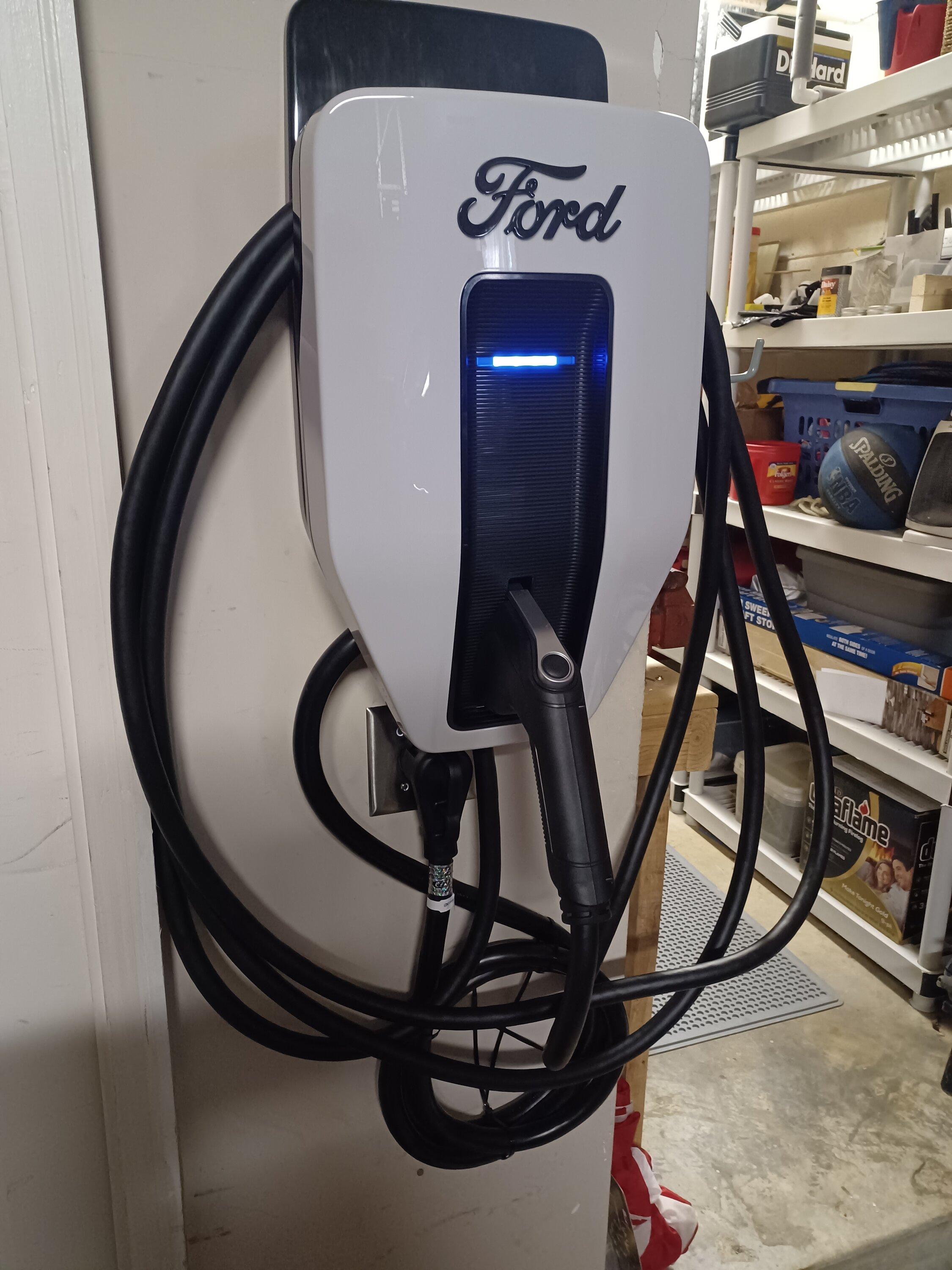

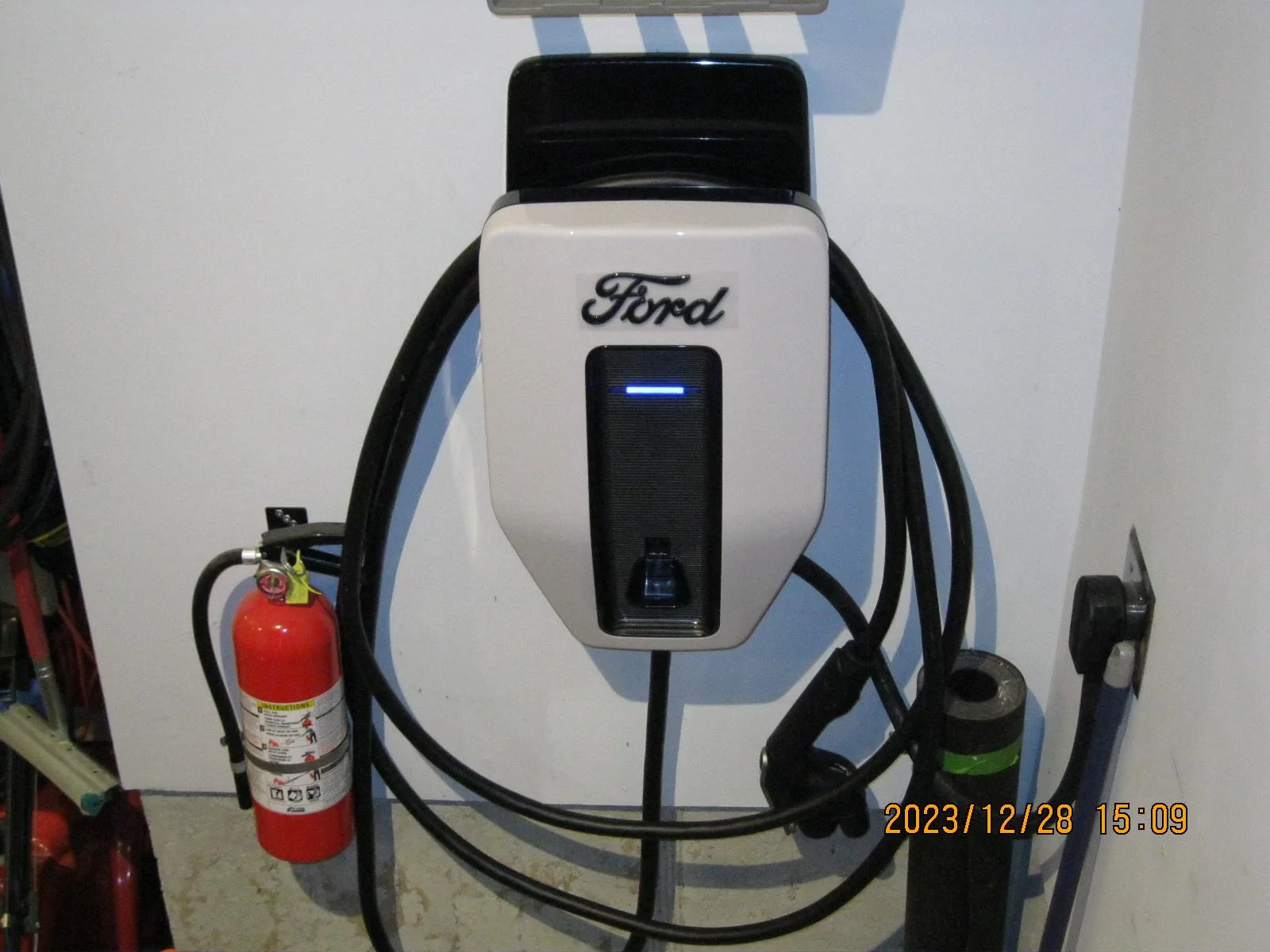

Here is a picture of the charger for reference.

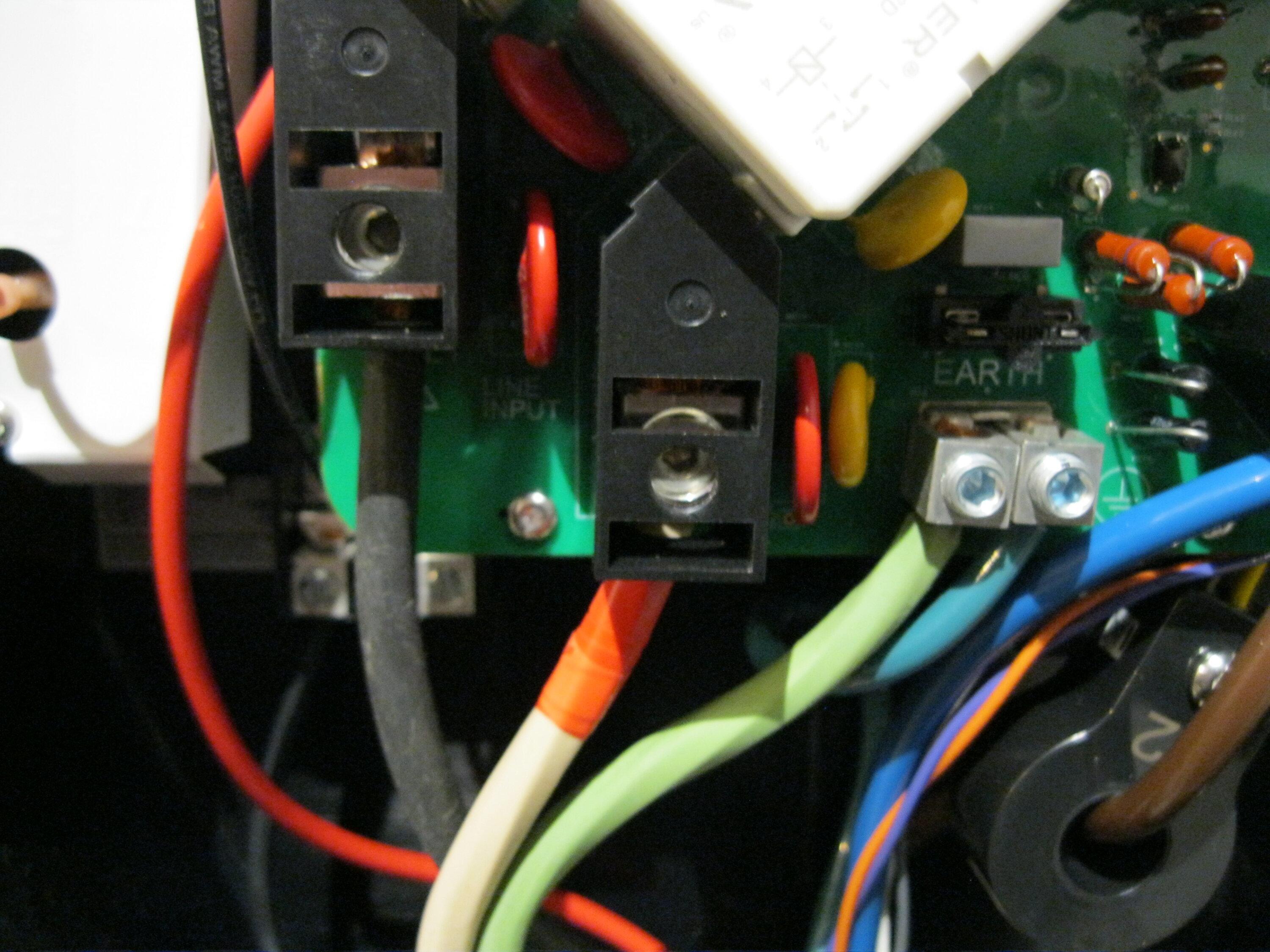

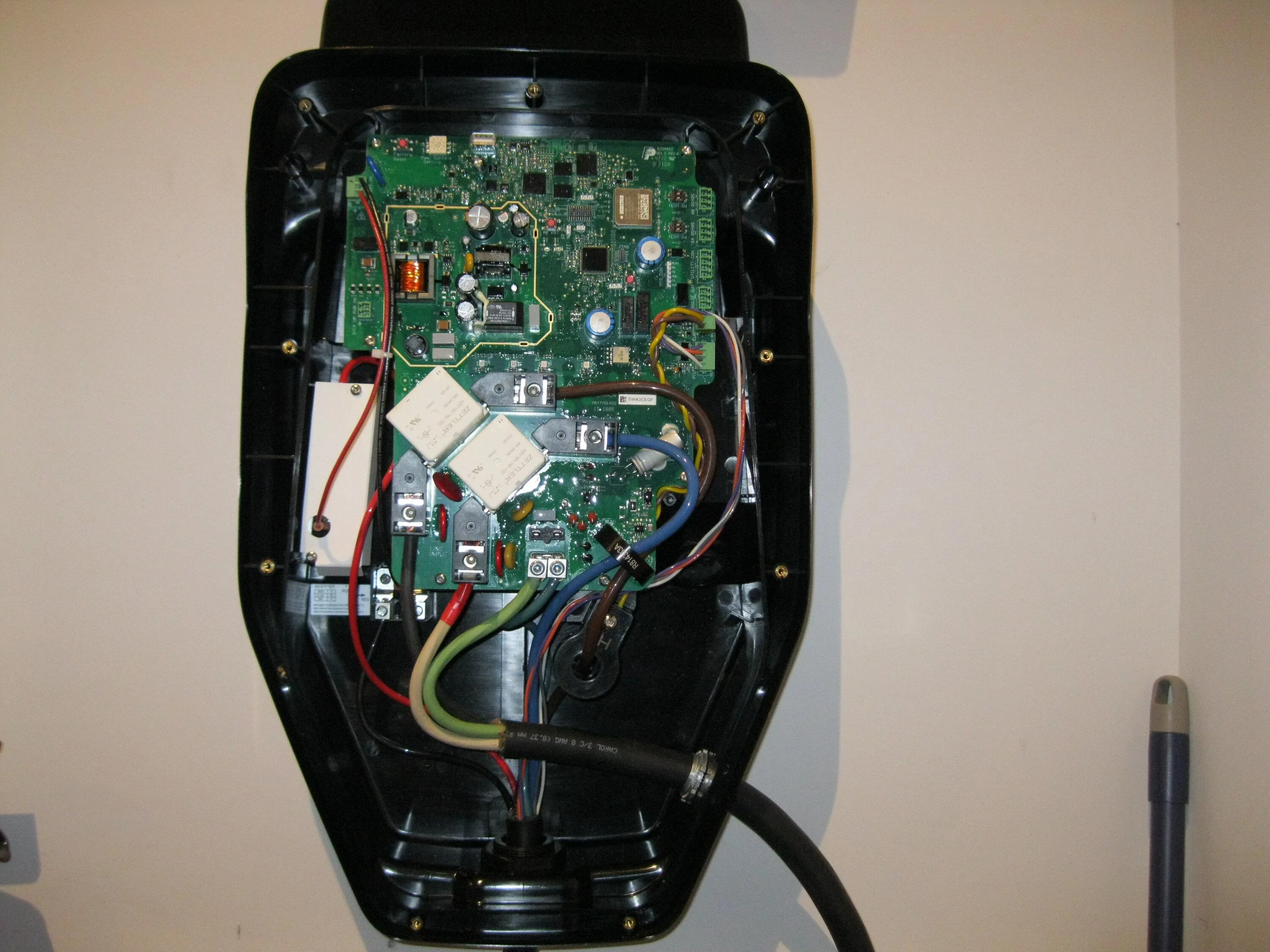

I have set up my FCSP like @JRT . I used 6/2 wire from my electrical panel to a 6-50R receptacle with a 50 amp breaker. I then put together a short 8/3 SOOW Cord with a 6-50P plug on one end and wired it to my FCSP. As you mentioned I then set the limit switch to # 4 so it will only draw 40 amps.
This set up works fine and I have measured the amperage with the truck plugged in and charging to confirm that it was drawing only 40 amps. Attached are a few pictures
