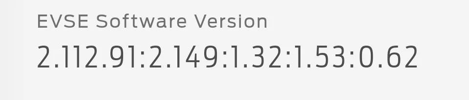

Here's my version

Did you get the firmware update? Ford pushed an update that is supposed to relax the heat threshold a bit and it did make a difference. It should get it aftera power cycle, then leave the FCSP unplugged overnight.
Here's my version
I'm at the same version in FordPass. Interesting though, if I go into the FCSP app, station settings, select about the software version is at the top of the list and it is different. It is the same up through ...1.32: then it's :0.62:1.53. Same numbers different order.
185
13,812
14,877
That's normal, they all display the same way.

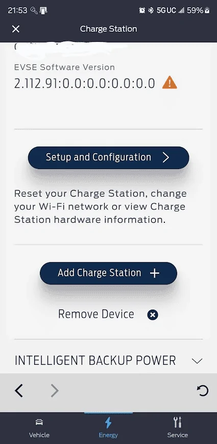

Could you share what your software version level is? Mine has been stuck at this half baked level for months!

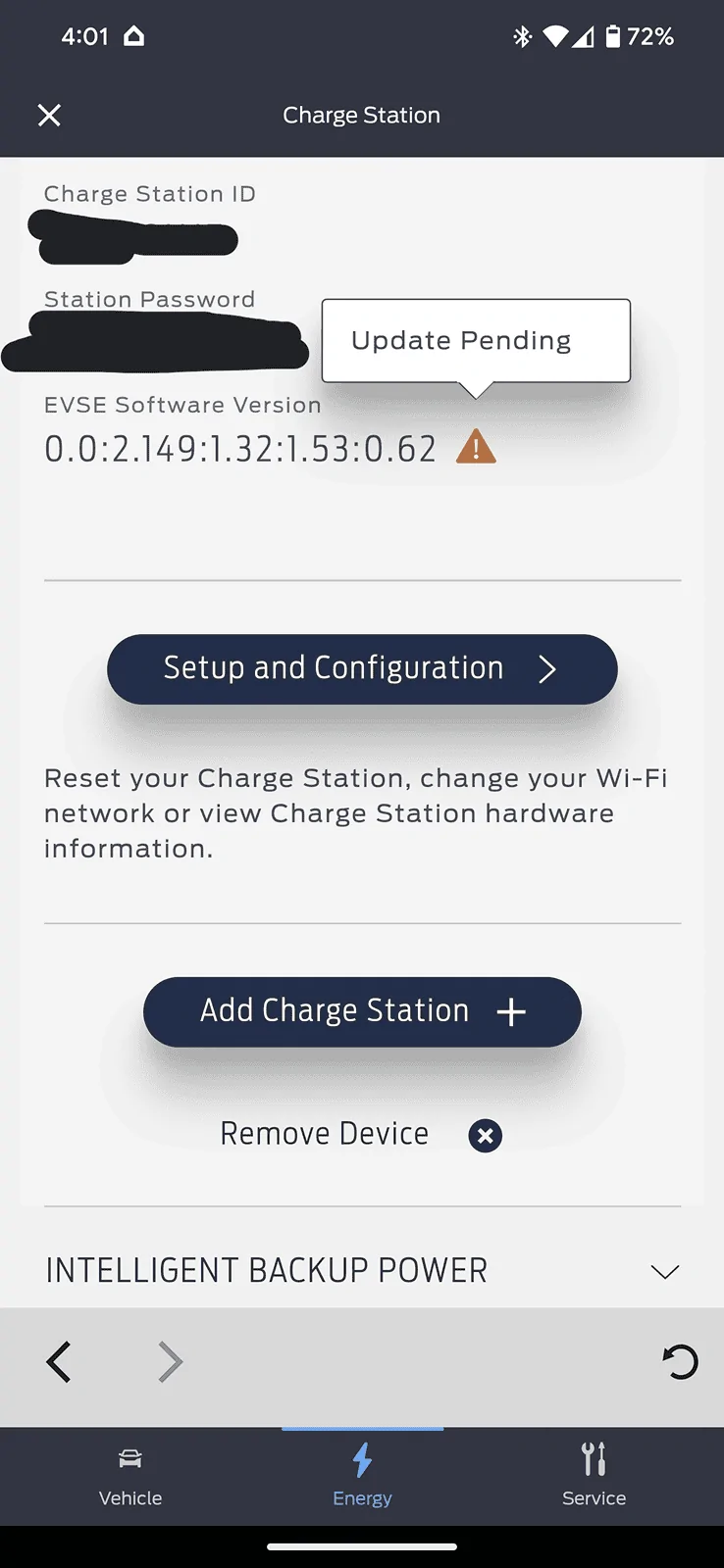

Did you get past this? Now that I see it in FP 5.0, the version is funky, and it has been stuck on "Update Pending" for days.
Nope, mine is still showing the update pending alert symbol and incomplete version number.
I've considered doing a factory reset, but held off after reading several reports that it's failing to reset and then being stuck with a lack of connectivity, wondering if anyone who had that issue gotten past the no RESET situation??
