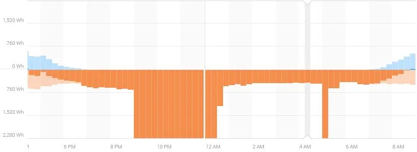

Yesterday I removed the temporary 14-50 outlet I installed three weeks ago and installed my FCSP. Went without a hitch other than my stud finder could not see the studs through the stucco. Once I had it installed, I plugged in the truck and got the indication of charging at a reduced rate. Looked at the truck and it said it was 1.2 amps. Puzzled, but then it changed to waiting to charge - which is what it should be since at the time I was within the high electric rate on my Time of Use billing. Three and a half hours later, when the ToU rate changed, I was watching FordPass and charge rate ramped up to 10 KW. A little while later I walked out to the truck to look and it said 10.6 KW. That stayed very constant until it reached the target I had set of 60%. The image below is from my solar metering, so negative is what I am drawing from my utility. Each line is a 15 minute segment. The big bump at 0500 was due to preconditioning and warming for a scheduled departure time (although I took a vacation day today because it's my 35th wedding anniversary).
Ford F-150 Lightning Charge Station Pro Installed today - won't charge past 3.2kw/15A FCSP

Update. Last night, I had the 3KW charge rate that this thread is all about. Fortunately I was not in any big hurry, so just let it charge. I will verify the firmware version and attempt to force the update later today.
