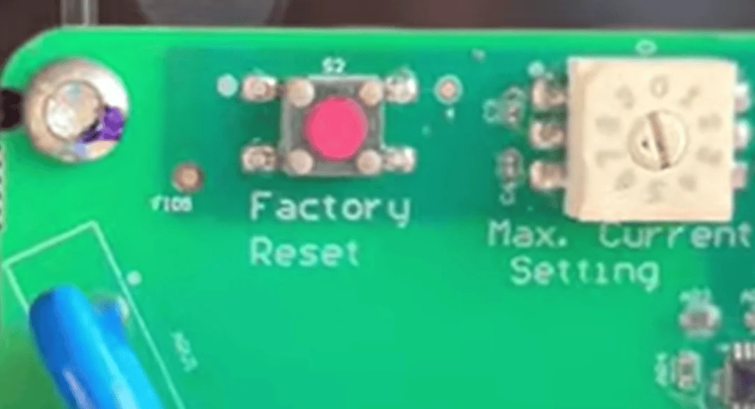

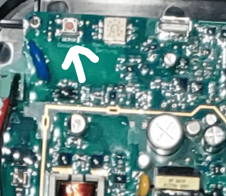

Where is the reset button?

Your FCSP might have stopped making its wifi visible. It typically does this after you connect to it during pairing setup. You can open up the case and hit the reset button to make the SSID visible again. I had to reset 3 or 4 times before pairing was successful.
