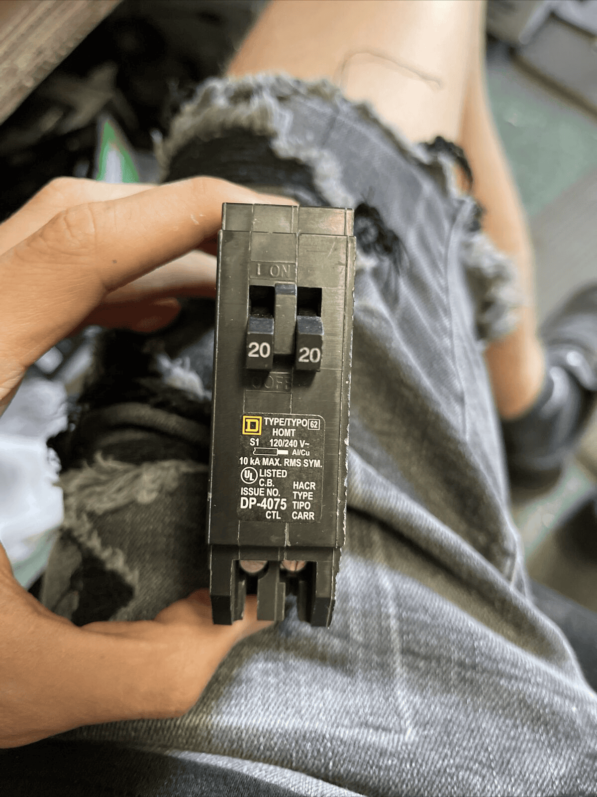

I plan on ordering a Lightning with the bigger battery pack. I wonder how many people with a standard 200 amp service could withstand adding another 240v/80 amp breaker. I am looking ahead and my electrician says I need to add another 100A panel next to my meter (and next to my Generac 22kW propane backup) where I could charge the truck and connect to 24v/80A.
Why? Ask your electrician to install a couple of twin 20's to free up two spaces for the new 80 A. If he doesn't know what a twin is, find a new electrician! (A twin fits 2 breakers into two spaces. While the density is doubled, they are legal and work fine. I used hundreds of them when I was a licensed contractor).
