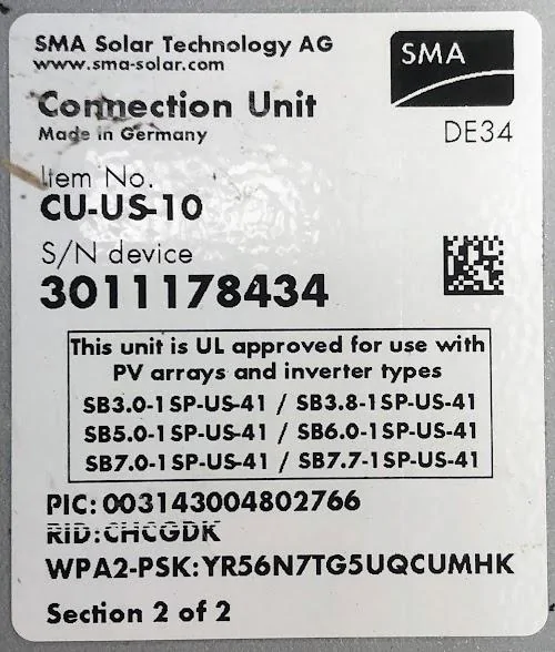

I have a solar panel array connected to an inverter.
Will I be able to use this for the Lightning?
Thank you.
Looks like you have a grid array like I do and if the grid goes down, the inverter shuts the array off. While the grid is alive and the sun is shining your array will feed the truck and the rest of your home before it sends any juice into the grid as per normal operation.
