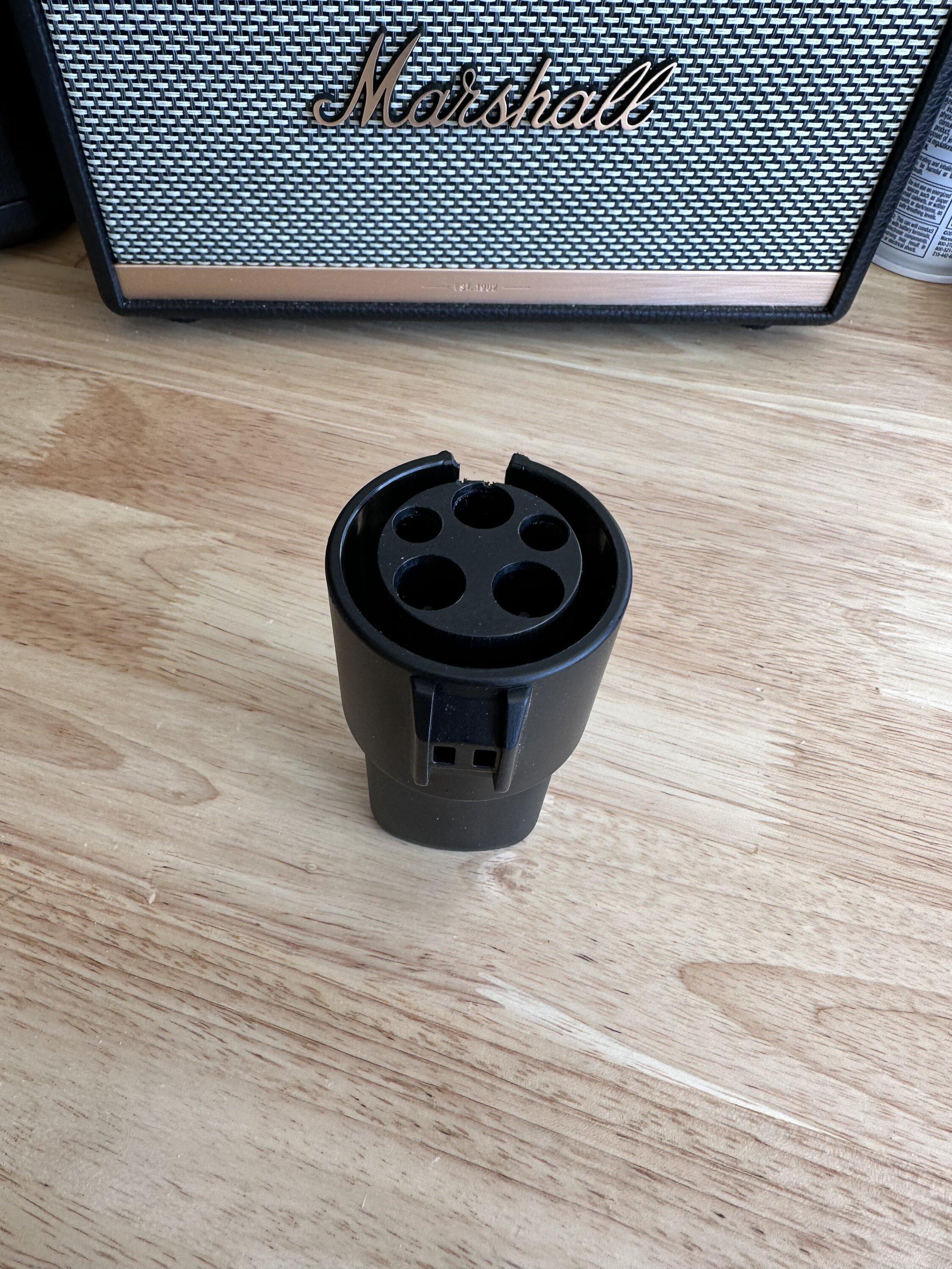

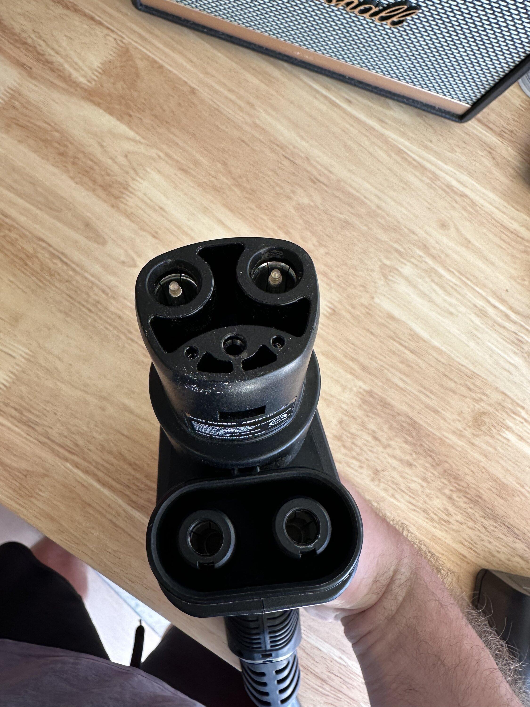

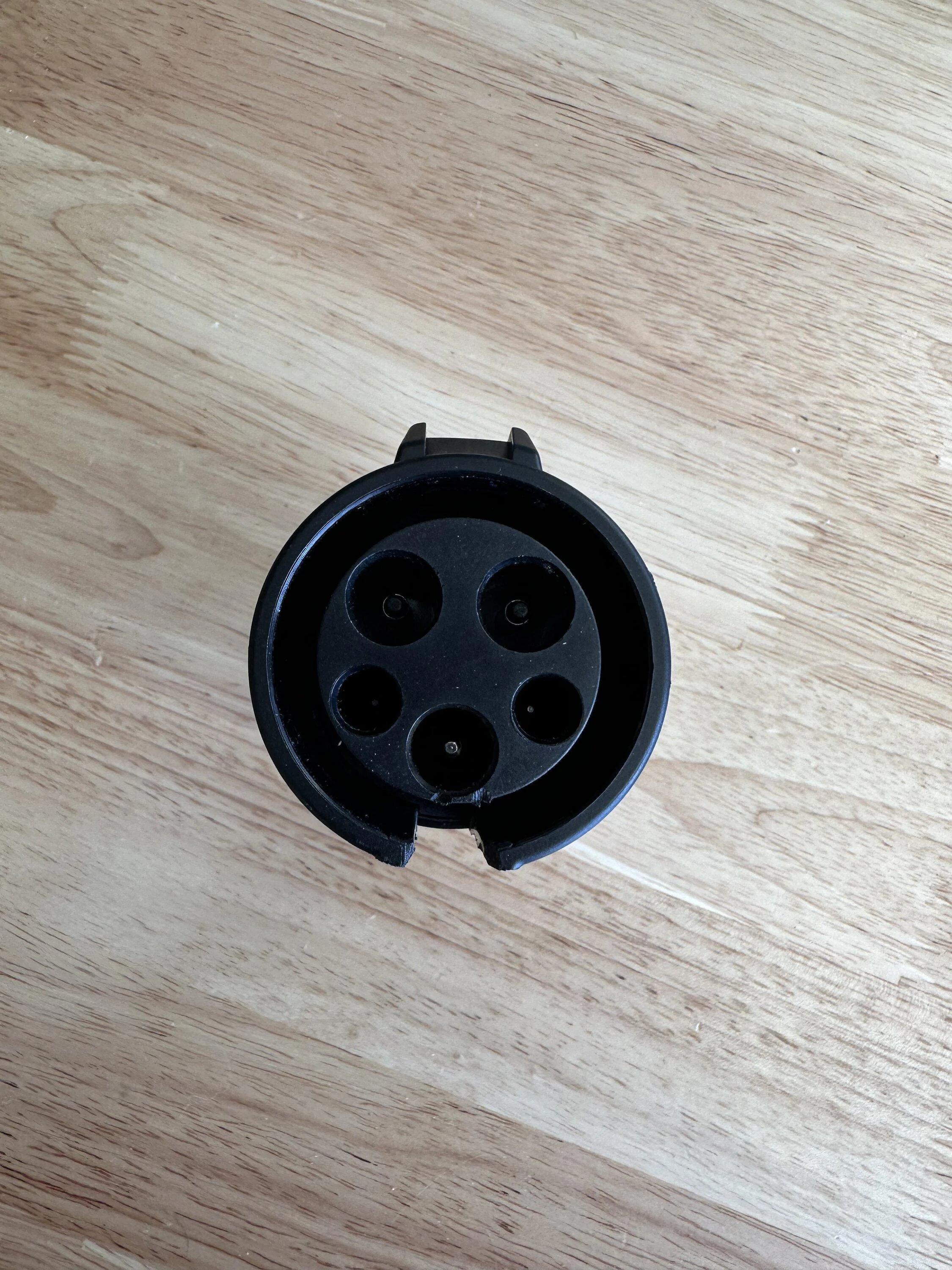

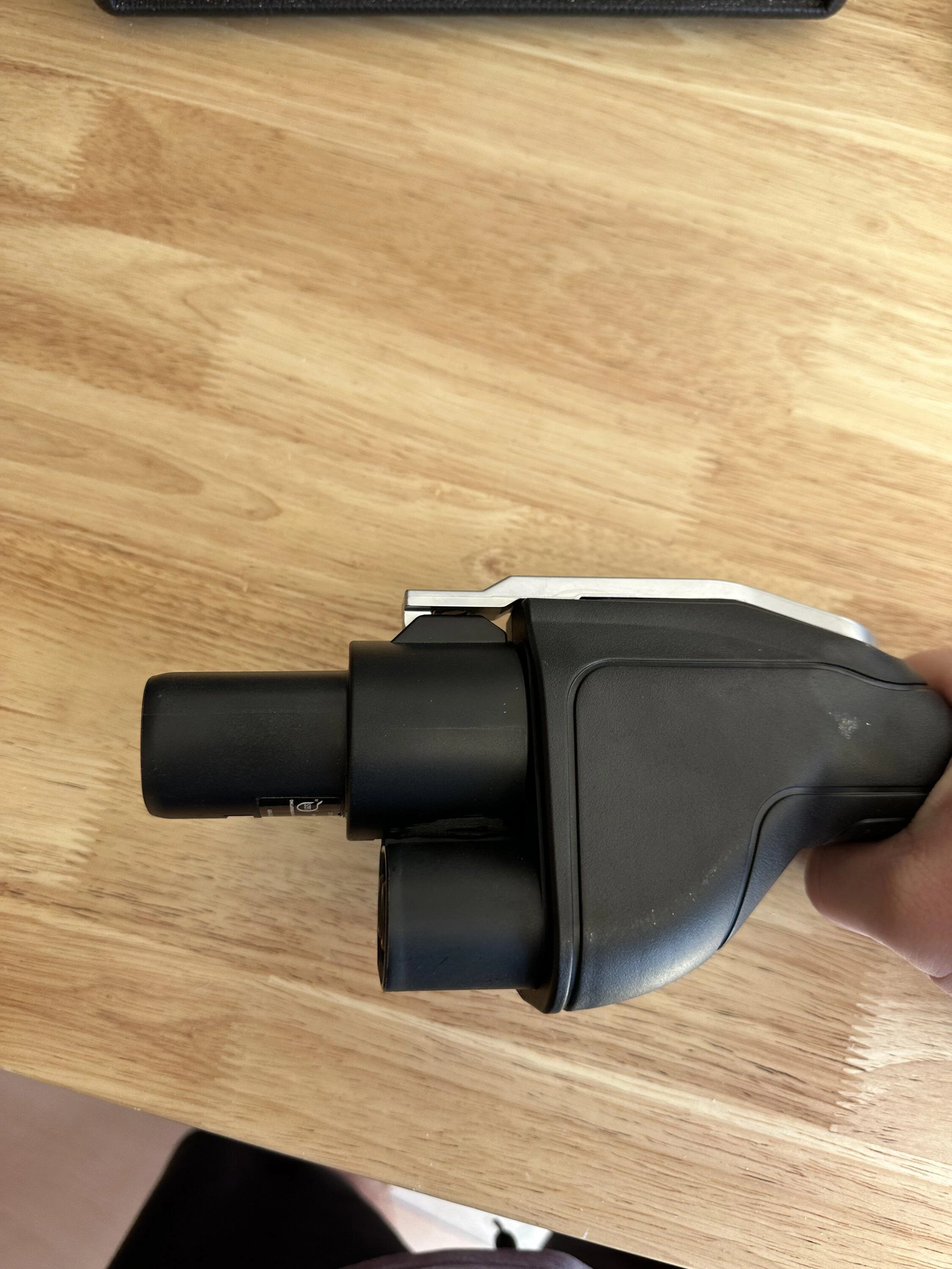

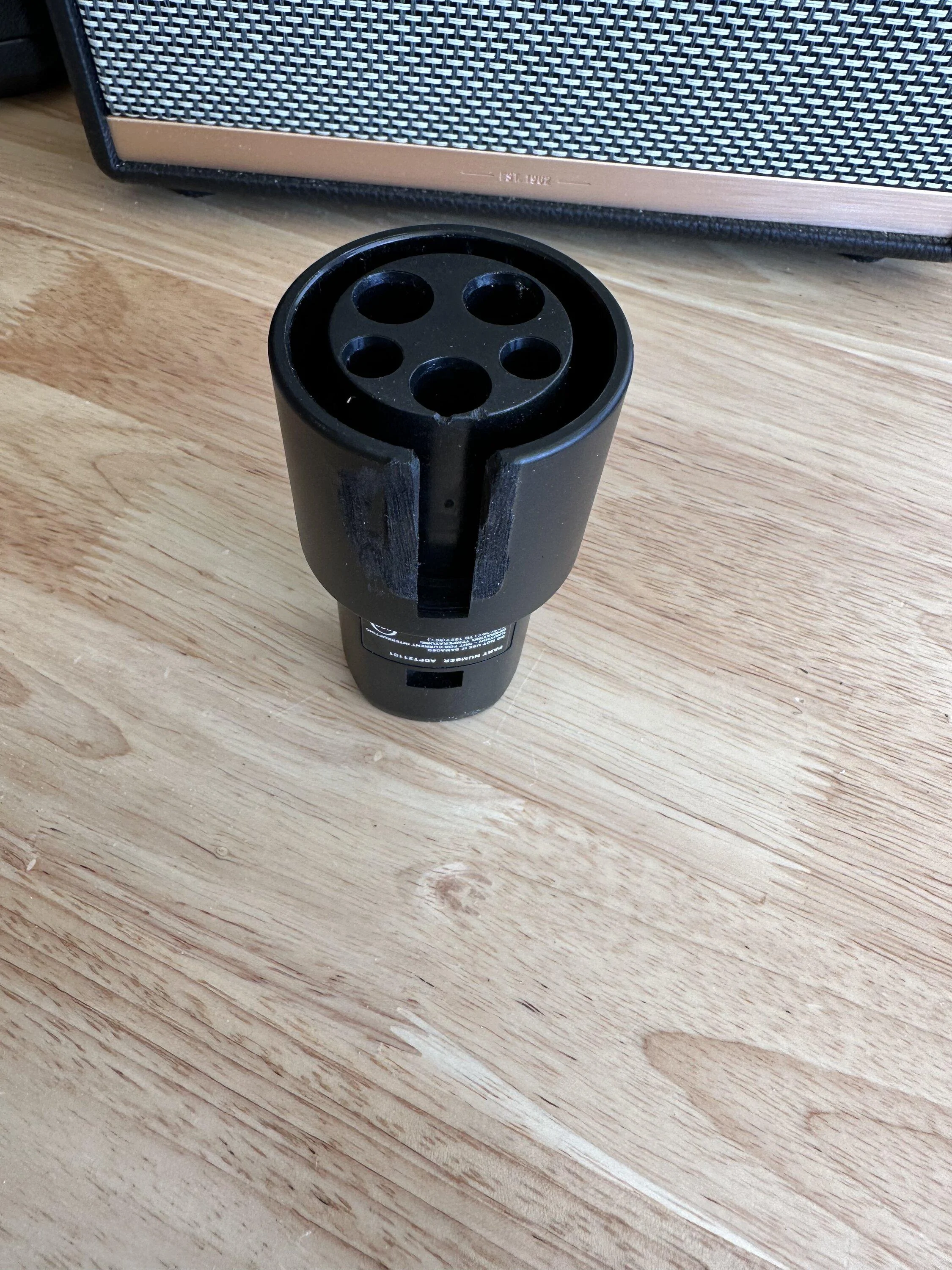

My charge station was installed on Friday. I made the pictures mods to a J1772 to Tesla adapter. This adapter was a cheap one off Amazon (I did not to spend money on a Tesla one if it didn’t work).
After connecting the charger to Ford Pass, I throttled the amps down to 40. I connected the modified adapter and plugged it in and it worked. I tested it all the way up to 80 Amps and had no issue as the Model Y throttled the charge going in to 48 amps.
