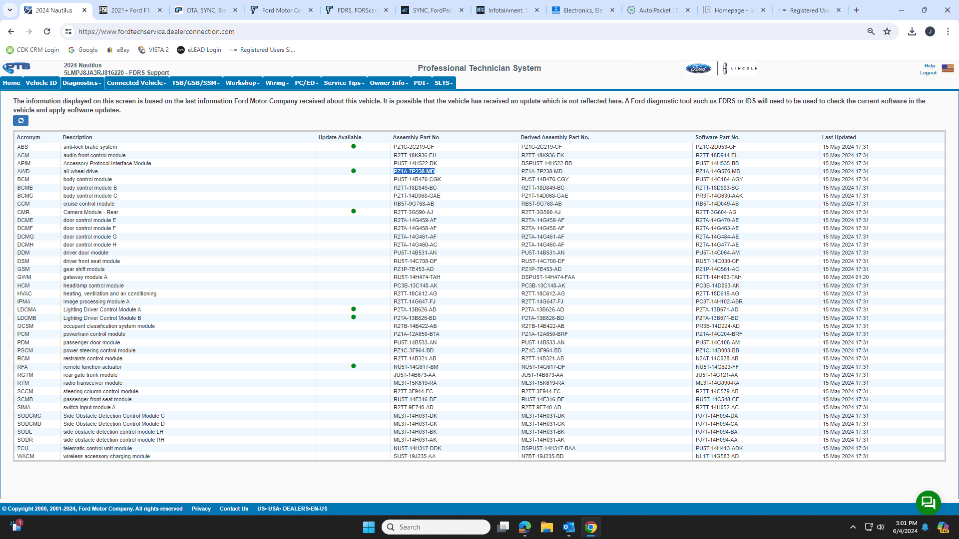

It sounds like Farley is saying (here) that is what they are planning to do for next gen. Of course this was 11 months ago. Things may have changed.
Yea, but that does not seem to be coming any time soon. Screenshot below is of a 2024 Nautilus that shipped with the new Android system. The part numbers listed here are pretty much the same as the modules in other vehicles in Ford's line-up. They are still being updated using the same OTA system the Sync vehicles are updated with.
If anything, it will be for the next next gen and depending on well Android Automotive works out for them, they may keep it or they may design their own UI from the ground up.
