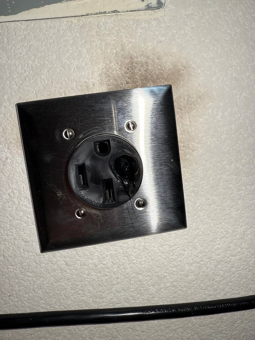

One thing to keep in mind if you go with the plug is you need to make SURE that you get a high quality NEMA 14-50 socket that is rated for continuous duty, not the $10 big-box special. I paid about $50 for my socket alone from Greybar and that was with my brother-in-law's commercial discount. Your vehicle will be drawing a full 40A for many, many hours and heat will be generated at the connection point.
You do not want this to happen to you:
Ford F-150 Lightning Ford Power Promise – Take the charger/install or the money/discount? Melted NEMA 14-50
