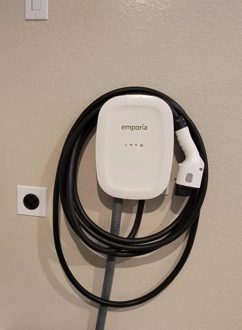

No. I also have a Mach-E on order. I hardwired an Emporia 48 amp charger and installed a NEMA 14-50 before I got my Lightning.
Ford F-150 Lightning Ford Pro Charging Station vs. Nema 14-50 outlet Screenshot_20221004_140228
I'm going to install my FCSP this week. I sized up the conduit on my hardwire install so I can pull #2 THHN for the FCSP and I'll put the 14-50 cord back on the Emporia, plug it into the receptacle and derate it for the Mach-E.
