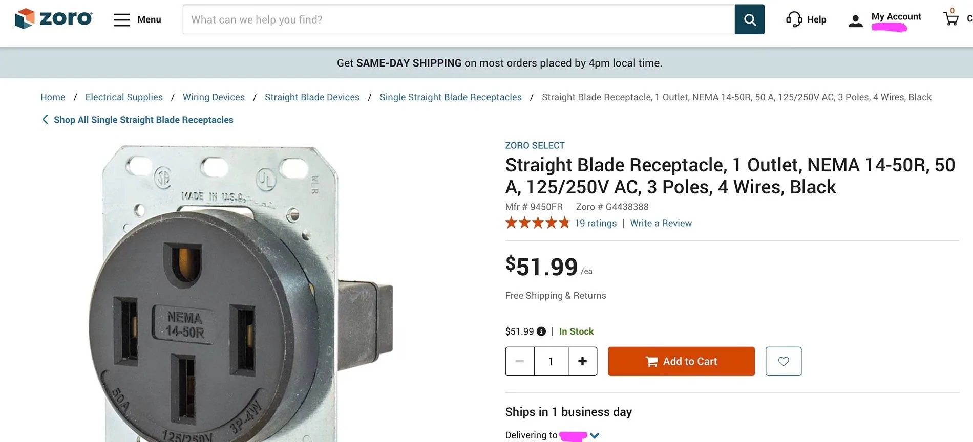

Great advice to buy a Midwest Outdoor box and modify it for a Hubble 9450A receptacle.

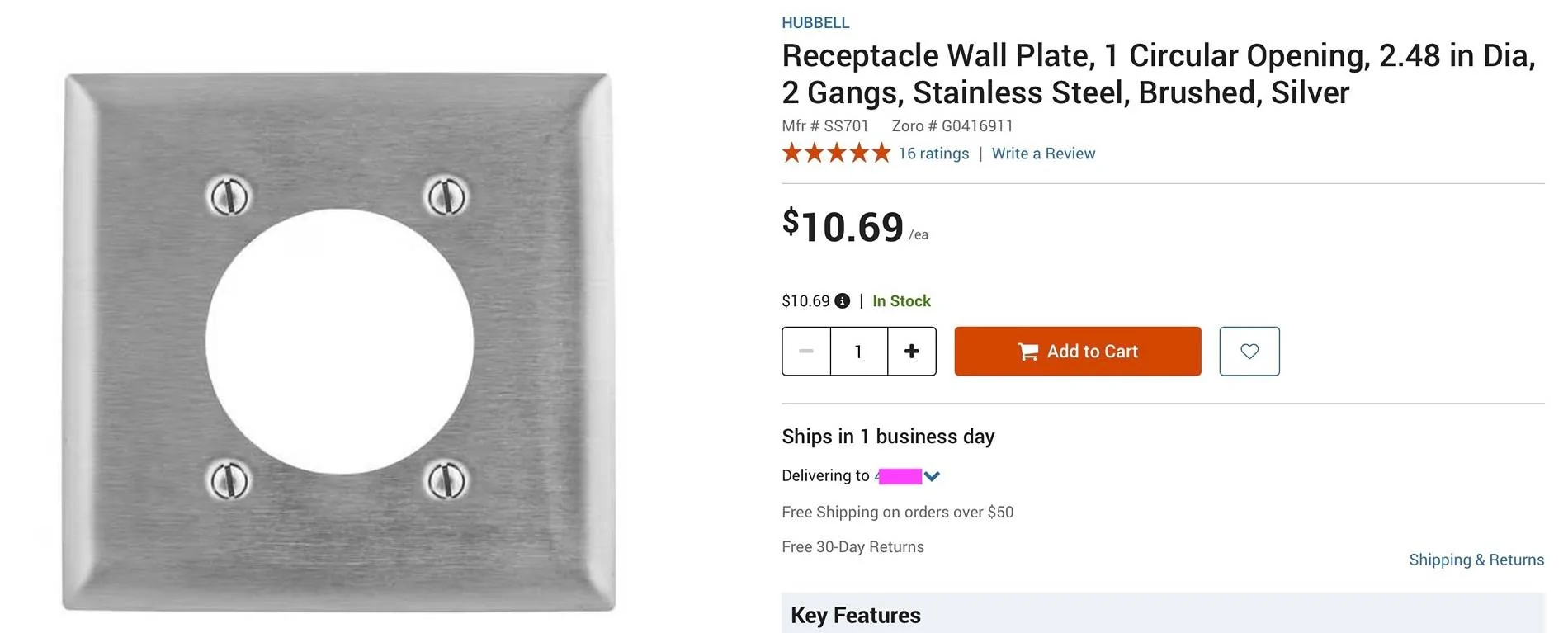

Agree with the recommendations to use a Hubbell or Bryant 9450 outlet. They have heavy duty connectors and are designed for constant long loads. You may also need a bit larger cover (depending on outdoor box used) since these are just a bit bigger round than the normal use outlets.
Zoro sells them but they are available at many places.

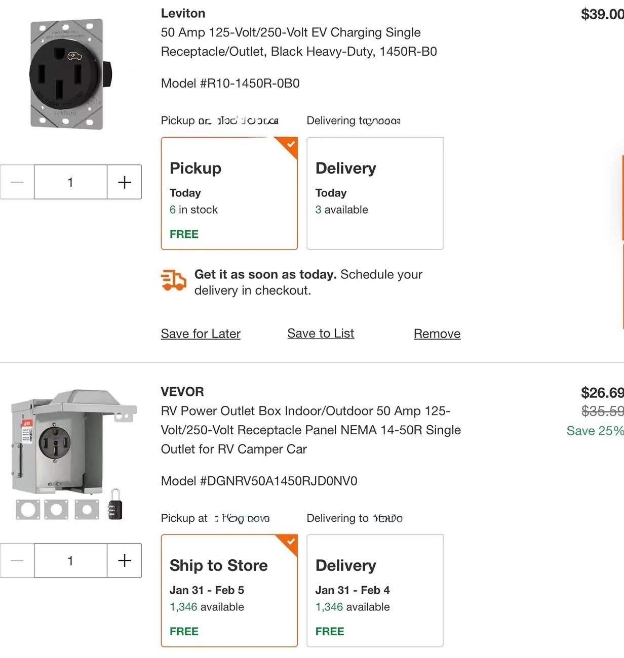

Thank you fellas. If I hadn’t asked about this here in the forum, I would have definitely bought the cheap outdoor box from Home Depot and the electrician at camp would have no idea that the plug wasn’t intended to EVs. And my camp is a is a tinderbox…

That’s what I did! You can buy an outdoor 14-50 weather box and you also need a EV rated 14-50, sold at Home Depot . You should buy the receptical and box, most electricians are still clueless about EVs. The EV 14-50 has a larger diameter socket than a regular, make sure it fits the box!
I’ve had this Leviton EV 14-50 in my garage for six months now with no problem. I would suggest a 50amp breaker, that would give you a 40amp maximum for the evse. The Ford chargers are not known for reliability so you will probably end up buying an after market 40 amp. Most just keep the Ford evse as a spare.
