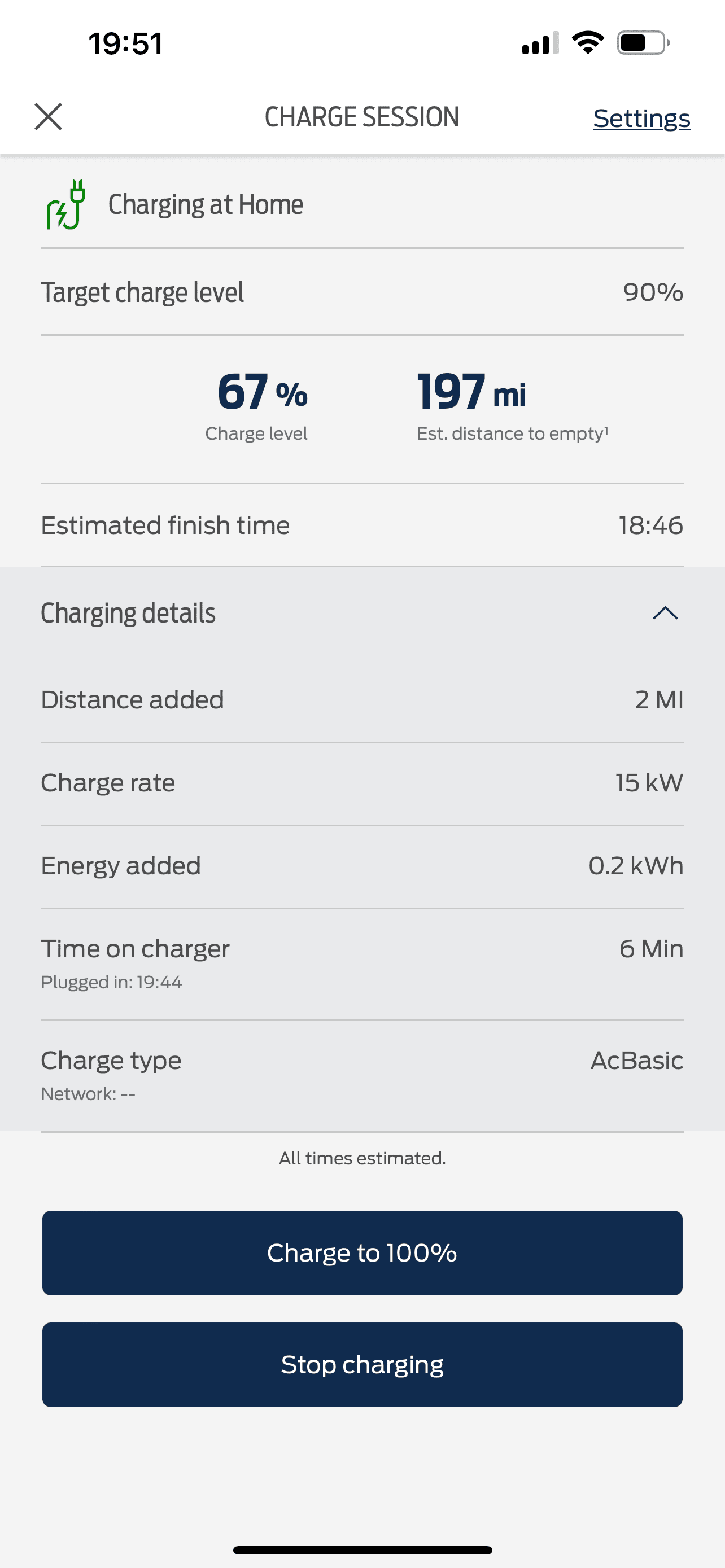

I’m having the same issue. It’s 7:50 pm and my charging time says it’ll be completed an hour ago while at 67%.
worst part is I just plugged it in.

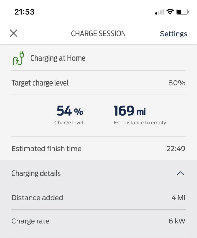

Same - app update 4.27 completely broke the estimated completion time. It thinks I’m going to be able to go from 54% to 80% in an hour using a 6kW mobile cord 😂

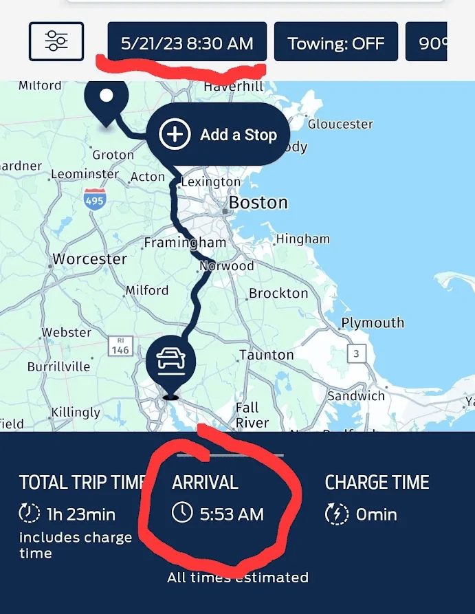

Departure time, route scheduling has a bug, the arrival time is not being computed correctly, my trip is projected to be about 1 hour 23 minutes (accurately), leaving at 8:30, I anticipate arrival around 9:53 not 5:53 am

Good morning- I can look into this for you. Feel free to send over a private message with your VIN and dealership information at your earliest convenience.
Unless my dealer has application developers in the accounting office, I don't think they are going to be much help, this is a APP issue, truck is fine.
Looks like same -4 hour offset bug that’s in the charging completion time calculation.
Hello! Send us a private message with your VIN and the name and location of your local Ford dealer. I’d be happy to see what I can do to assist with this charge concern. Thanks!
