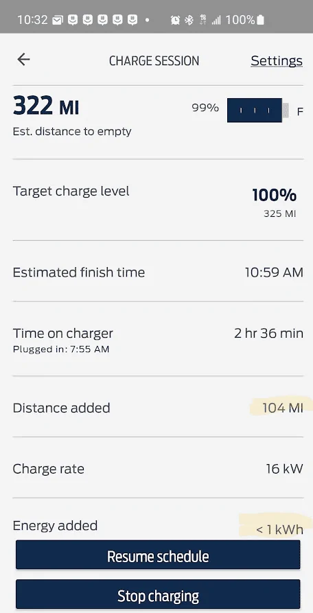

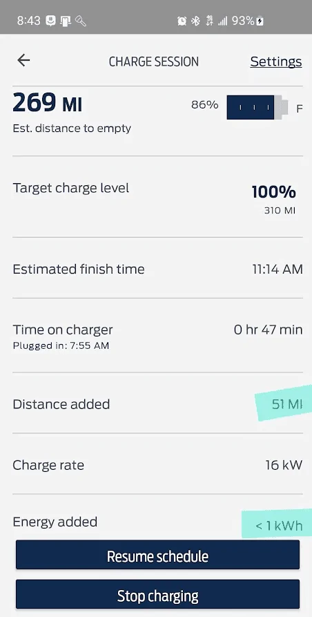

Noticed another oddity, the energy added is not tracking correctly on this charging session.
I'm preparing for a long day of travel, bumping to 100% this morning, the trucks has been on the charger for a while, adding 51+ miles of range but energy added is not correct at <1kw

Being accurate with this would put Ford at odds with all their other inconsistencies.

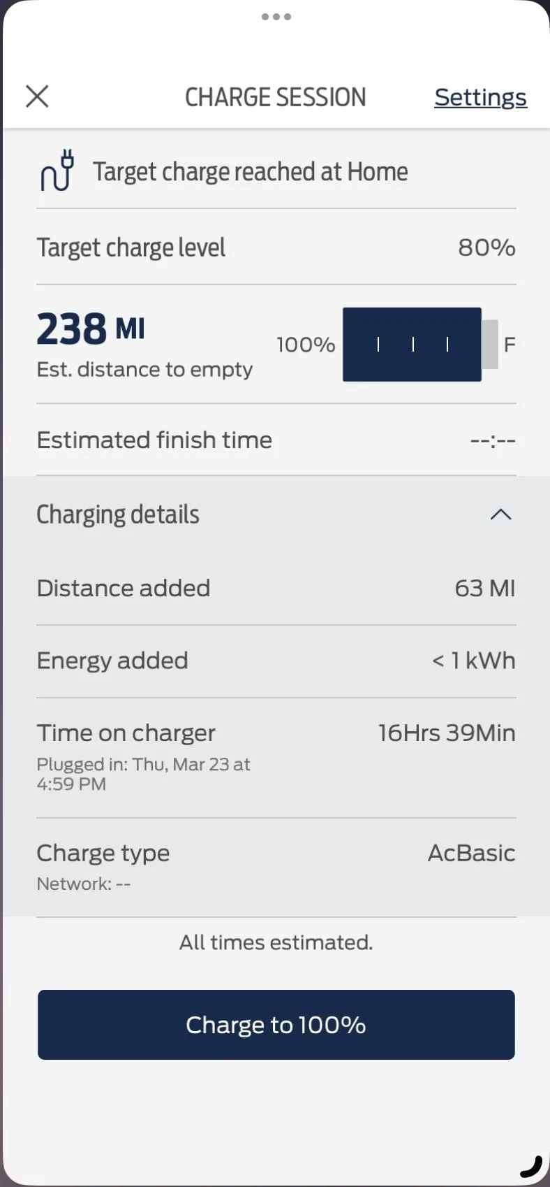

Same here. Headed out on a trip this morning so I charged to 100%. I never saw the rate show up and now itโ€™s giving me the <1 kWh. My Autel charger app shows 27 kWh.

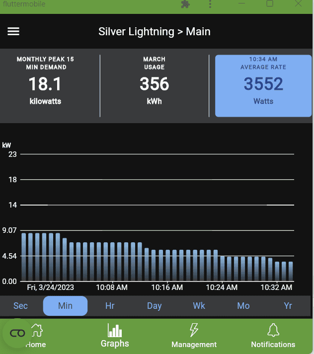

This is what it is actually drawing at the moment..... ~3.552KW
Total so far is 36.9 KWH

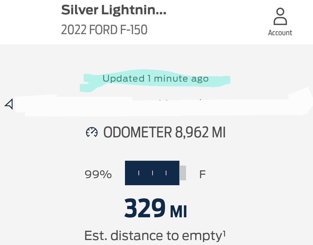

Positive improvement..... the swipe to update/refresh seems faster now at around 8-10 seconds !

So you can refresh more often and see inaccurate information more quickly? Cool!

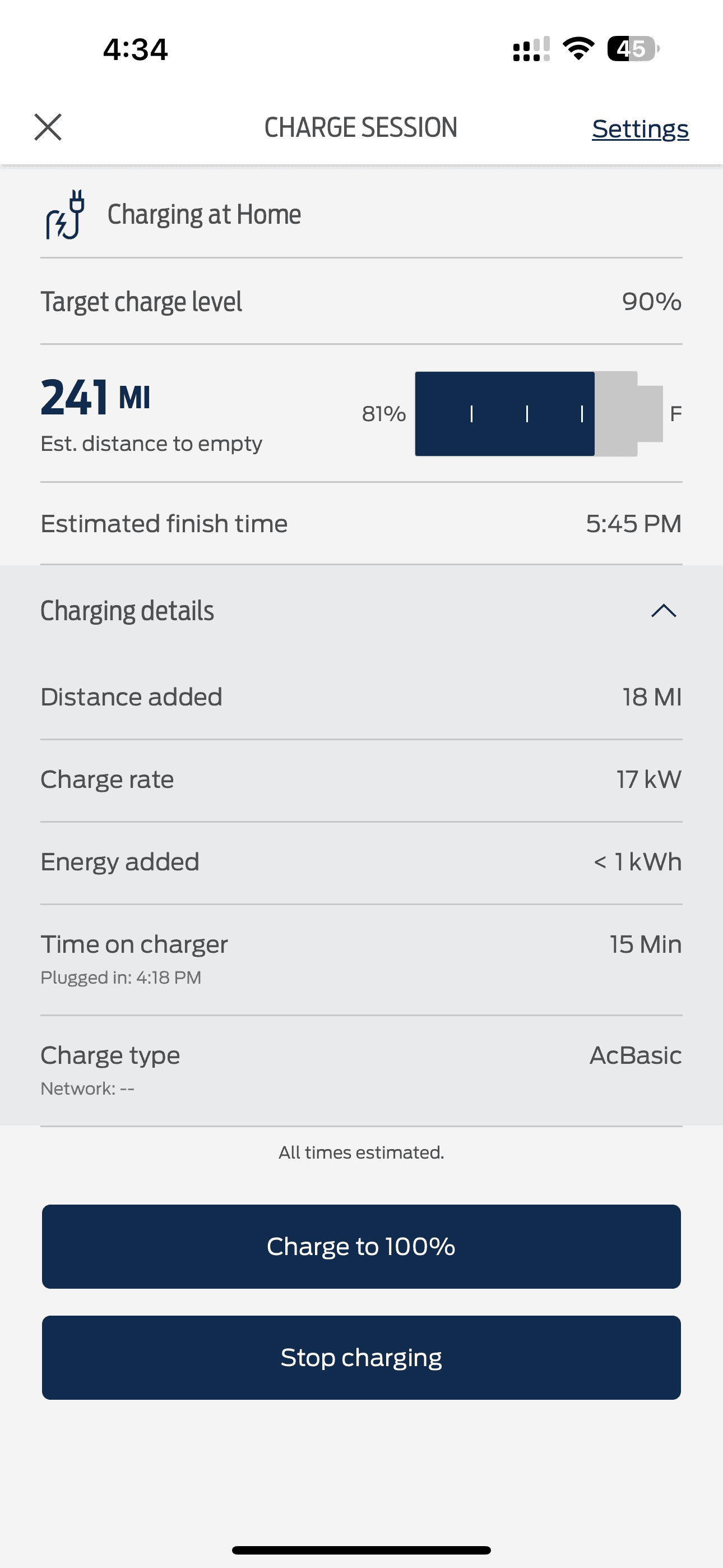

My FCSP is pulling around 70A (17kW) right now.

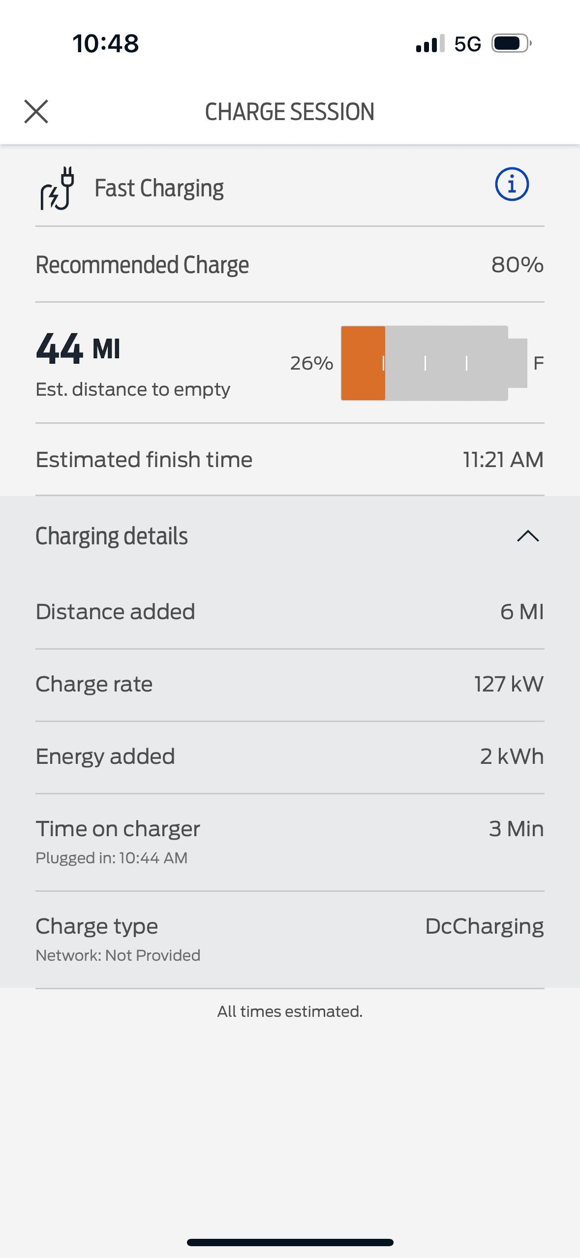

My app is showing 127kW while the ABB DC unit is showing 130kW while having the heater on at 64 with 37 ambient.
They are measuring the power in two separate places. So there is wire resistance and power electronics contributing to the difference. On an AC system the efficiency is around 10% loss. Seems 130 to 127 for DCFC is pretty reasonable. Also likely some rounding and meter precision contributions.
