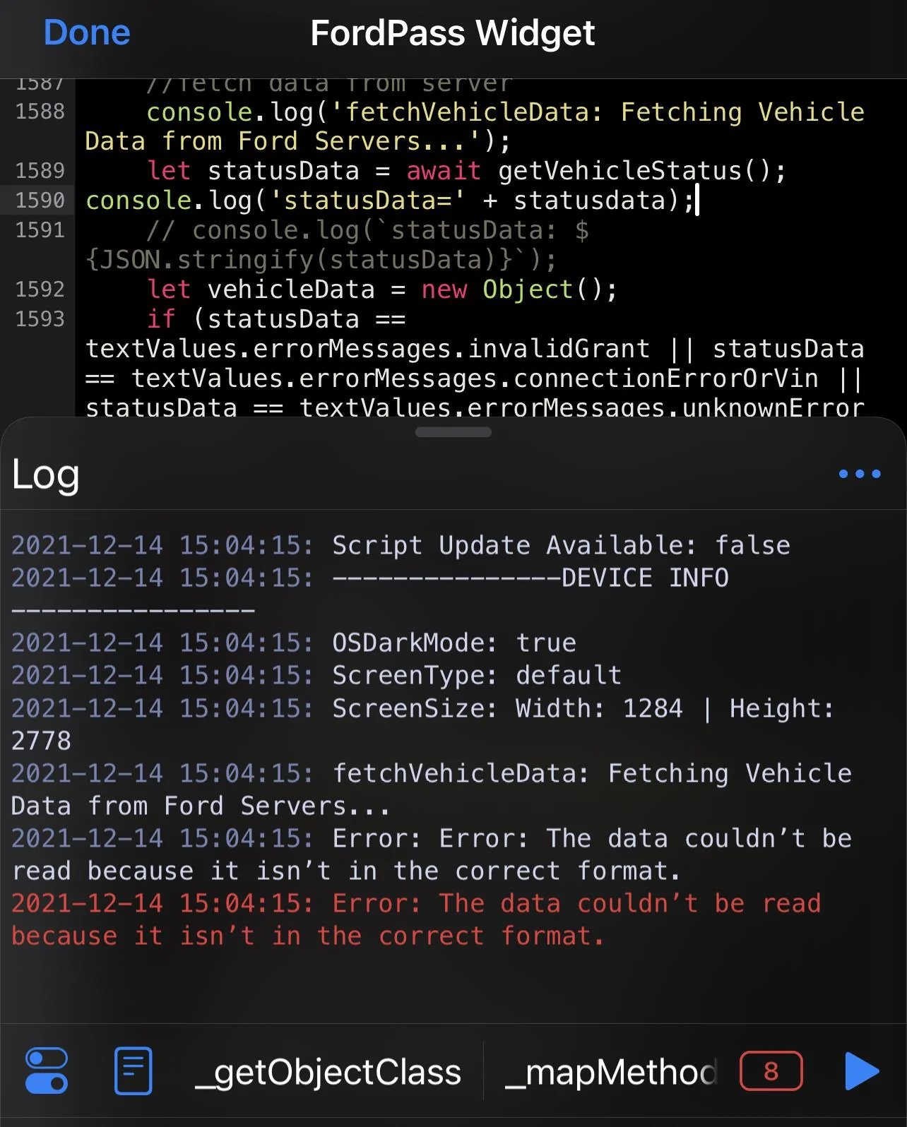

same result with no more usable data available in the response. See 1590 where I spliced your codeIt's tough to see what's going wrong for you guys based on the screenshots. Try this:
1. make sure you're using @tonesto7 's latest version, 1.1.1
2. on line 1590, put this:
console.log('statusData=' + statusData);
3. while you're on the Scriptable screen where you pasted in the code, in the lower right, touch the run symbol (triangle)
4. then touch the number in the box just to the left of the run symbol to show the console output. (should be a number between 1 and 5, with a box around it)
That error you're seeing means whatever Ford sent back to you is something other than your truck's status data. Share what you find here. It could be a failure to use your login info, but it might also be something like your account is locked.

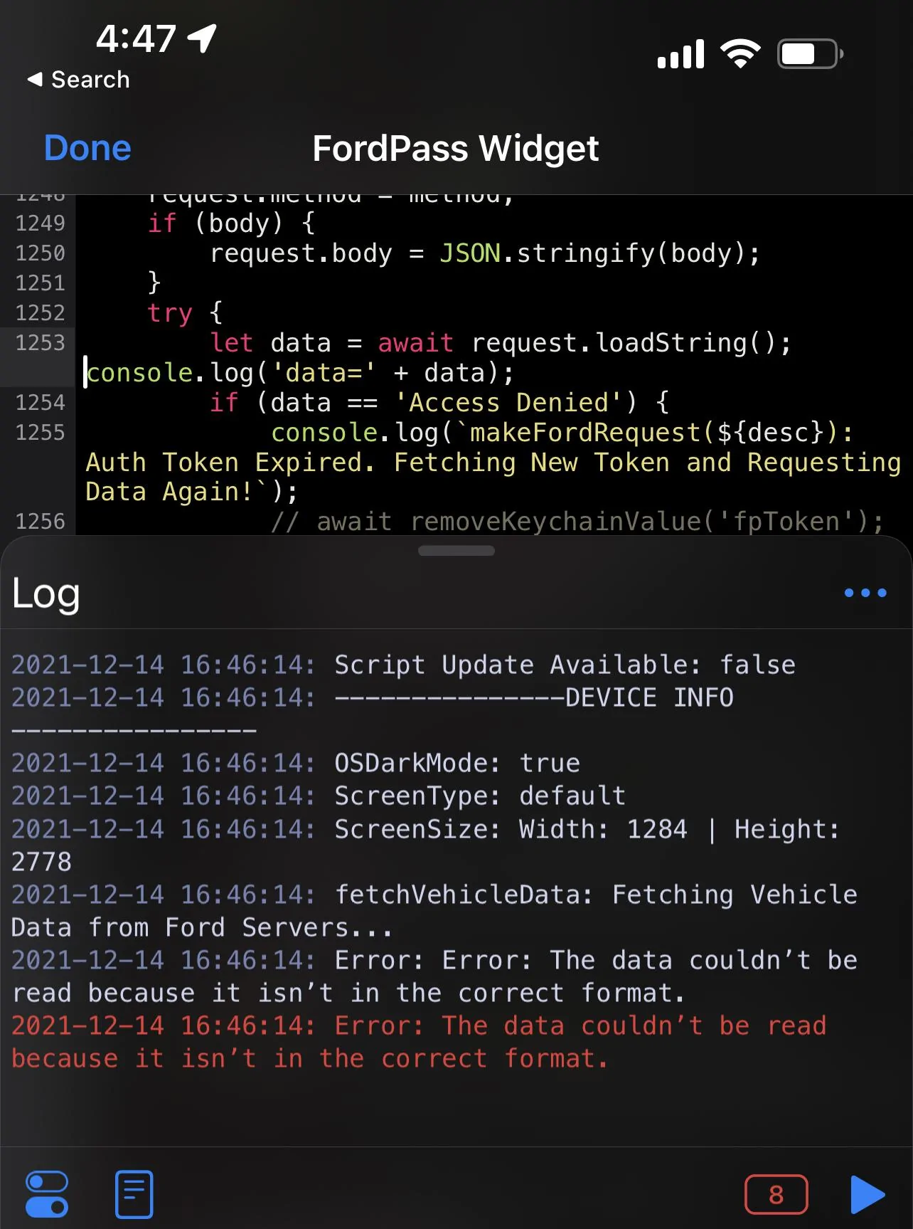

Still same result, am I pasting in the code as you wish? Unsure if I can put two semicolon'd items into the same line? Or do you want console.log('data=' + data); on line 1254?Hmm, interesting. It looks like the issue for you is coming from line 1253. Try replacing line 1253 with this and see what the console says:
let data = await request.loadString();
The rest of the script will blow up, but you should get some good console info. Undo the changes after you see what's in the console.
