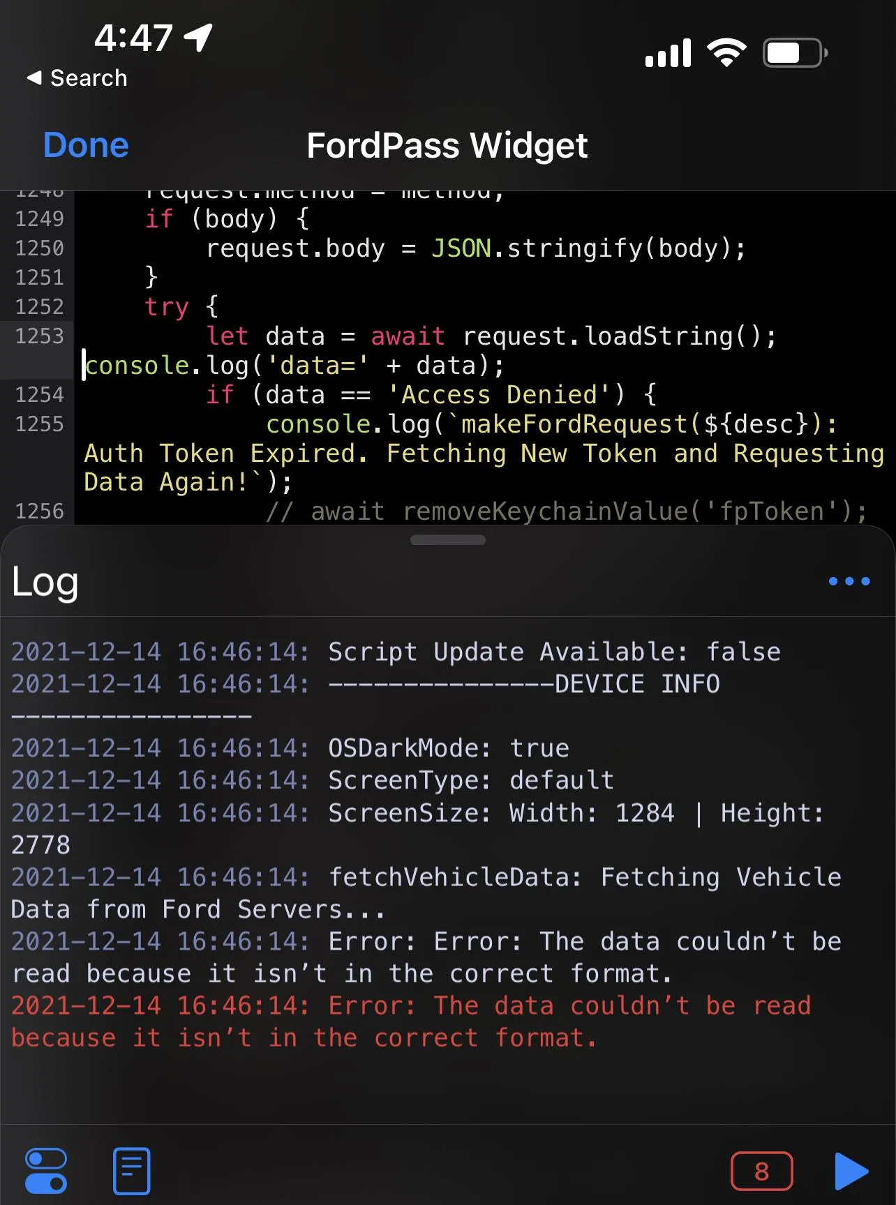

Still same result, am I pasting in the code as you wish? Unsure if I can put two semicolon'd items into the same line? Or do you want console.log('data=' + data); on line 1254?
Huh. Yes, what you put was fine. Troubleshooting via forum through the Scriptable app is a lot of layers of difficult :ROFLMAO:
What @tonesto7 is doing in the script where it's failing for you is pretty straight-forward. It's just making a call to https://usapi.cv.ford.com/api/vehicles/v4/${vin}/status. By that point in the script, it thinks your login went fine.
Ok, try this. Put everything in the script back to the original from tonesto7. Then replace line 1243 with this:
'auth-token': '`${token}`',

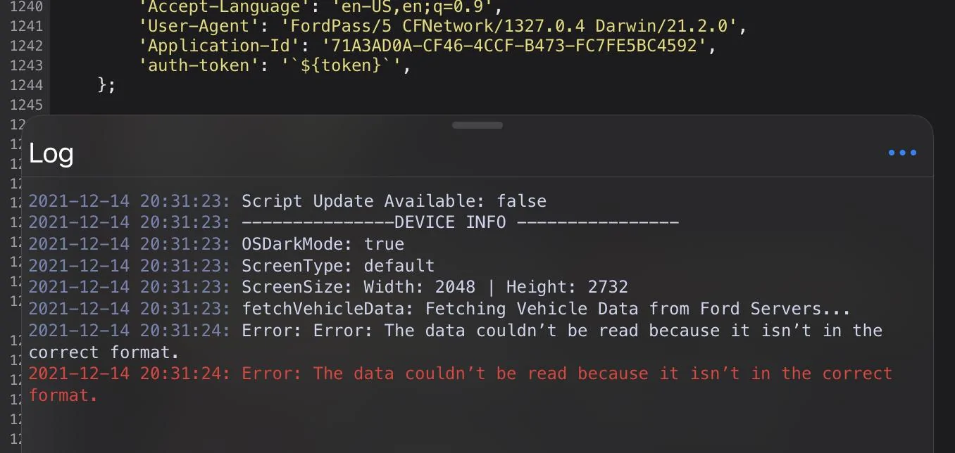

It’s never fun troubleshooting unless you’re right there! Still nothing with the changes :(

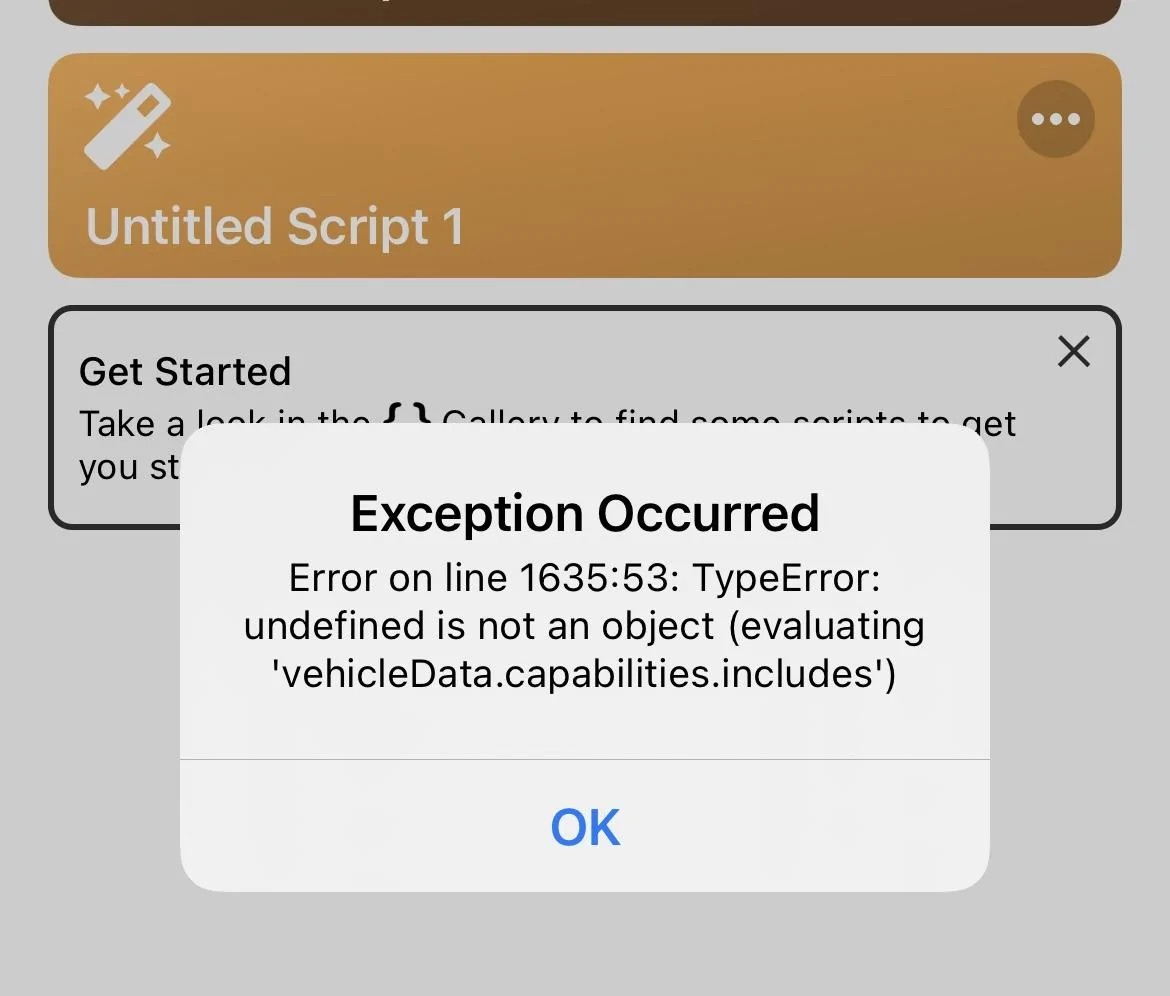

I am CLEARLY not an intelligent person when it comes to widgets. I erased everything and started from scratch with new version. Now I'm getting this.
That may well be due to the problems that AWS is experiencing this morning.
The app has been working perfectly for me and I got this same error briefly this morning.
