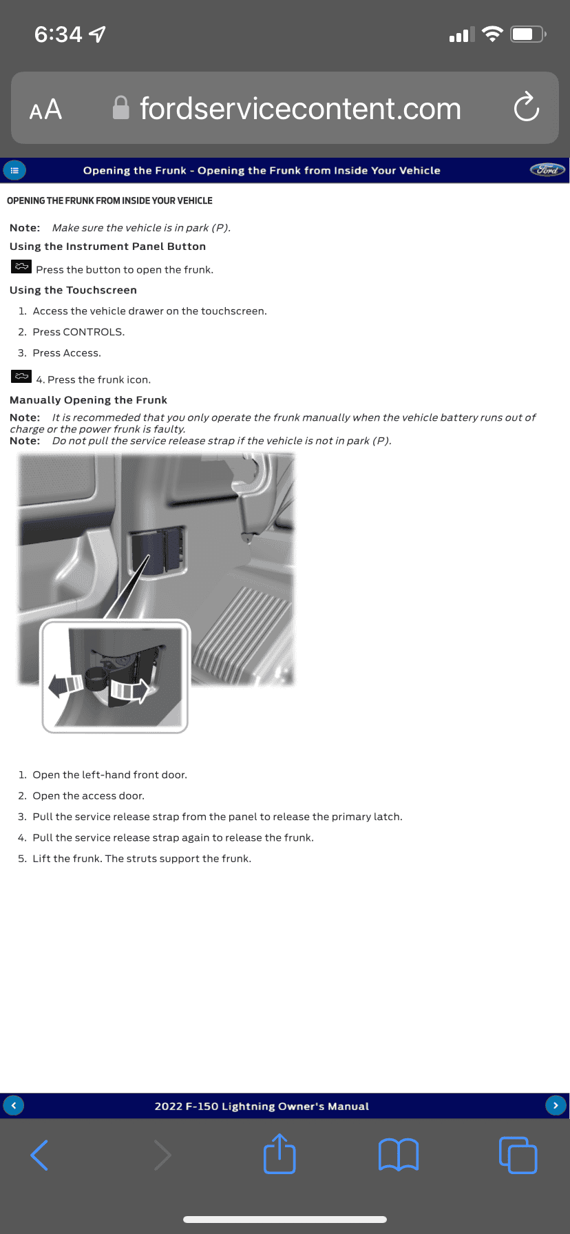

I would not reset your options, but I would try to reboot the center stack. Many commands go through there.
From page 515 of the manual:
You can reboot the center display using the controls on the steering wheel.
1. Simultaneously press and hold the seek forward and audio system power button for 10 seconds.
Tried that one. Didn’t work unfortunately

I saw somewhere that there’sa manual frunk release where a traditional hood release would be under the driver side dash, a red loop looking pull
Yup. Read that in the manual. You can hear it moving something but it has failed to release the secondary latch

The manual release has to be pulled twice. Maybe with a helper pulling up.
I’ve tried it. But won’t hurt to try again. Thanks
