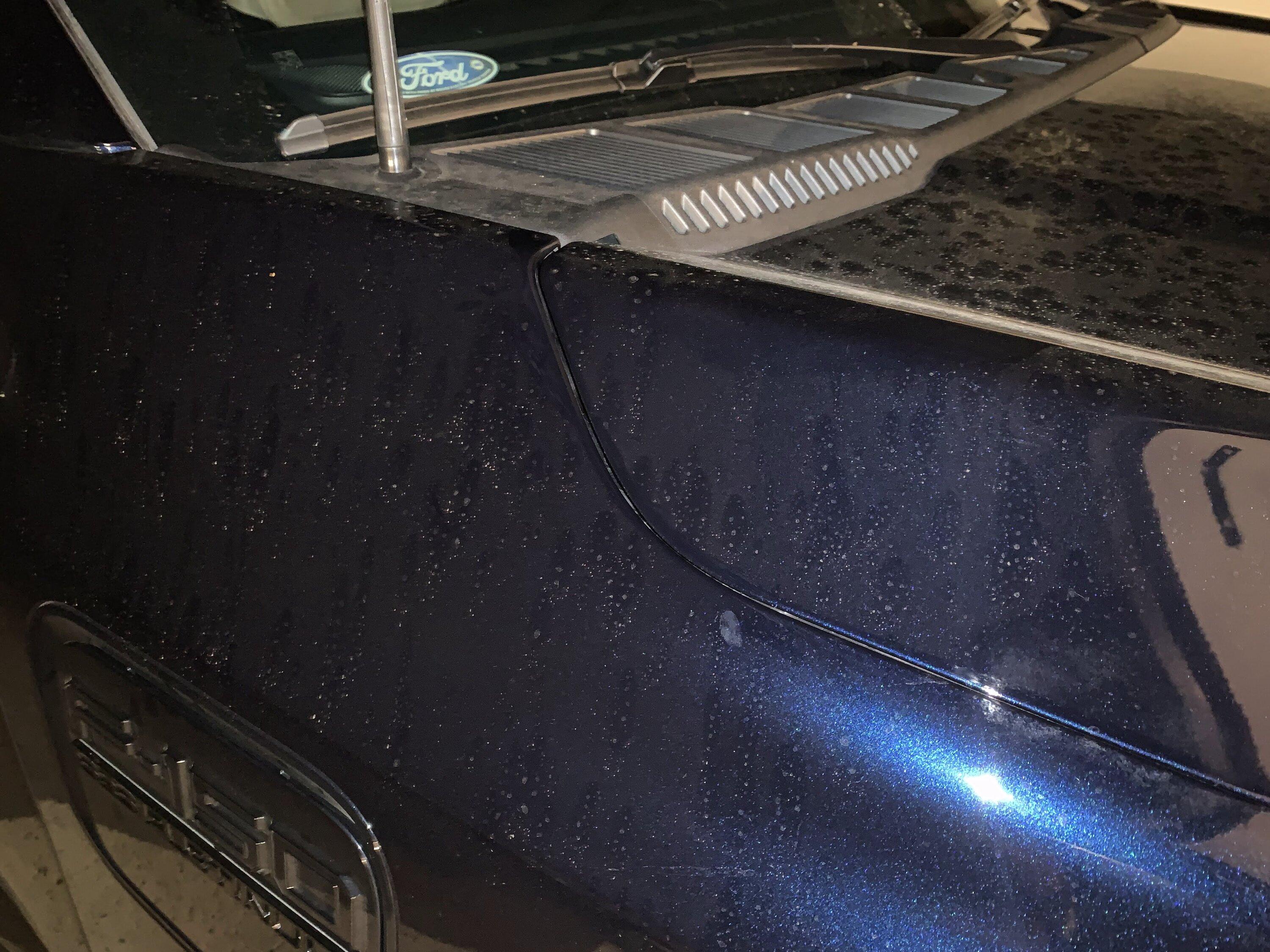

It's probably too dark (and dirty) to tell, but this is the side making more noise.
@millim A couple of questions. Any update from your dealer on what it will take to fix your Frunk? Also, about how fast were you going when the Frunk opened? I'm a bit concerned that opening the Frunk in a heavy wind could damage it.
Sorry - been MIA from the forum while the truck has been (and is still with) the dealer. Nothing concrete to say right now, but they are being very thorough for sure (and parts aren’t easy to get). Hope to get it back soon - I miss my baby.

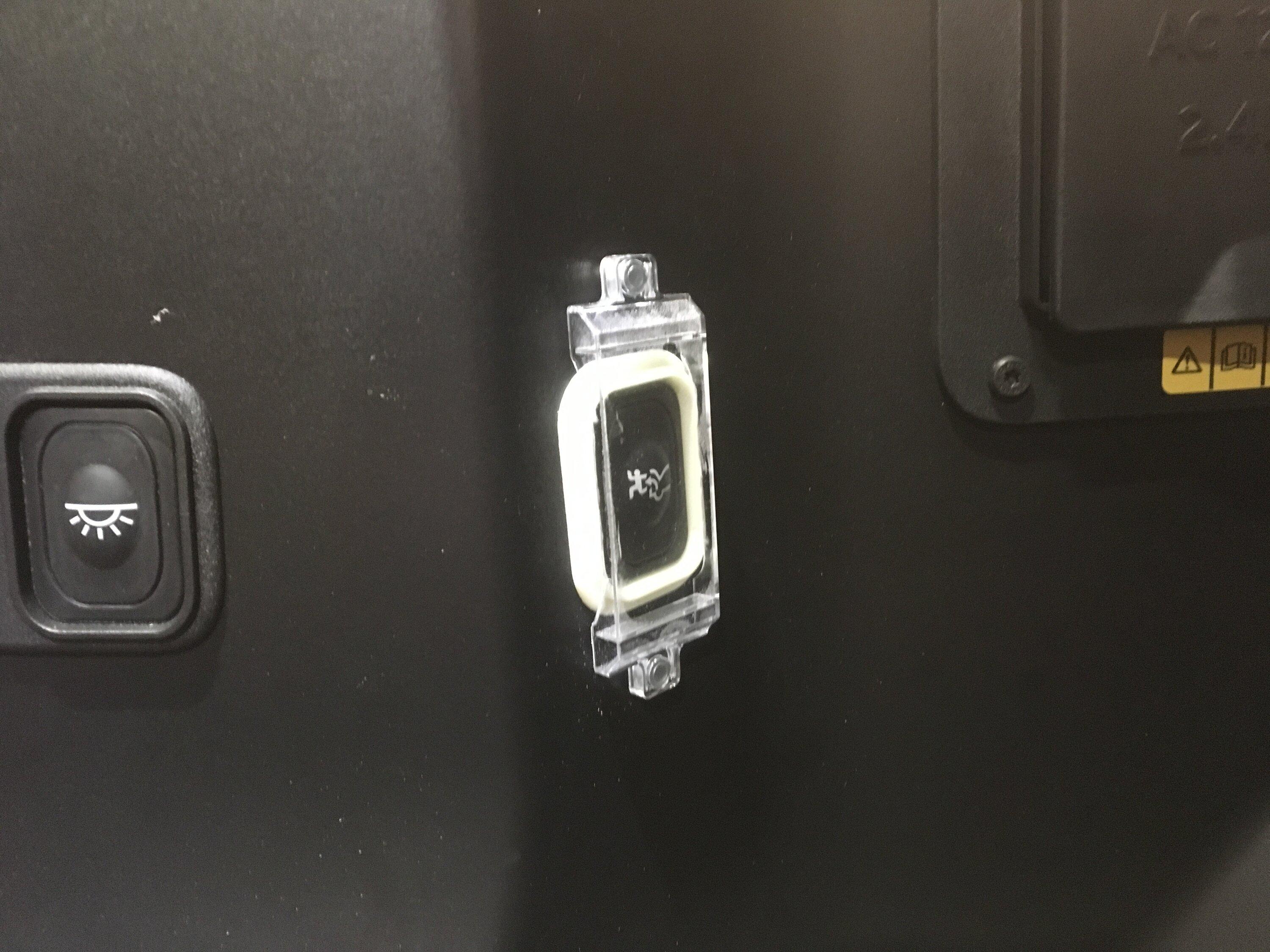

This picture says 1000 words and I'm assuming there will be some sort of recall to put a cover there... just like the power jacks. Other than that it would need to be something twisted or pulled, not pushed.
It doesn't need a cover. It needs to me disabled if the vehicle is in motion.
