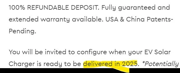

First I've heard about it, looks like no one has them except maybe to beta testers.
Ford F-150 Lightning GoSun solar charging 1726863619328-i6
A lightning driven efficiently at 2.4 MPK might get 15 miles extra range per five hour solar peak charging
