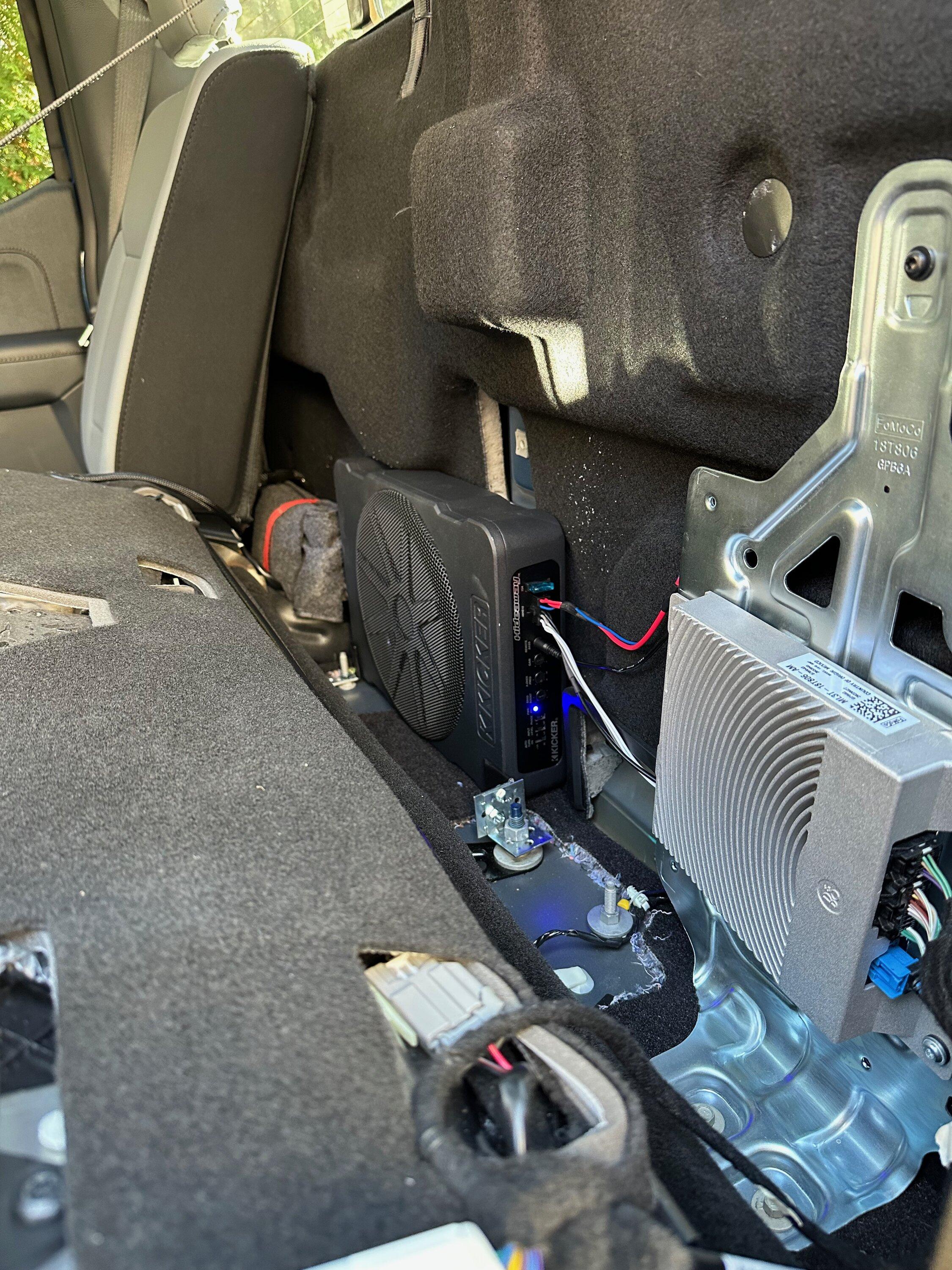

I made the following changes so far to the stock B&O system (Lariat ER). Everything so far has been exactly the same as the ICE trucks. I used the ICE and MachE forums to research these changes.
Note: I am not an audiophile, this is the most I have ever upgraded a car stereo system and almost all of the music I listen to is rock produced between 1970-2000. YMMV. ?

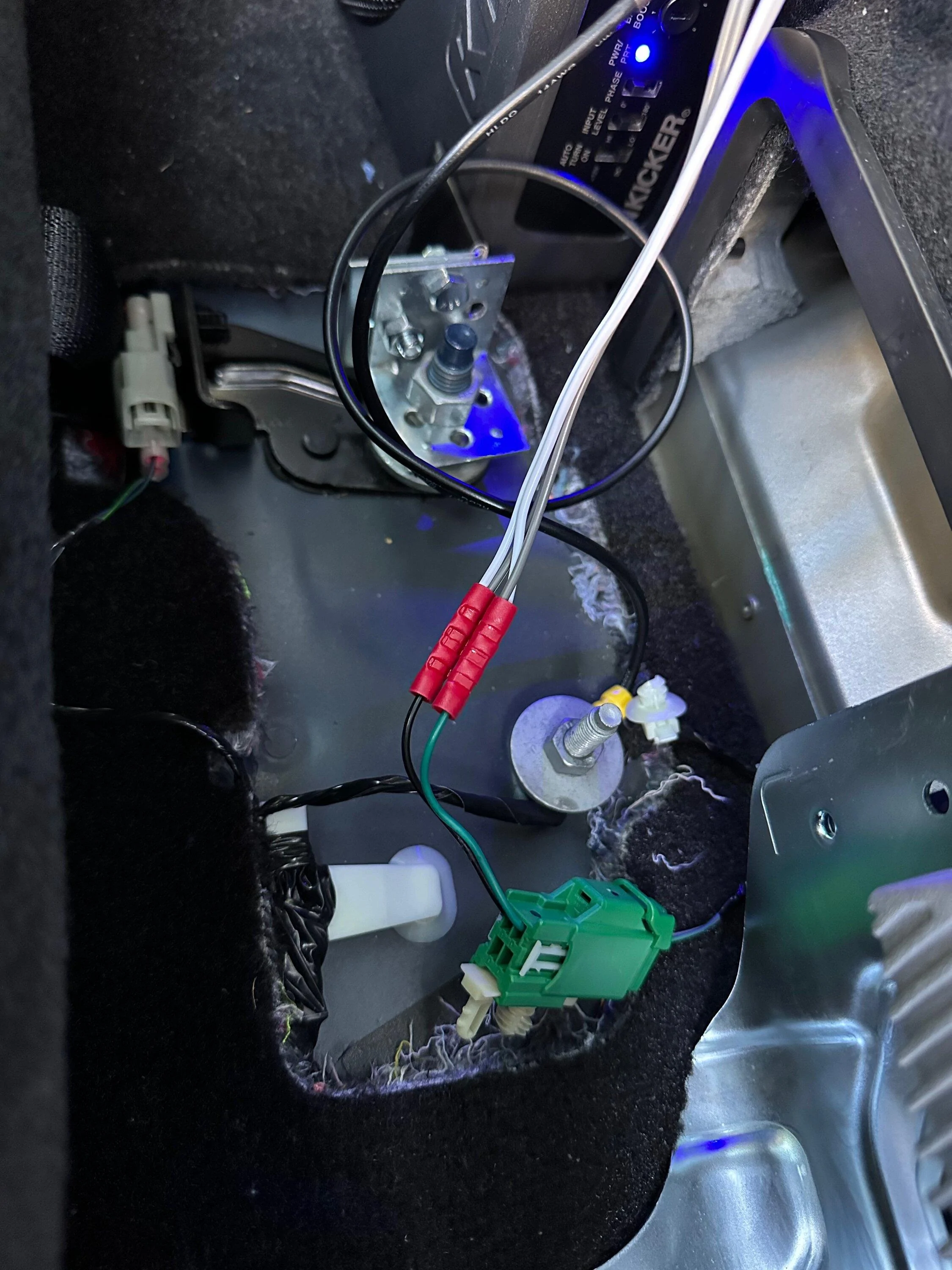

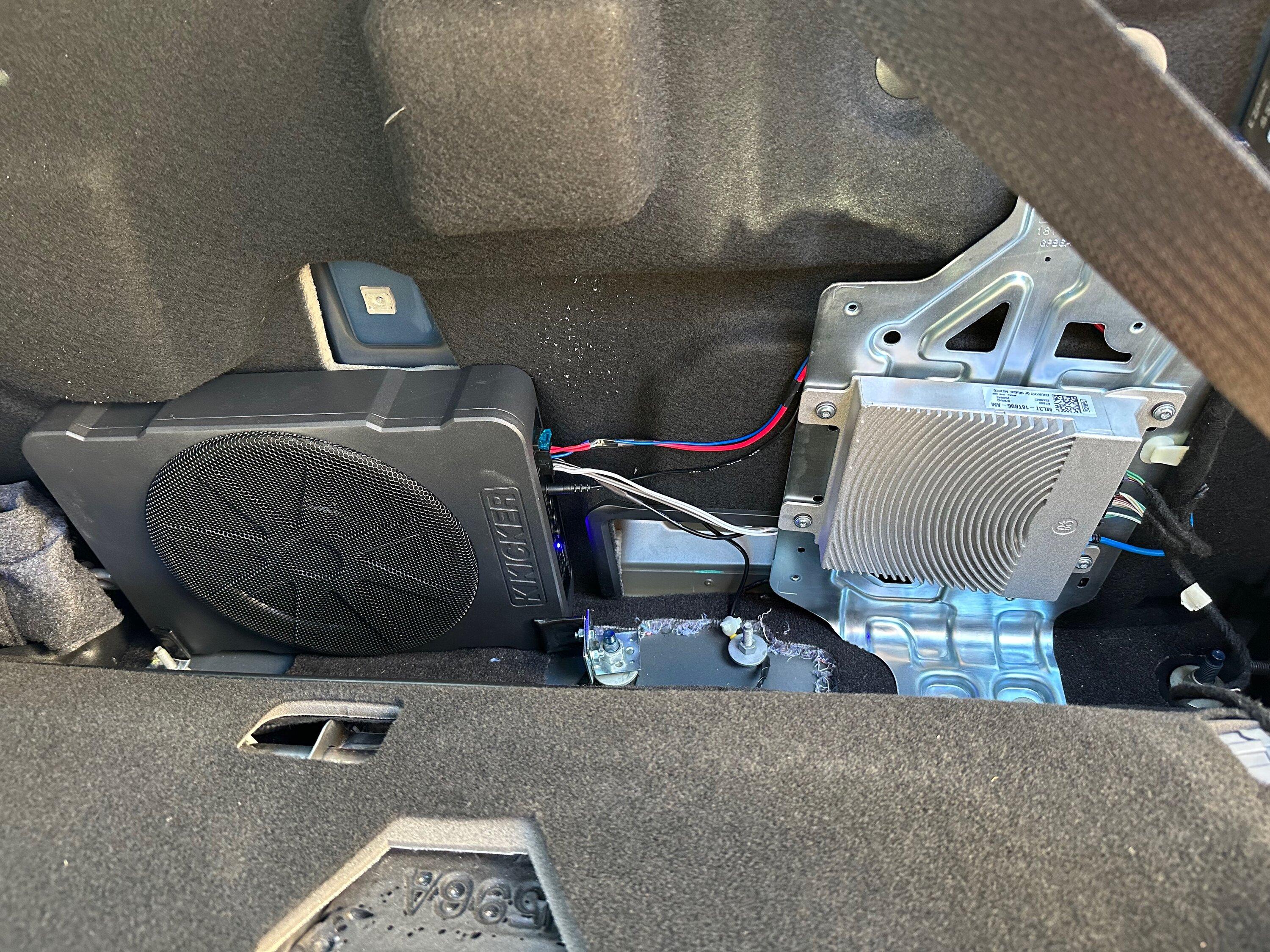

Replaced subwoofer with a Kicker Hideaway (HS10). This upgrade makes a big difference over the stock setup IMO. The install was straightforward and the sub fits nicely in the spot where the stock subwoofer was. I am using the high level outputs from the stock amp which the HS10 supports but in theory a dedicated LOC is better. I will probably try a LC2i at some point to see how much of a difference it makes.

Will your rear seat latch in the up position with this speaker, and do you have any pictures of your instalation?
Yes. Rear seat latches with no problem. The space behind the seat is almost a perfect fit for the HS10. I put some corner brackets in to hold it tight but I'm not even sure they are really needed.
