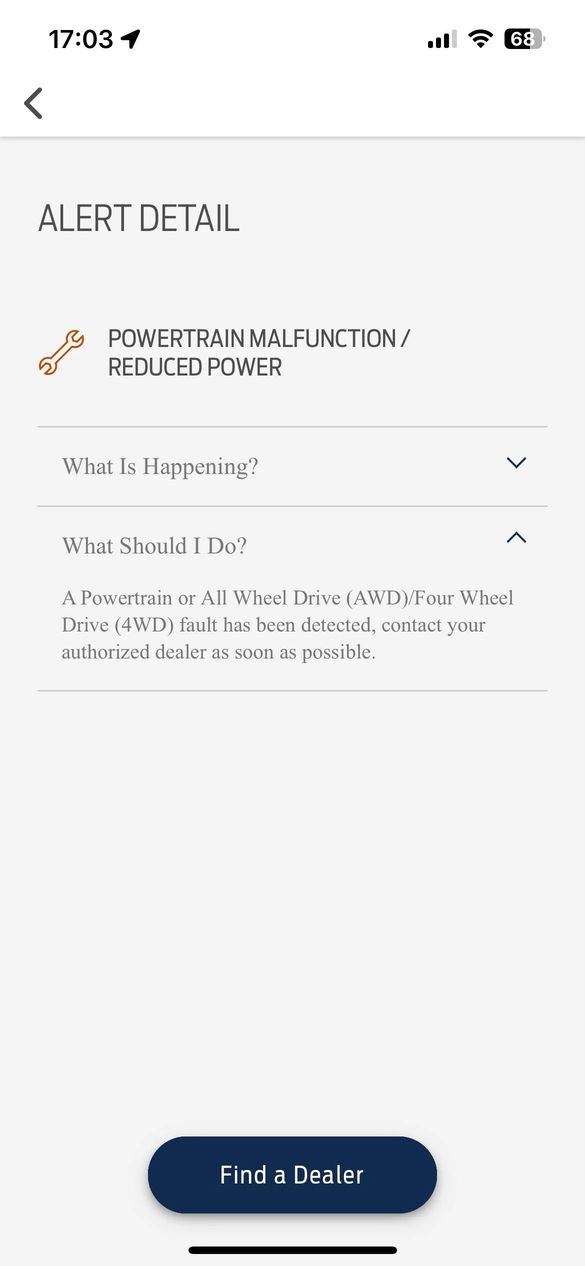

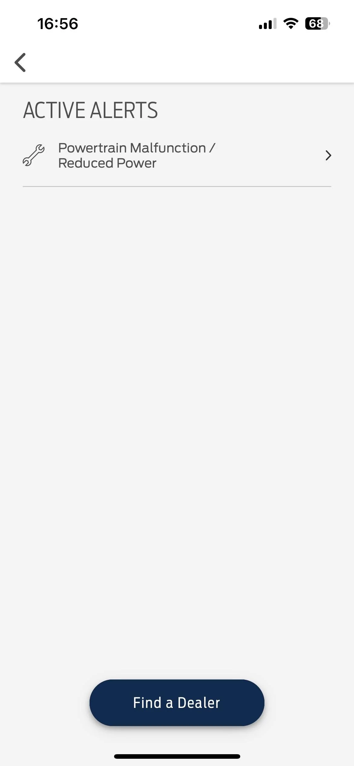

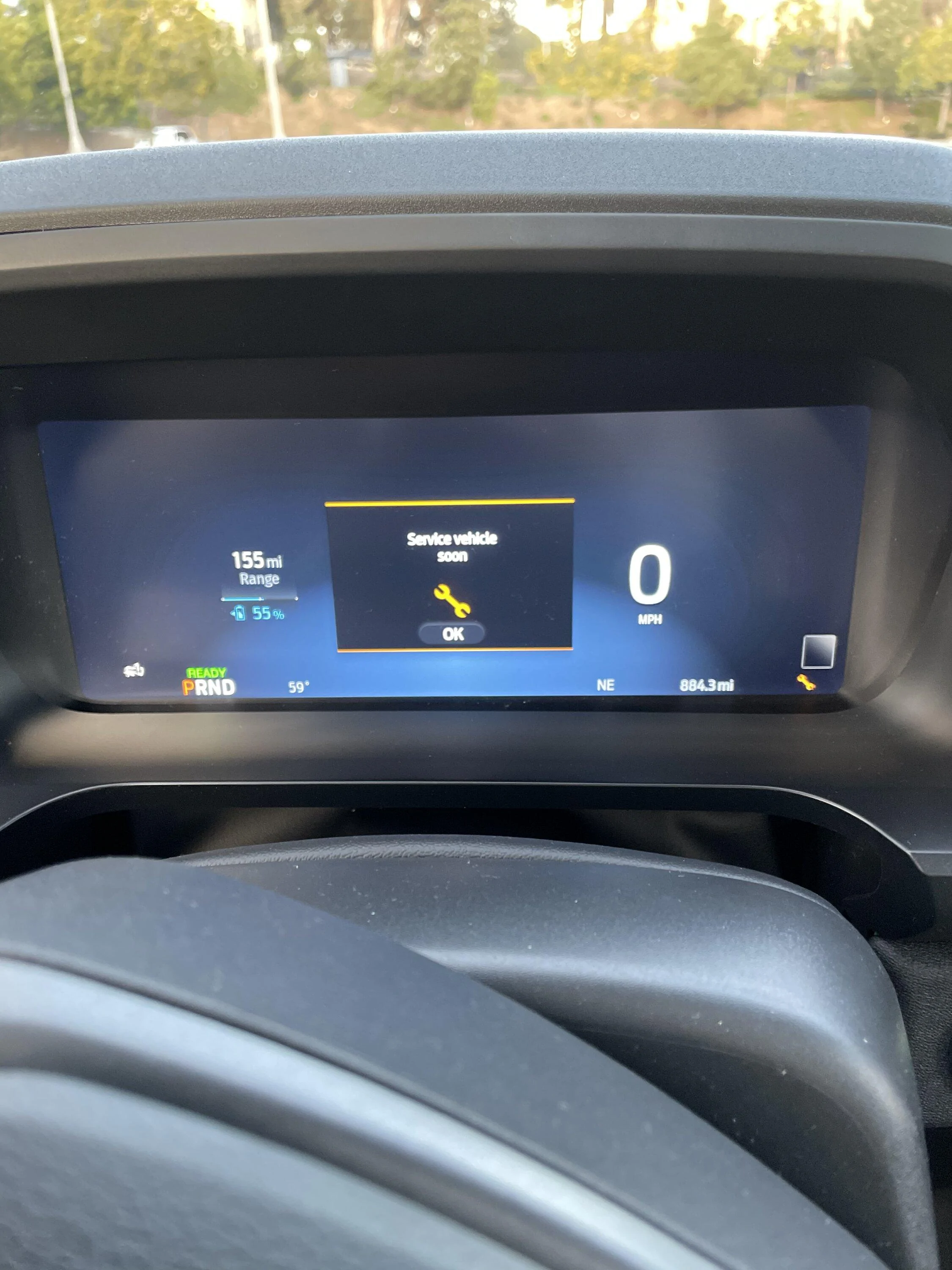

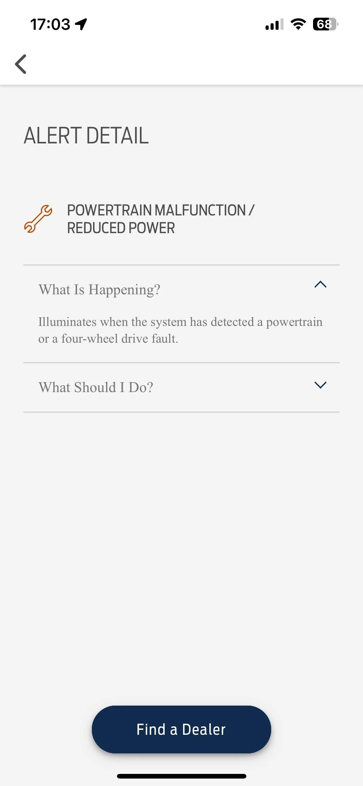

My wife was driving in a parking lot testing out the parking assistance feature and the service vehicle soon alert appeared.
Her version of events:
Testing out parking assistance. After shifting to neutral and holding down park button on dash, realized it was in parallel parking vs perpendicular parking so I removed my finger from the park button.
Service vehicle soon warning popped up first
Then error with 1 pedal driving, apply brake to reduce speed (vehicle was stopped)
Vehicle went forward once foot was off pedal so I navigated to a parking space. Turned off vehicle, turned on
Only service vehicle soon logo still appears
Can't see details like what the app shows
Ford F-150 Lightning Help Interpreting DTC for Powertrain Malfunction/Reduced Power Vehicle Alert 1673539200291
Ford F-150 Lightning Help Interpreting DTC for Powertrain Malfunction/Reduced Power Vehicle Alert 1673539238061
Ford F-150 Lightning Help Interpreting DTC for Powertrain Malfunction/Reduced Power Vehicle Alert 1673539257726
Ford F-150 Lightning Help Interpreting DTC for Powertrain Malfunction/Reduced Power Vehicle Alert 1673539266991
The service indicator went away on the instrument cluster/dash, but the vehicle alert still appears in my phone app (oddly, not the wife's).
The vehicle operates like normal, and I was able to pull the FORSCAN error codes (see below).
Can I safely call it a fluke, clear the codes, and move on or is this a more serious issue that needs attention?
Thanks in advance for your help interpreting the codes and making sense of the situation.
