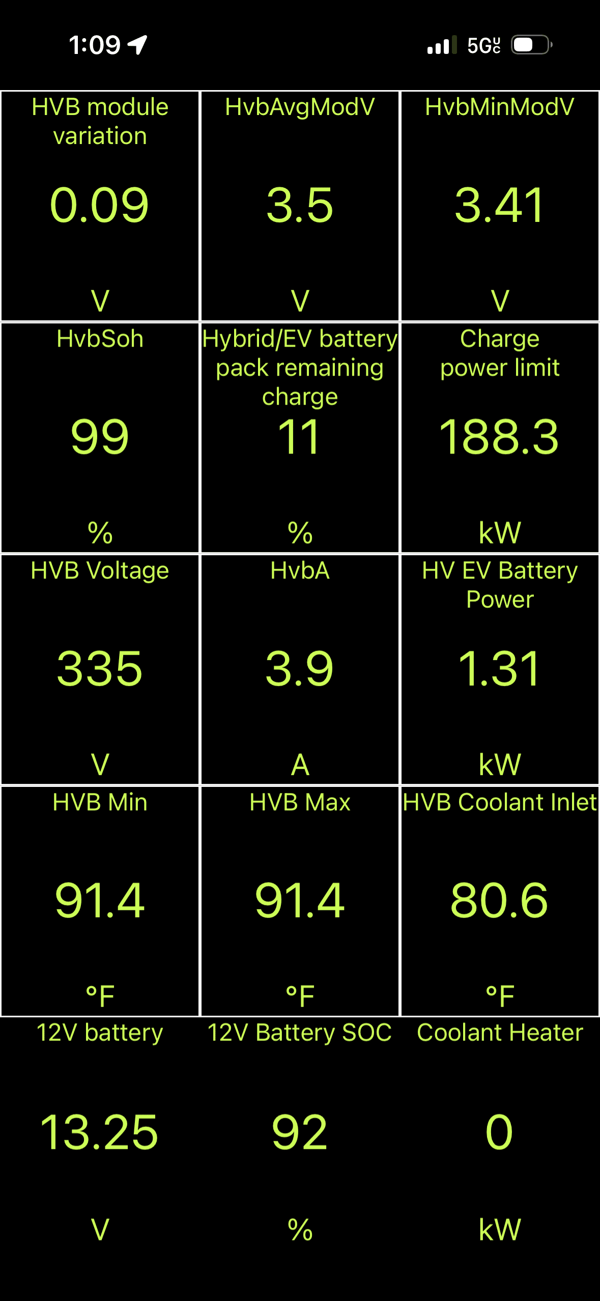

dbc files are what you would load into torque or car scanner. It gives you the ability to turn the Hex values into the engineering values.
I have torque showing the display SOC and the actual SOC, which are different. I also have the Hvb (high voltage battery) SOH )state of health). This gives you a better indication on the health of the pack. Current SOC does not. Search the Mach E forums for dbc. Most everything is the same for the Lightening except it will not show the second onboard charger.

You can also go through all the string voltages (your app says cell, but it is really strings) to see if you notice a difference in them. There are 192 strings in the pack.

Micky would you agree that my truck has an issue with the lowest cell being .11 volts lower than the average?

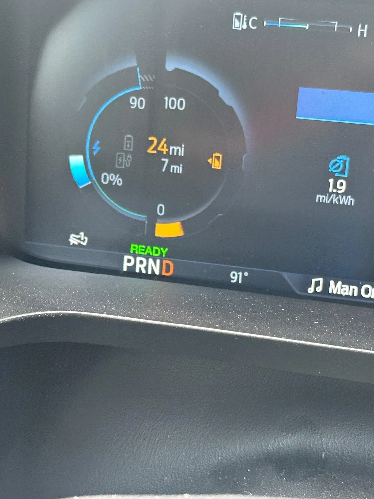

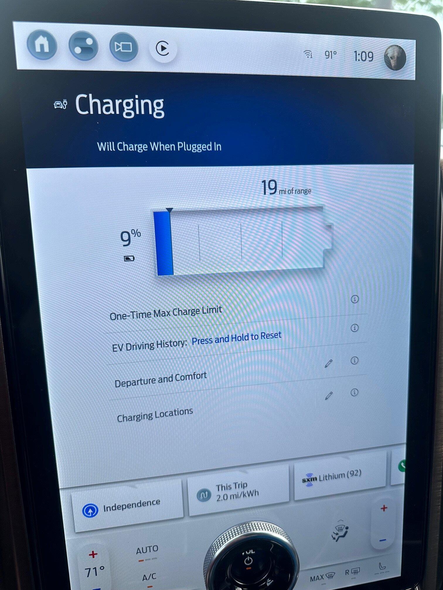

Finished my testing yesterday on our truck. Went from 52% SOC to 9% SOC averaging about 73mph. Voltage deviation between the weak cell and the average actually got a littler better in the lower part of the pack. At about 43 miles remaining truck went to 95% power and then to 90% power at about 25 miles remaining. Full acceleration at 9% SOC seemed fine and didn't change the voltage deviation or throw any faults.
So we are taking our truck on this long trip and getting the module replaced when we get back. Wish us luck and thanks for all the great advice.
