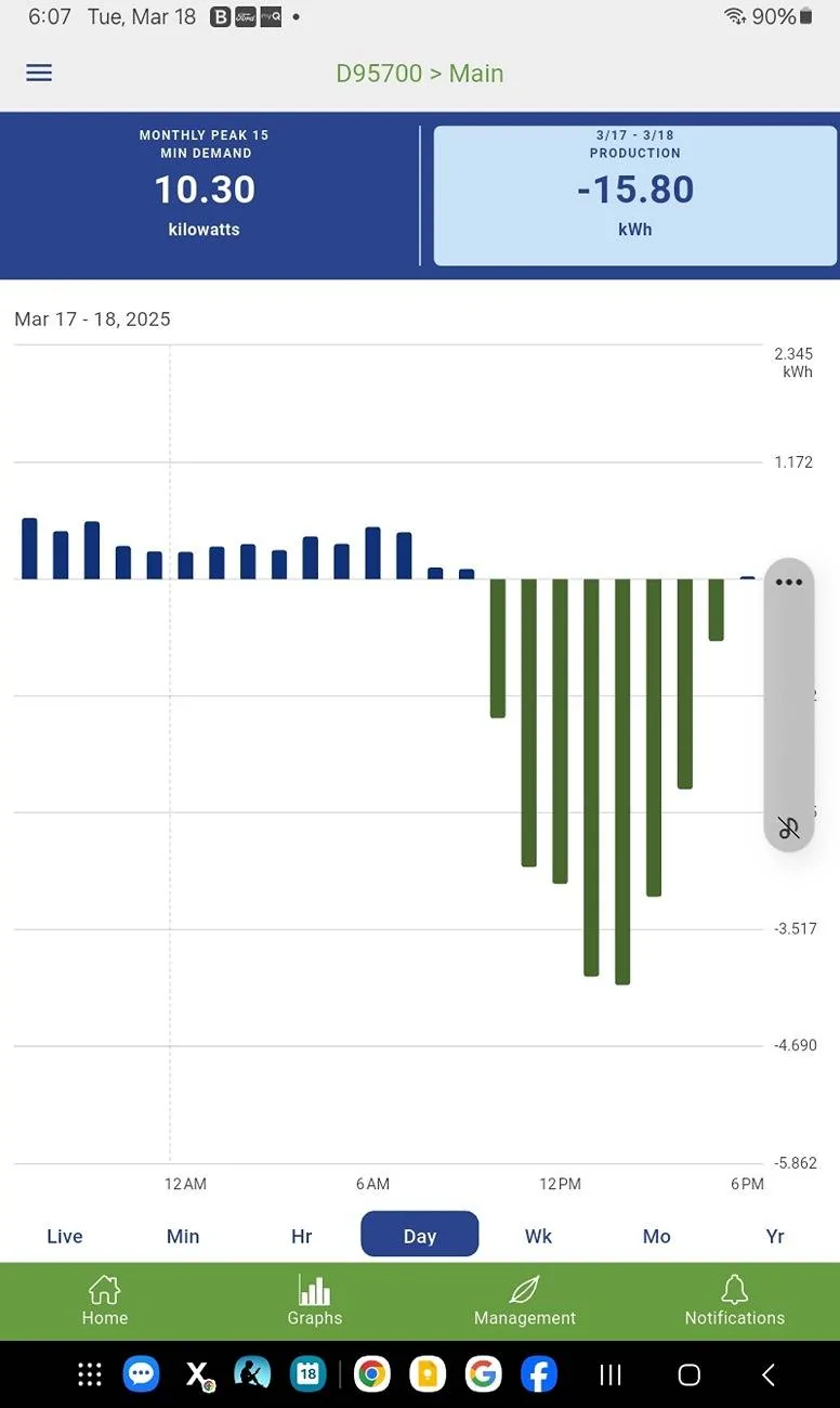

I too have solar, but we technically do not have net metering but I do sell my excess energy back to the grid. I have the Ford charge station Pro and Tesla power wall three they are hooked up to separate breaker panels as I did not have 100 amp spare capacity in my existing breaker panel but I can calculate the excess energy that my panels are sending back to the grid and adjust my charge station Pro down to that level based on the Tesla app and the FordPass app.
So if I’m producing 11 kWh and my house is using 2 or 3 kWh I adjust the FCSP to around 40 Amps which pulls about 8 instead of 16 kWh, sometimes I do have to reset the FCSP when I want to go back up to full power i.e. 16 kWh

Your excess solar should be going back to the grid do you have a smart meter that you could pull up on the Internet?
