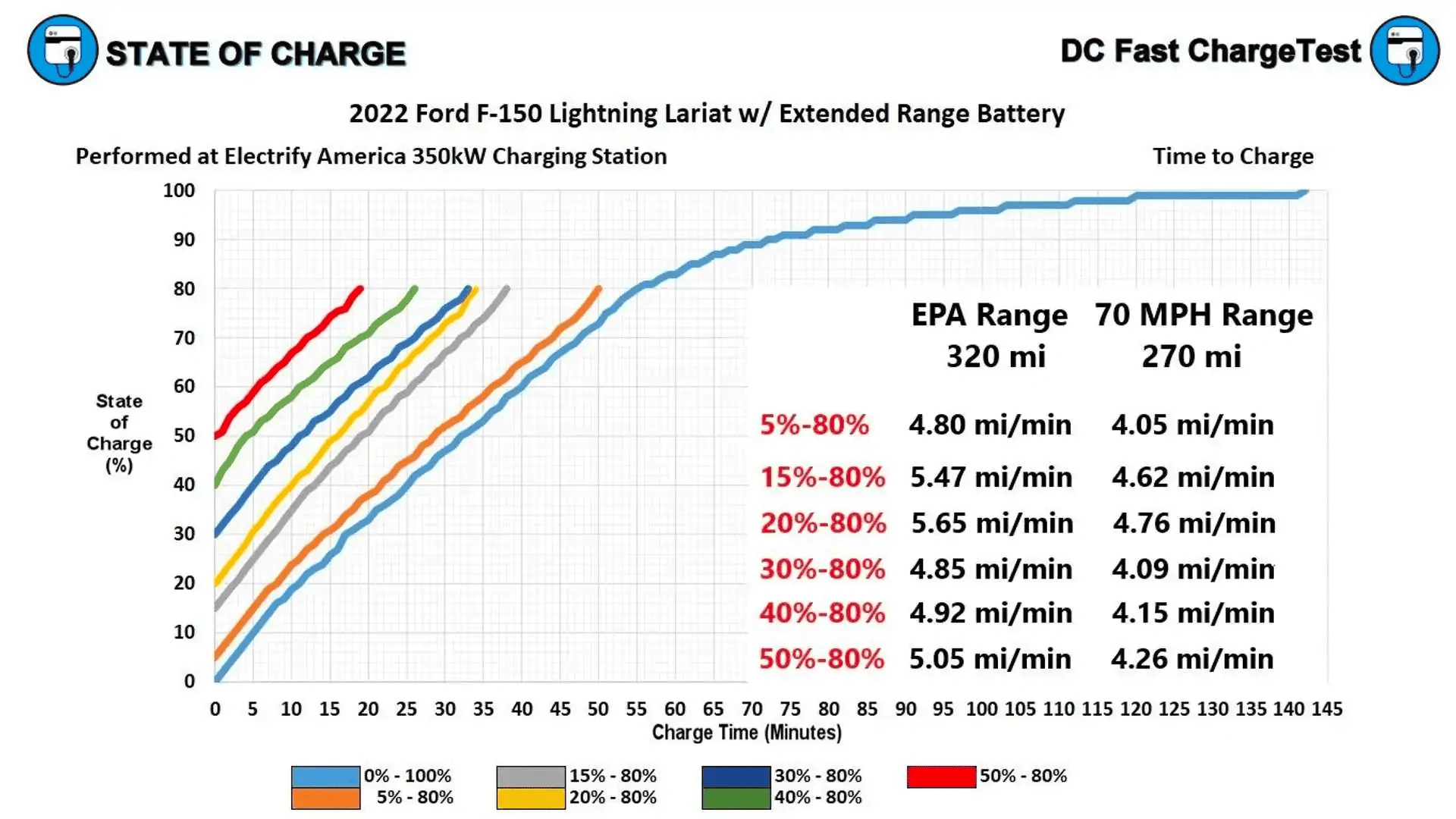

In Texas EA has tiered per minute pricing. From what I understand, the Lightning charges at a max of 155 kW, so it would be 32 cents a minute?
Some good info on actual charging curves here. One graph from that page is pasted below. If you really want to pinch pennies, it's cheapest to start your charge from 30%!
The rate of charge after 90% is appalling, and something everyone should be aware of when planning a trip.

EA has per minute rates in about a dozen states. You will pay the top rate, 32 cents a minute, IF you aren't using your free charging hours and if you don't join EA Pass+ after that. Pass+ is $4 a month, you can upgrade then downgrade minutes later and it will take effect in 30 days. It lowers the rate to 24 cents per minute in per minute states. You can see what states charge by the kWh vs. by the minute on EA's website.
Per minute charging is about 50% cheaper than per kWh charging up to 80% state of charge. Then, when charging speed slows, it will be a much closer comparison.
You don't want to DC fast charge above 80% unless you need the range due to speed of charging, and in per minute states possibly cost.
