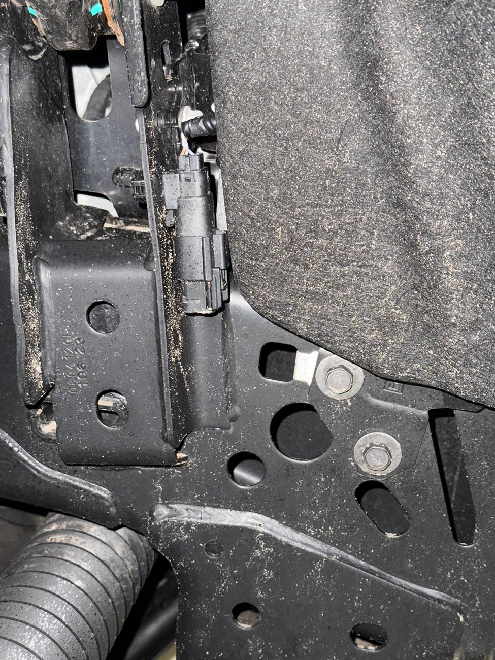

I think that only the 22s had sensors. Parts shortages took that system off all the other trucks.
You dislike the look? Seriously? The factory rake on these trucks is ridiculous.
Well shit! Went out and looked on the front right I found this plug. I have a feeling this is for front level sensor. Me being the stock nerd that I am now will have to look into this further. My truck only had one deletion and that was the advanced security pack which I have since added back in for a whopping $38. lol.
From your profile it looks like we have the same truck... can you share the part you ordered to get back the deleted features and if you find this is the leveling connection for the lights the part you install to get them back?
Let me get the part numbers together. I added the security back and added back the lighted cup holders. Both were pretty easy to do. And do me a favor and send me a dm so I don’t forget. I’m working on that front plug but I do get scatterbrained and might forget. lol.

I wasnt even aware of the auto-level headlights...the suspension shop today went to show me where these tie into the UAC (upper-control arm) sensor and that they "use the auto-level headlights" and of course I don't have them. They had just done a '24 Platinum that did have them.
Did anything ever come from this @astrand1 & @GingerBear85?
I had then thought maybe this was tied into the bed scale delete (that mine had) but the comment above seems to contradict that. So this would be more than a harness, right? Like an electric assembly on the back of the headlights?

Haven't had time or funds to pursue the additions but hoping that @astrand1 has had the time to figure it out!
