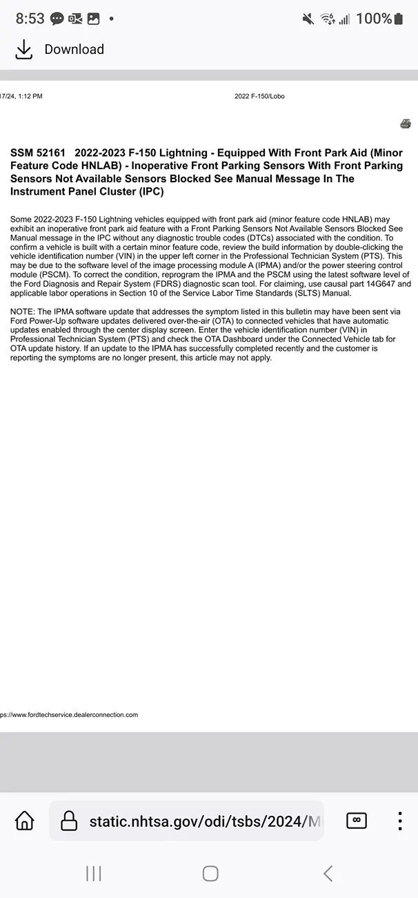

No I actually had that problem and the fix, which worked, but this is sensors triggering for no reason.

My front driver side parking sensor was constantly giving false alerts. I eventually just turned off the sensors because of the false warnings. When I took the truck in for the CSP fix, I mentioned the parking sensor issue to the dealer. They seemed to immediately be aware of the problem and said there was a software fix. The parking sensors have worked perfectly since. So the moral of the story is take the truck to the dealership. Hopefully it’s a simple fix.

I had the same issue and felt the same way. Ended up taking it to the dealership to do a couple recall things. Told them about the sensors, they fixed them and had the truck back the same day. No issues since.

There are software updates for sensors. I had it done. Works 99% better now. I had a front sensor that was nutty, software update fixed it 99% of the time. Took 2 hours.
