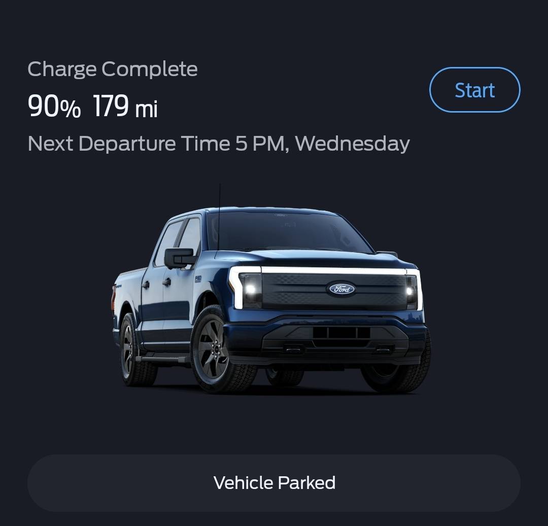

I really enjoy my truck but in the last two weeks, I've noticed a big jump downward in the estimated mileage. It's showing 179 estimated at 90% charge right now.
I've only had the truck.for 3 months. It seems a little early for that kind of drop.

Looks like you drive a lot around 70 mph. That would be about right. The computer calculates the range based on your driving consumption vs EPA when you first get the truck. I normally get about 2.0 mi/kwh. So for me 2.0 x 131 x 0.90 = 236 mi. From the screen shot, your average consumption seems to be 2.0294 mi/kwh.
You can reset that by the way.

Several have said, estimated range is not an indicator of battery health. It’s guessing your range based on recent driving history, temperature accessory usage and so on. Best to ignore it and just use state of charge like a gas gauge in an ice car.
To determine your actual battery, stay of health get an OBD scanner and use an app called torque with the Ford EV PID’s loaded. There is a dedicated high-voltage battery SOH.
Most people have seen very little degradation even over lots of mileage and DC fast charging. Ford put a huge buffer in for protection so the batteries don’t get charged fully even at 100%.

I never trust the range estimator, at all. I use data and a calculator. A ball park calc from the data below yields 2 x 98 = 196 miles. The estimator on the Ford Pass App says 236 miles. I'm pretty sure that won't happen. The most optimistic calc would be 2.13 x 98.59 = 210 miles. The Ford estimator thinks I'm getting 2.39 mi/kwh. That my be accurate for around town & moderate highway driving but when range matters to me, I'm on the interstate. And it's not 2.39.

Going to spring an anecdote on you. I live in Glendale AZ so my range is usually pretty consistent year round. At 90 percent my guess o meter usually sits between 210-220 on my XLT SR. A few months ago it started dropping drastically over the course of a week or two. We don't really get winters here so I started getting concerned. Eventually mine started reading 175 at 90 percent with no changes to my driving habits
2 days later my power availability dropped to 53 percent and turns out battery pack 7 failed and needed to get replaced. I'm not saying this is your case but that was my experience.

Estimated mileage has nothing to do with actual. Driving habits, speed, wind, temp, and elevation do.
A bad cell won't typically manifest as decreased estimated mileage- it will likely manifest first as rapidly changing estimated during a drive, less available power, or decreased battery charge with no events.
Did you take an interstate road trip recently, something different in your normal routine?
