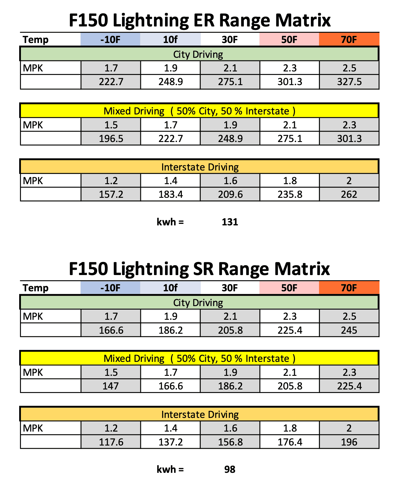

I have shared this elsewhere on the forum.... I put it together mainly for my amusement, but maybe it would be helpful for some people. The MPK efficiency I'm sure could be debated, but for the most part it seem to be fairly accurate. Better than relying on GOM. I would turn it off if I could. I would prefer just to see KWH remaining. Not SOC. Not miles.
I have 17k miles and driven the whole gamut from -10F to 95F in my truck.
FWIW, I'm consistently getting 350 miles per charge (trip meter shows 2.8 m/kWh) in almost all city driving, 75F temp.
