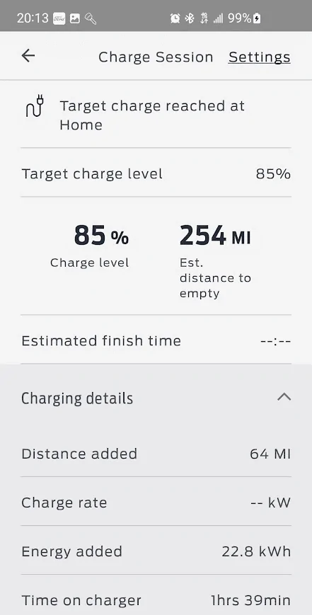

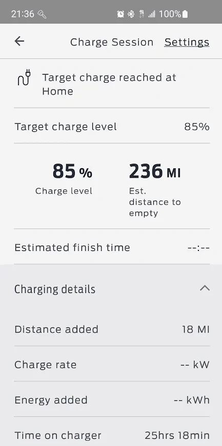

I've been watching my SOC & projected range over the weekend ever since charging the truck Saturday evening to 85%, while charging the heat created helped to improve the range, as the truck cooled overnight and into all day Sunday, the expected range diminished as the truck lost all the pack heat.
What I found peculiar is the [Distance added] when colder is actually the [Distance LOST] due to the cold battery pack, if I had used departure timer, and warmed up the pack it would have improved.
Saturday 1/6--------------------Sunday 1/7---------

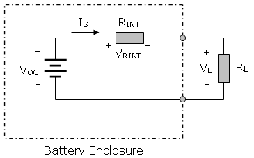

Here's a good explanation of why, when low temperature causes the internal resistance of a Li-ion battery to increase, the voltage across the load decreases. Basically, because the voltage the chemical reaction can deliver will be distributed as the voltage internal to the battery plus the voltage across the load. When the voltage drop internal to the battery rises because of increased resistance, the voltage available to the load has to drop.
Consider the actual circuit of the above battery feeding a load resistance RL.
Ford F-150 Lightning I'm out after 6 months main-qimg-587ad5f5e4300fed5db543acbfa19033
By Ohm’s Law, Is = Voc/Rt = Voc/(Rint + RL)
The voltage across the load, VL = Is ٠ RL = Voc ٠ RL / (Rint + RL)
The voltage “drop”, is the voltage lost across the internal resistance of the battery.:
Vdrop = Voc - VL = Is ٠ Rint = Voc - [Voc ٠ RL/(Rint + RL)]
or Vdrop = Voc [ 1 - RL/(Rint + RL)]
As you can see, the higher the internal resistance of the battery (Rint), the greater the voltage drop will occur across Rint for a given load current Is, and the less voltage you’ll have available across the load (VL). Similarly, the smaller the load resistance RL, the larger effect the internal voltage drop across Rint will have on the voltage available across the load (VL).
I was tempted to show you how to solve the above relationship for Rint, the internal resistance of a battery by (a) measuring its open circuit voltage Voc, and then (b) its terminal voltage VL when you connect a load resistance RL across the battery, but I suspect that if you want that information, you can readily do the algebra yourself.
Source: https://qr.ae/pKx0I5
The guy who contributed the Quora post says his credentials are: " MSEE & BSEE, 50+yrs NW R&D EE, Power/Control/Comm Systems."
