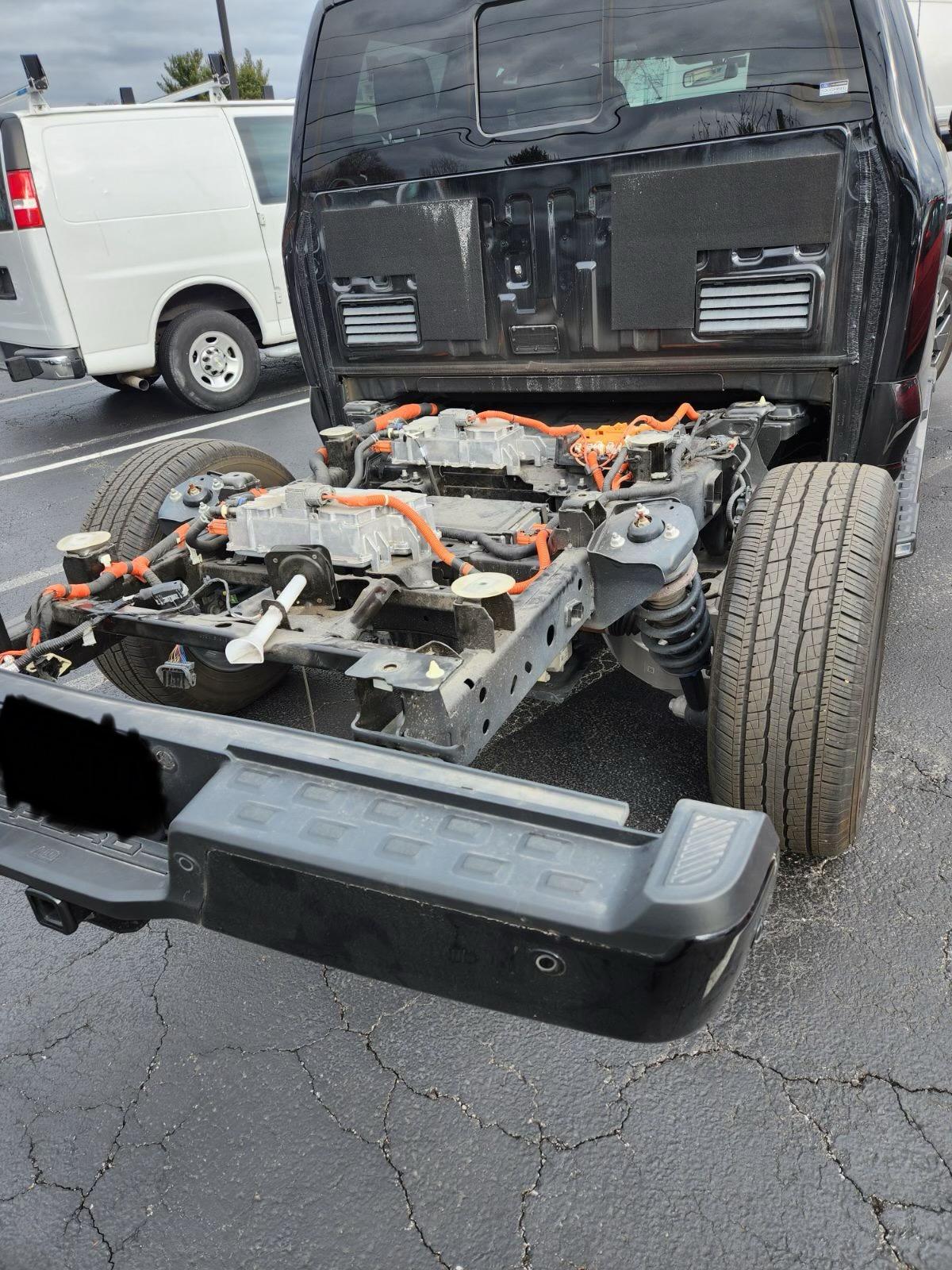

My friend sent me this from his dealer. His truck is at the dealer because mice ate through the battery module cabling. Not sure if this is a helpful shot of under the bed of a lariat.
It helps but would need to see the coolant hose side of how it is T off and the orange wires connecting back to the power box. Also since it is off can your friend see if they csn get the part # of the inverter and cables needed too? Thanks

If you guys can show me where I need to look on my Pro I might be able to get you something. I'll probably have to get a better scope camera, but if I have some options on places to insert the camera I might be able to get you what you need. How much does the truck bed weigh too? There's always the chance I could remove it, although I'd prefer to not have to do that since line-x coated over the bolts that hold it to the frame.
I think we need to see how the coollant hose goes from the 220v inverter to the 110v inverter and the cabling path.
Realistically, it would be great to have pictures of the coolant lines leading to and from the 7.2kW inverter and what they connect to. In the best of all possible worlds, I'd want those, pictures of the orange high voltage line leading to that inverter, and pictures of part numbers for both coolant lines, the fittings those lines connect to (likely some sort of tee), and the high voltage connector. The realistic part alone would be great and probably a that's necessary.
