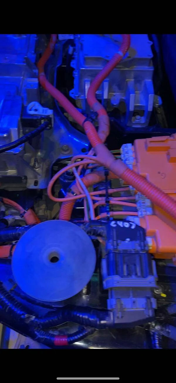

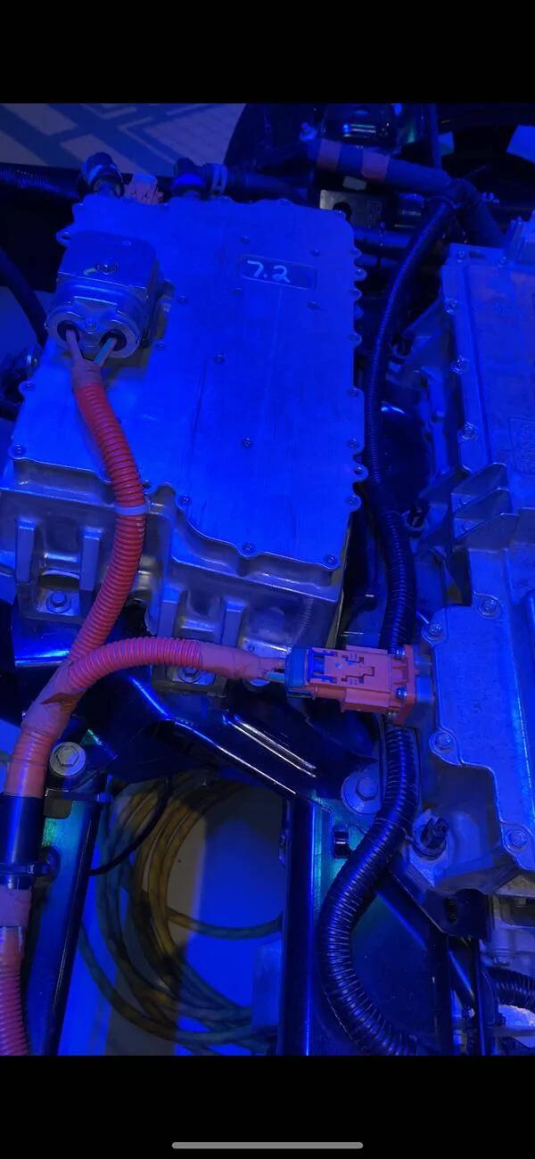

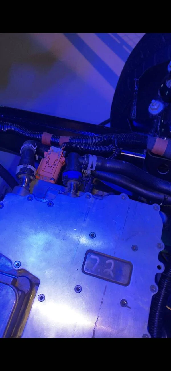

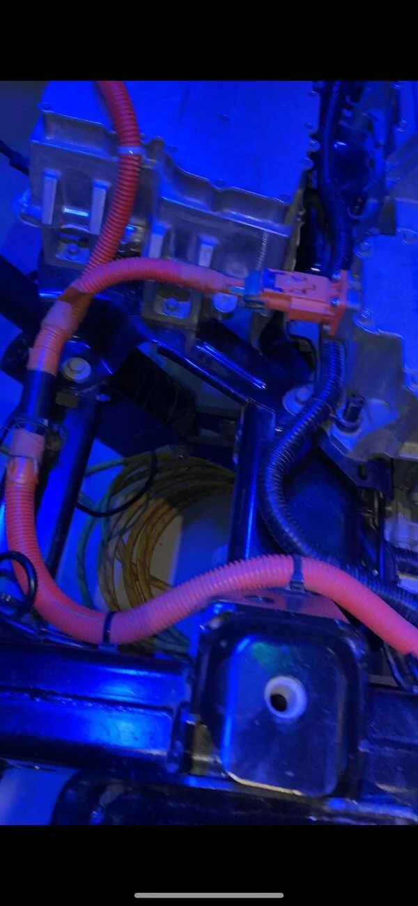

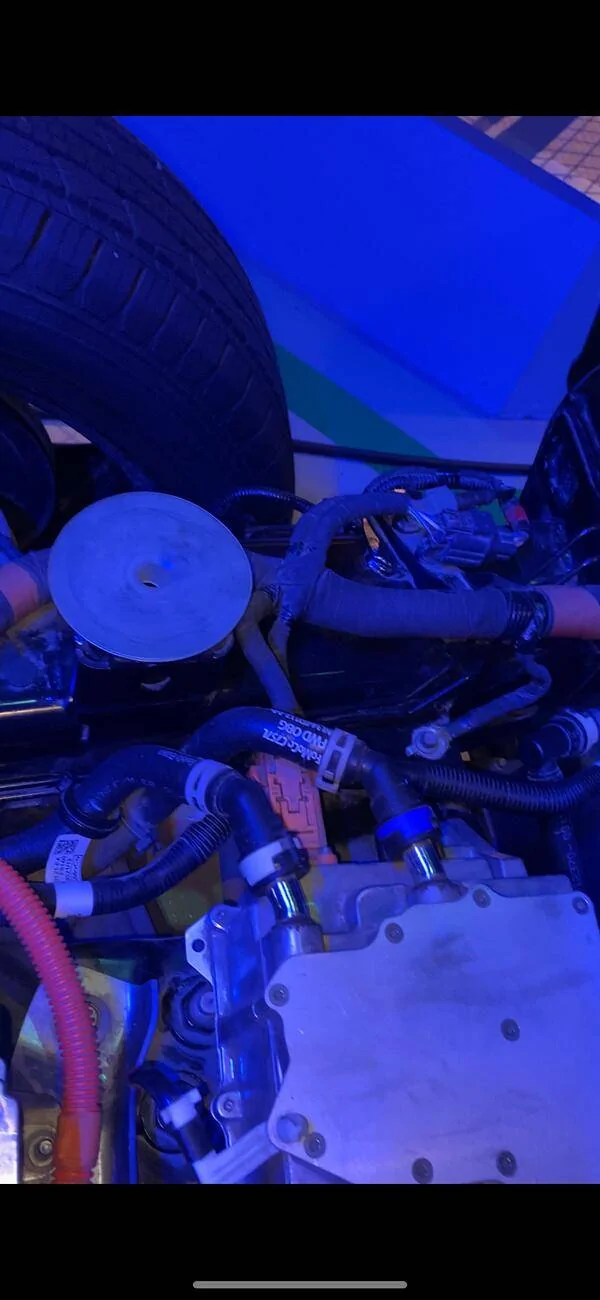

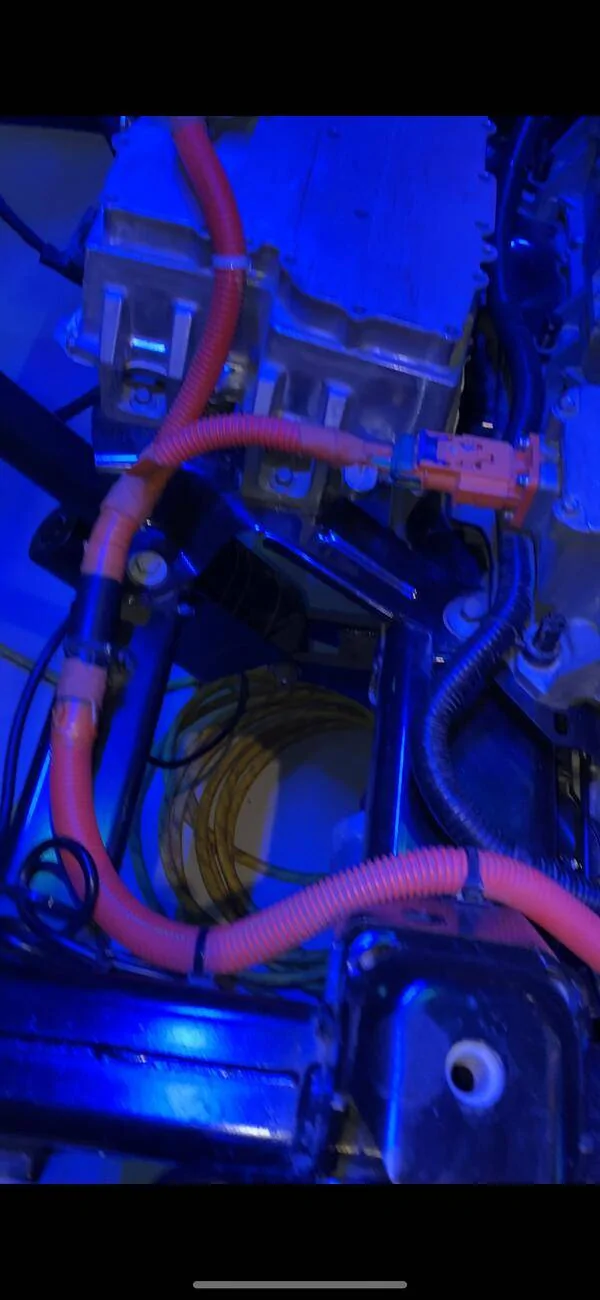

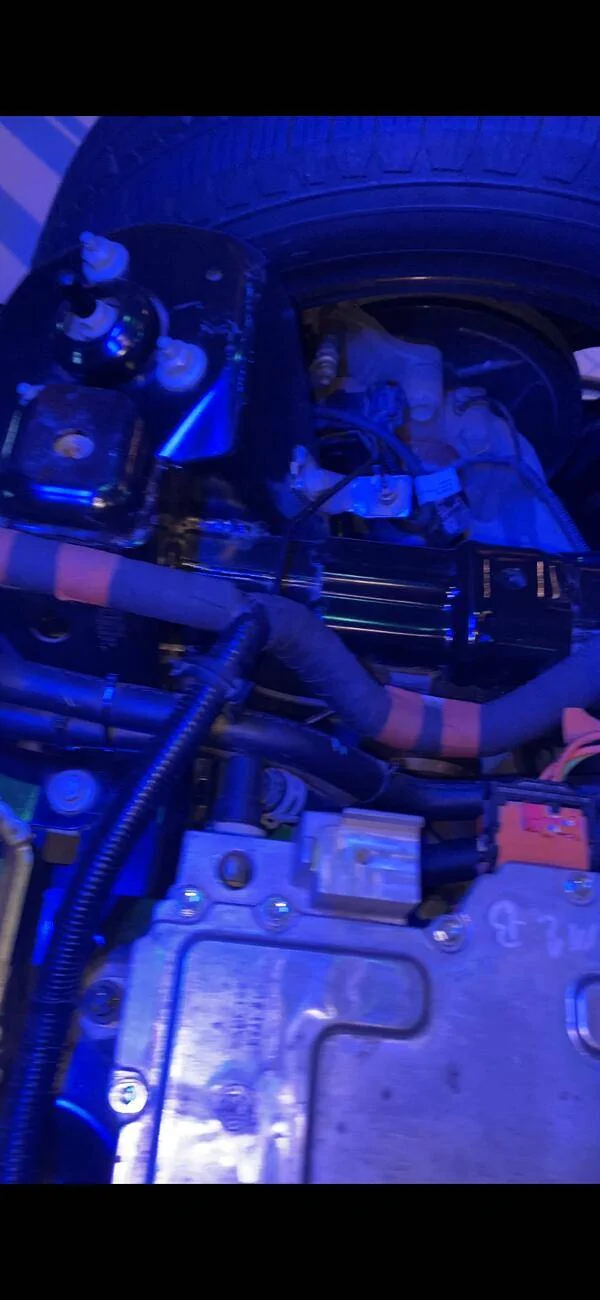

I got a somewhat detailed video of the 9.6 Pro Power Plus 7.2 rear inverter hookup detail. If you pause the video you can see the electrical and coolant connections. With the right parts I feel it could be plug and play.
It’s gonna require the inverter, mounting bracket, bolts, 2 wiring harness (inverter in and inverter out/bed receptacle) and coolant hoses. The wiring harnesses could be the big problem if they different between 2.4 and 9.6 trucks.
I think it could be done with spare tire removal and WITHOUT bed removal. Just a guess. The inverter is the smaller component to the rear.
Video to follow when I can figure out how to fit this forum’s size requirements.

Am I looking at a hydraulic piston for a dump-truck conversion???
Its a factory display mock-up chassis, to show what’s under the cargo box (truck bed).
Thanks. I guess that explains why the bed was tilted up instead of being removed like it would be if you were working on it.
