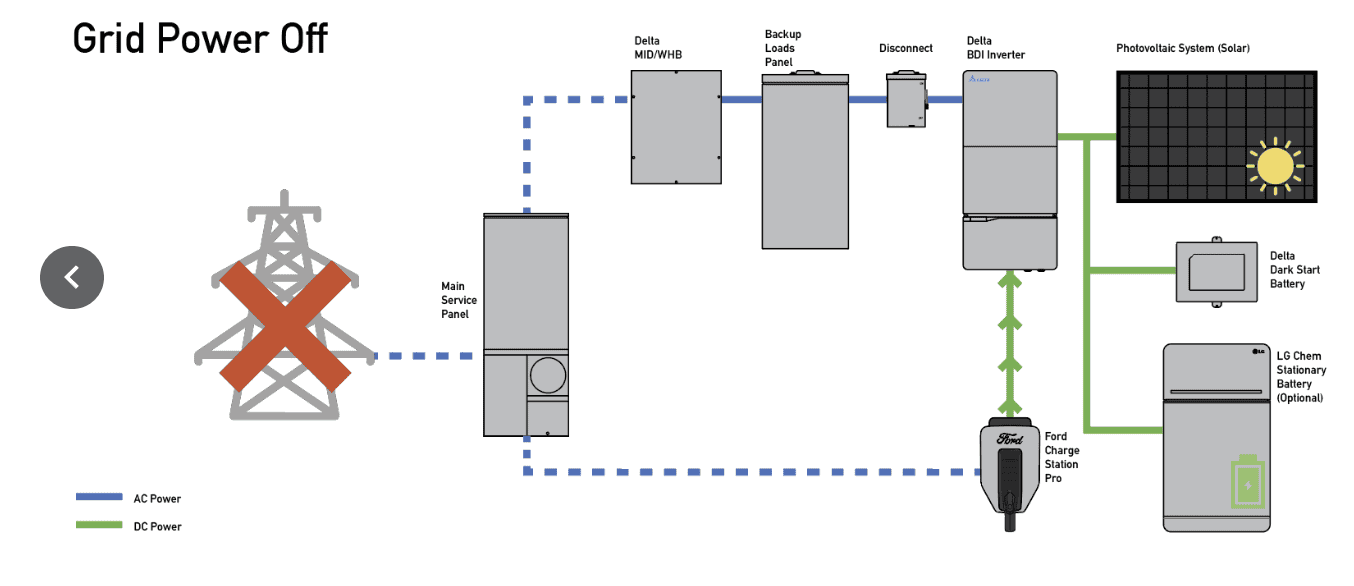

The Sunrun Field Website shows in off-grid mode, power only flows from the truck to the inverter. Click the left or right arrowheads/angle brackets when at the Sunrun Field Website link to see the on-grid power flow diagram vs. the off-grid mode. My installer suggested that, for unknown reasons, the truck backup functions more reliably if the Delta system also has photovoltaic input (it didn't sound like he was making his deduction from a large data set, though).
Field Website - Ford EV Charger (google.com)
