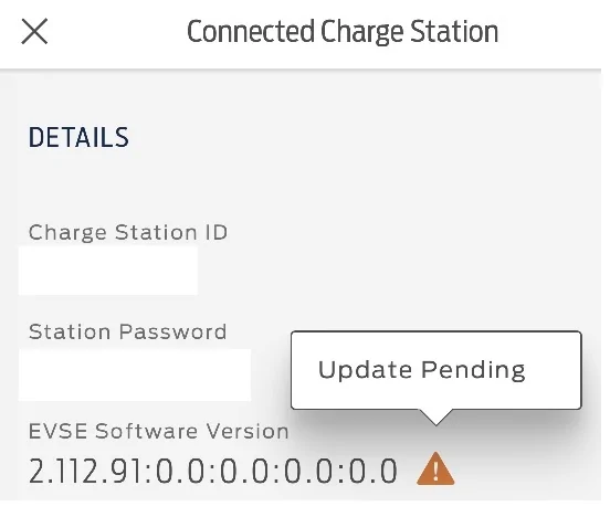

Some progress. I was having Backup Power Unavailable notices whenever I plugged my FCSP into my truck. These notices would prevent any information appearing about preparedness to charge or charging as a notification pop-up at the bottom of my FordPass Home screen tab. Sometime in the last week, that stopped occurring, and I now get notifications about charging again. I'm still on version 4.29.1 of the FordPass app for iOS, so it's not because of an app change. I seem to have received the recent FCSP firmware update as it shows in my FordPass app with an exclamation mark beside it: https://www.f150lightningforum.com/...-version-2-112-91-2-149-1-32-1-53-0-62.16527/, although the FCSP setup app still shows an earlier firmware version for me, 2.112.91:0.0:0.0:0.0:0.0. (I haven't power-cycled the FCSP or let my truck sit unplugged through the night, AFAIK, in the last week).
Whenever I looked at the status of my FCSP in the FordPass app for the past several weeks (Account, Connected Charge Station), there would be a blue "Charging" logo over the FCSP image, even though the device was not charging. Now, the logo displayed is "Ready to Charge," as it should be.
Two other funky things just started happening or are still happening, though. Whenever I unplug the FCSP from my truck, its LED turns into a solid white bar and remains that way for at least a few minutes (haven't paid attention to what happens after that). In the last several days, I typically also get an "Outage Detected" alert in the FordPass app despite no outage when I unplug the FCSP.
Hoping this is progress in small steps towards a fully working HIS unit. But perhaps it's just fixing glitches that were introduced (for me) at the Ford server level with the recent v4.29.1 iOS update to the FordPass app.
This is normal, mine does it every morning after I unplug from a charge session.
You might try power cycling the FCSP , dark start battery and HIS controllers to fully implement the software change in the FCSP.

Interesting that that the FCSP LED changing to white on unplugging is normal. IIRC, my FCSP used to stay blue when unplugged (had plenty of time to plug it into the wall mount without having any color change, IIRC), so perhaps that was a symptom that all was not right in FCSPville for my device.
I cut all power for 52 minutes, restored power, and waited another 20 to 30 min while OBDII scanning my unplugged truck. Curiously, the FordPass app no longer shows the firmware version of the pending update but rather the current firmware version same as reported by the Charge Station Pro app. But now, if I click on the still present yellow triangle with an exclamation point in it, which I never tried doing before, it says "Update Pending." So, I'll let the FCSP sit overnight, not plugged into the truck, and see if it updates itself in the next few days.
Ford F-150 Lightning Intelligent backup power issues/unreliable 1693462340961
Curiously enough, when I unplugged the FCSP from my truck before power cycling, this time around, the FCSP LED stayed blue until I cut its power (instead of turning white, as I reported above)! I guess with Ford software/firmware, a foolish consistency is the hobgoblin of little minds...

The white signal lamp happens most of the time, but I've had occasions where does not do it, definitely more haphazard behaviors from the system, eventually the rest of the version numbers should populate, a few months back I encountered what you're experiencing with the zero's at the end of the version number, it'll shake out when she's good and ready.
