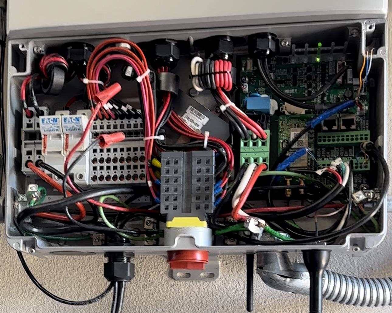

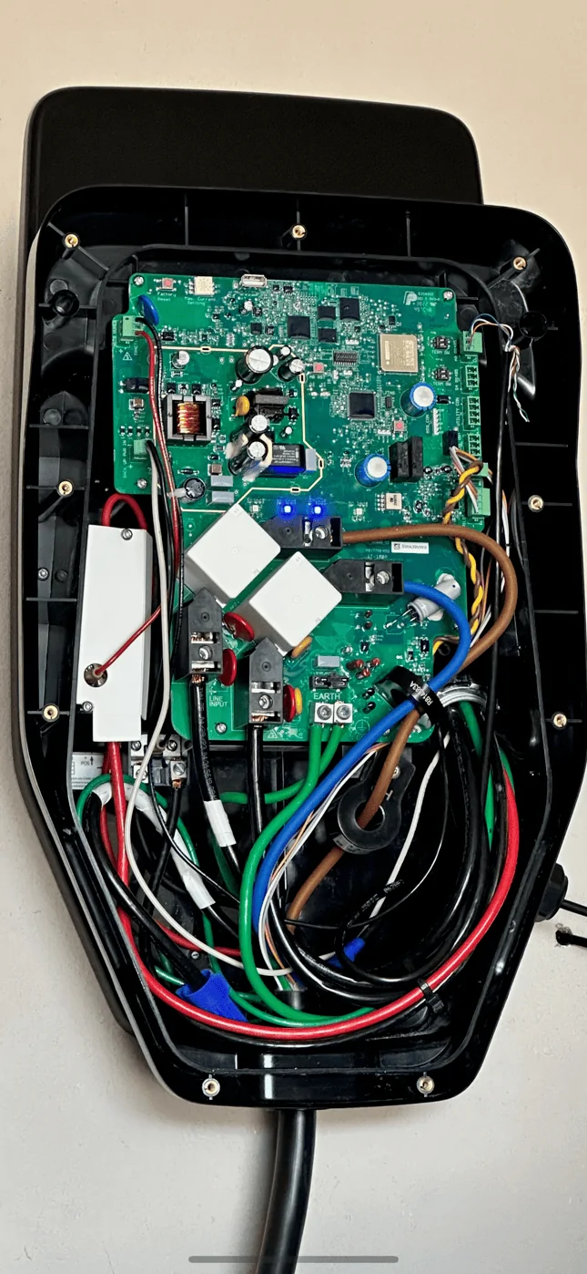

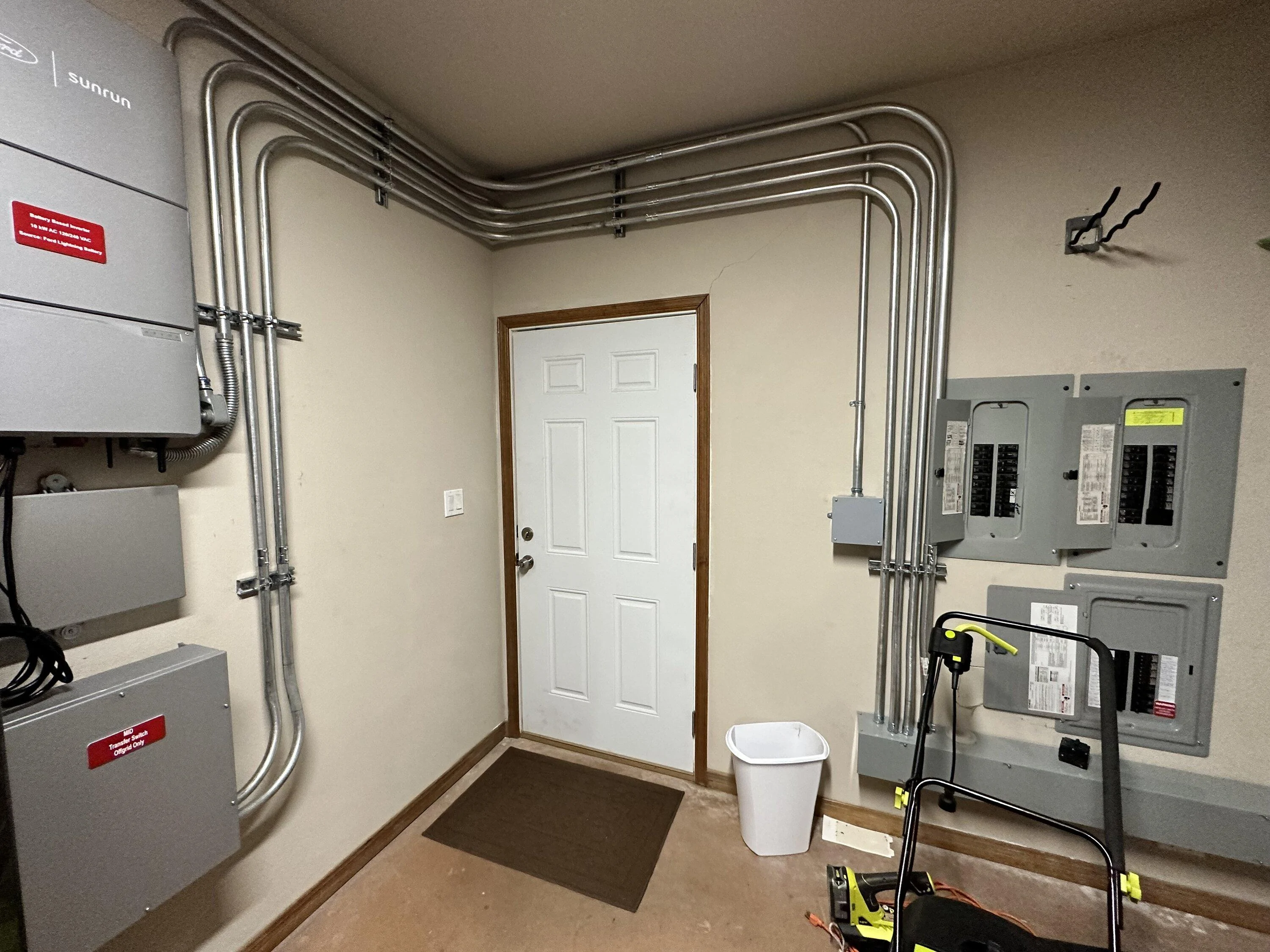

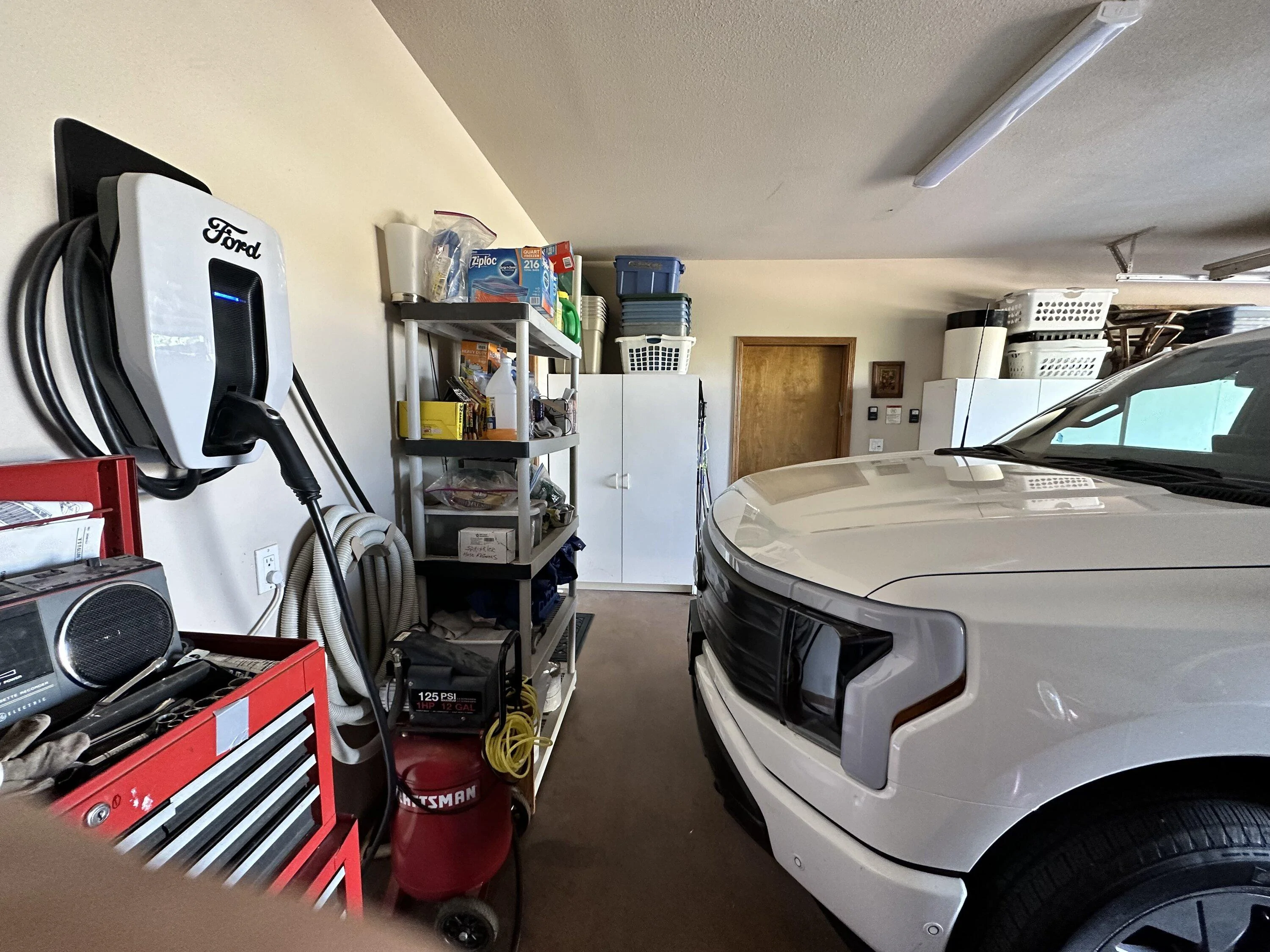

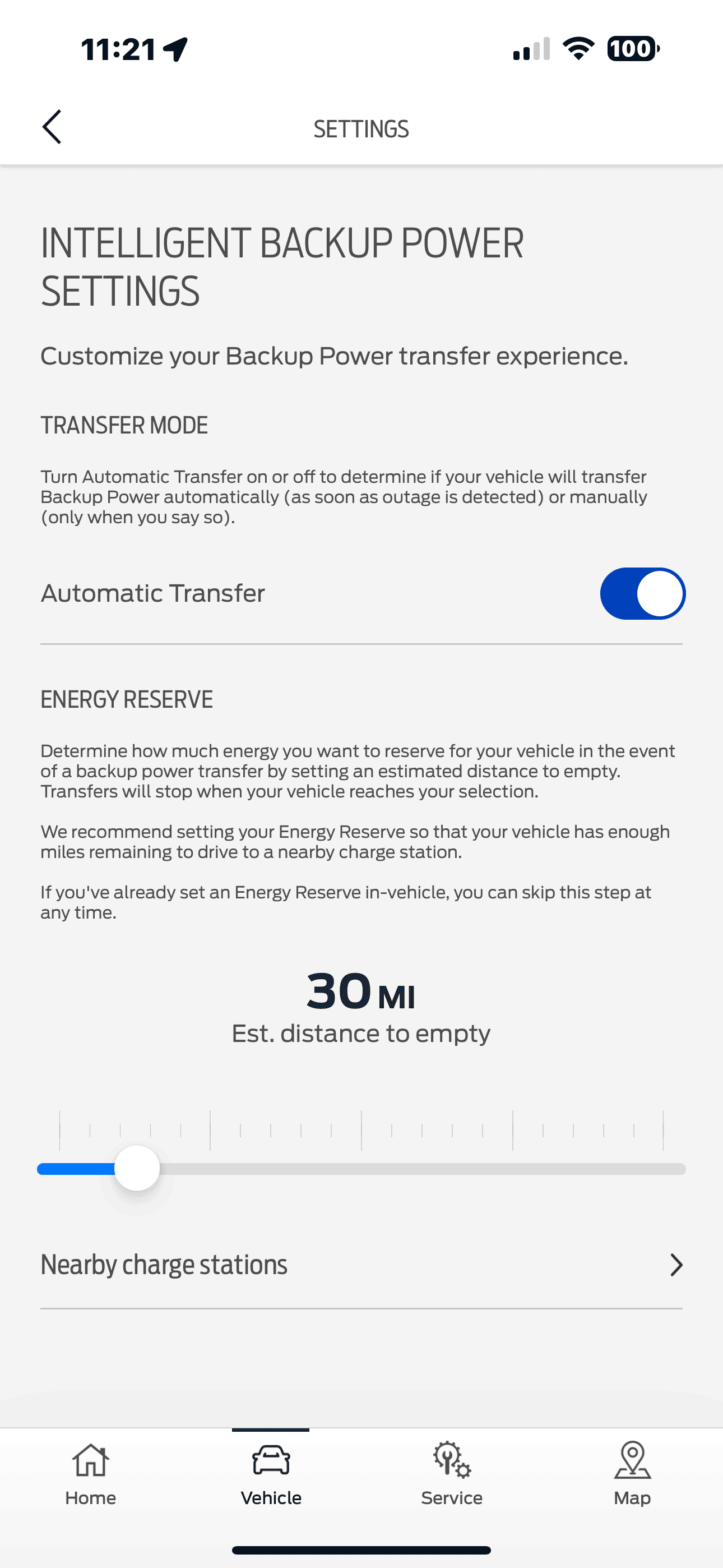

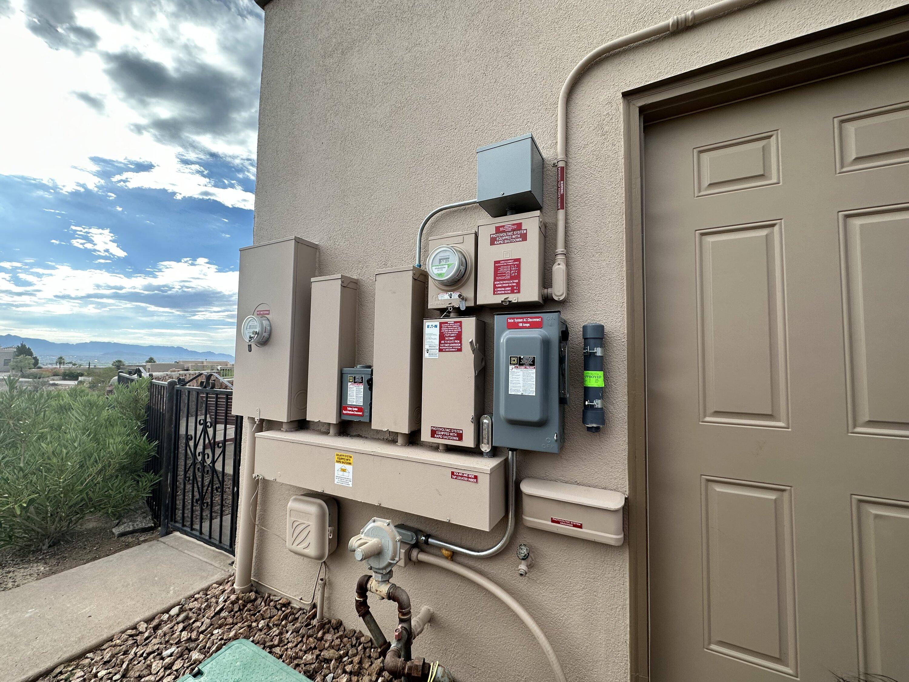

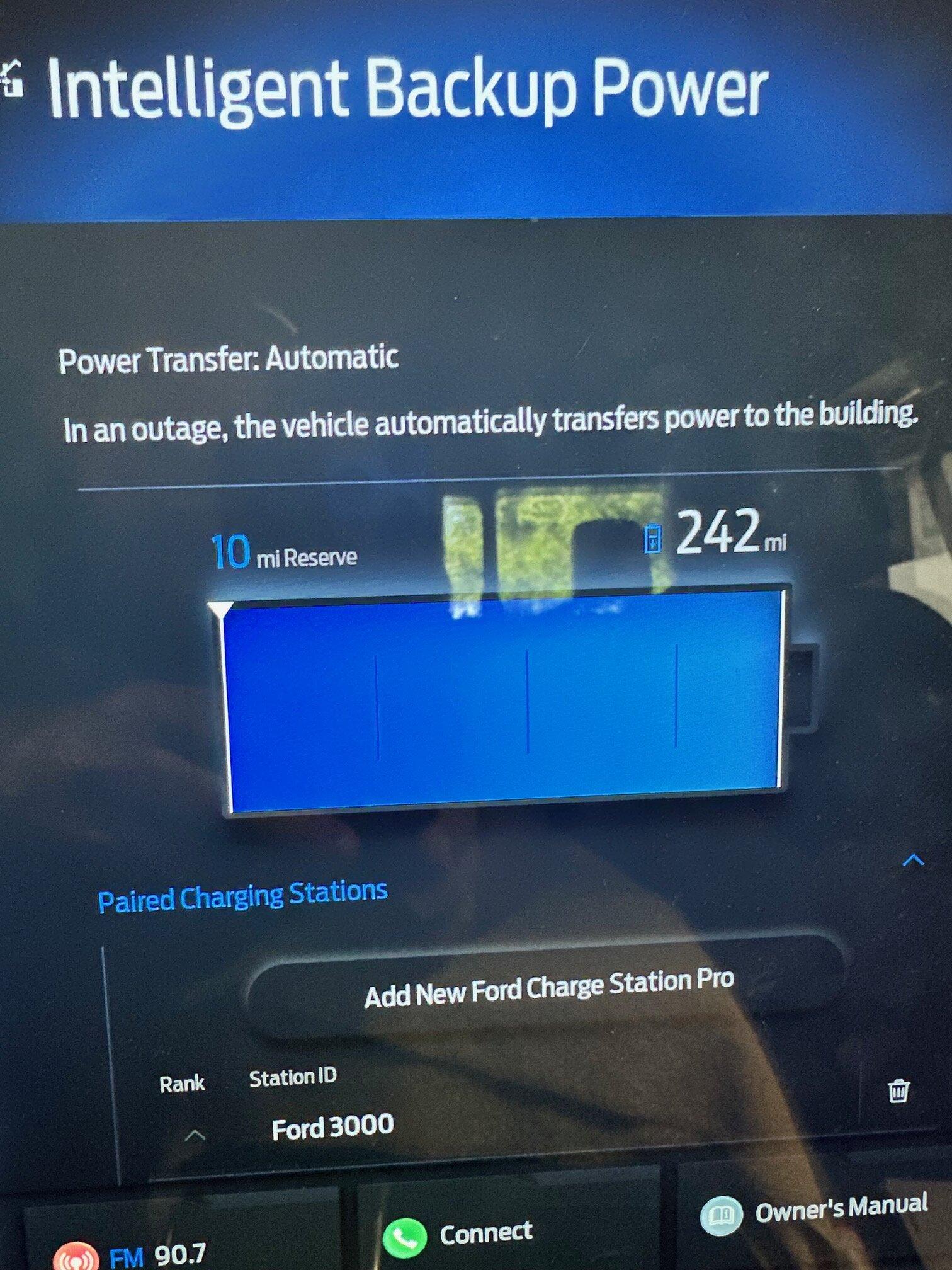

This is Steven in las Cruces NM and my system will not work as well. I had a solar contractor finish installing the HIS about 2 weeks ago and AC Couple to about 5k of existing solar. It seems like the only way to use the system at this point is to install a battery and connect it directly to the BDI E10 inverter until I can get the Lightning to power the home.
At this point we have done and rechecked all wiring. We Commissioned our BDI E10 Inverter, registered the Charge Station Pro, and paired the Lightning App, the Charge Station Pro and my phone Ford pass App. It was not easy to get this far since the signal was intermittent at best. We have had conversations with Ford, Sunrun, and Delta and were told that a new software update maybe coming in the future to seemingly solve the problems we did have and also have now getting the system to operate.
Nothing in the information I received told me that the charger should go by the right rear door because of communication problems or I might of been able to make that happen prior to spending the money to place it in front of the vehicle.
Currently I have two cases in play with Ford waiting for a reply:
1. To get the HIS system functional.
2. To get the Ford Charge Station Pro to put out the 19.2 KWH it is advertised to do. I currently only puts out a maximum 10KWH. Yes, the dial is set on 7 within the unit (80 amps) and I have discharged the vehicle down to 22% before plugging it in. It seems like I might get a new charger but am waiting for a reply on that happening.
I am a little discouraged by the fact that this system has been out since 2022 and a fix has not been forwarded. I had heard that the software upgrade on Bluetooth power was to happen in July and then pushed to September and maybe beyond.
Im wondering if the problem is that there are so few of us that have bought the HIS and it's not a priority currently. My serial number on my Inverter is below a 100 and I got the equipment in June.
I am posting my pictures that I have if anyone has advice. The one thought I had is there a way for us to boast the communication of the bluetooth. Antennas, wire, repeater, etc???
