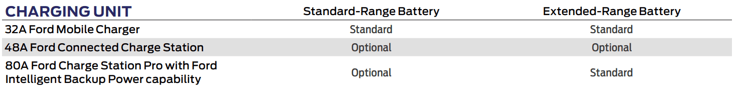

This shows in Ford's material that the charger was included, wonder who yo contact regarding that. Don't get me wrong...I'm extremely grateful for the price match for us extenders, but curious if the consider that part of this?
