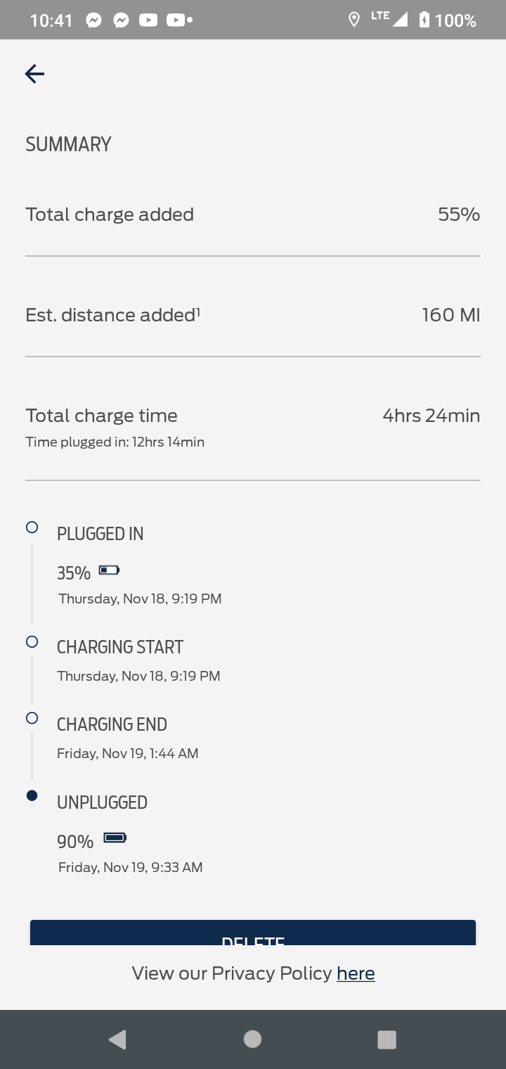

With regard to your MME data, is that data reported by the car or by your charger? My Tesla claims I'm getting around 4mi/kwh too, but my ChargePoint data says otherwise. It's still far cheaper than fueling an equivalent gas car, of course, and the driving dynamics/power delivery are obviously vastly superior. I get why they report the way they do, but it's nowhere near a complete picture of the energy usage.
For your F150 spreadsheet, how many hours would someone needing 500 kwh from a public charger need to sit at the charger? That's a very real part of the cost/benefit equation.
When using ChargePoint (at home or at work), kWh reported by the car app are about 10% lower than those reported by the charger. That's for longer sessions. Very short sessions are less efficient.
Right now zero hours for me. Have only charged at home/work/retail sites. Next week I'll be traveling about 400 miles to CA. In the past that trip took me about 7 hours total with stops for gas/food/leg stretching. Will have to see what it actually takes with charging stops.
